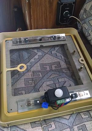

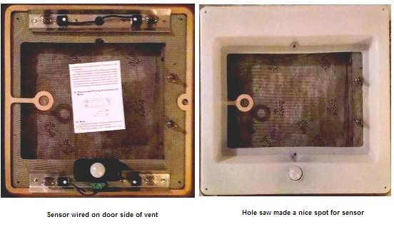

The first one, the slimmest and without light detection (figured it wasn't needed in the bath, since I always wanted the light to come on) was the black one. Last night I wired it up, and even drilled a matching hole for the sensor ball:
Without and with light cover
But -- when I tested it using a Radio Shack instant adapter 12v plug, it just stayed on and never turned off, even if covered. Durn! And I had drilled the hole for it too. Test rig below:
Testing the sensor
Testing the sensor
So I ended up having to fall back on the larger white sensor, which worked perfectly right off the bat. I did have to bend down the light reflector inside a bit to make room, and also make the hole larger since now the ball had to be in the middle. Still looks good, though, since this sensor had a nice white decorative top.

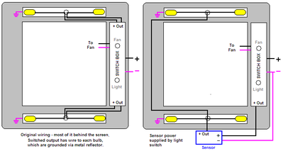

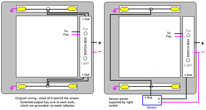

Btw, here's the before and after wiring diagram, to show how simple it was. This is the view after you remove the vent switch/light assembly and lay it down with the lights facing up. The bottom is nearest the door.
Cut the wires from the switch box going to each bulb, then tie all the bulbs together to the sensor output, and power the sensor from one of the switch's original bulb wires.
Motion Detect Wiring
Of course, if you didn't want the switch to power the sensor as I did, you could go even simpler and wire the sensor in parallel instead (so that EITHER the switch or sensor provides power to the lights). Then you'd only need the +/- power wires to the sensor, and have the output tap into any bulb wire (since they must all be tied together back at the switch output hidden inside the switch box). But then you couldn't turn force the light off except by cutting all house power.
