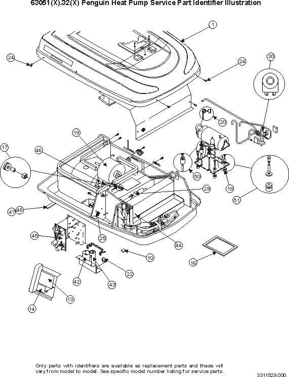

Here's the reply I got from domestic customer service:
"Below is the parts list for your review. Please call Dometic at 800-544-4881 to place an order.
Service parts for A/C H/P QS S-WHT
Model #: 630515.321
Product #: 991760360
Model #: 630515.321
*Click the line for item inquiry. Click to see kit contents.
ID Service Part Description MSRP*
1 3308046.006 KIT,SVC SHROUD PENGUIN SW $89.76
10 3100587.009 NO LONGER AVAILABLE
14 3310735.000 KIT, SVC WARNING DECAL $0.91
16 3310718.006 KIT, SVC ROOF GASKET $19.00
17 3310725.001 KIT, SVC MOTOR PARTS $6.77
18 3100238.207 GROMMET,COMPRESSOR MTG $1.11
19 3108706.924 KIT,SVC MOTOR PENGUIN $134.36
20 3312301.009 KIT, SVC OVERLOAD PROTECTOR $16.56
22 3310731.009 KIT, SVC PTCR $14.88
24 3310724.004 KIT, SVC SHROUD SCREW $3.07
25 3310732.007 KIT, SVC AMBIENT SENSOR $17.31
29 3310378.000 KIT, SVC WHEEL EVAP BLWR $27.55
30 3310714.005 KIT, SVC SOLENOID COIL HARNESS $35.19
42 3313107.028 KIT, SVC CAPACITOR 20/10 MFD $35.63
42 3100248.073 CAPACITOR 57115/600315.304/D $40.75
43 3100236.235 CAPACITOR,START 47-56/250V $14.41
44 3312303.005 KIT, SVC THERMISTOR WIRE HRNSS $16.51
45 3311557.000 KIT, SVC BOARD CCC $123.06
46 3310180.000 KIT, SVC CONDENSER BLOWR WHEEL $34.96
47 3313107.021 KIT, SVC ROOF GASKET $2.27
48 3313107.101 KIT, SVC ROOF GASKET $1.63
50 3311596.000 KIT, SVC HARDWARE COMP MTG $11.16
51 3311597.000 KIT, SVC HDWRE COMP PLATE MTG $8.83

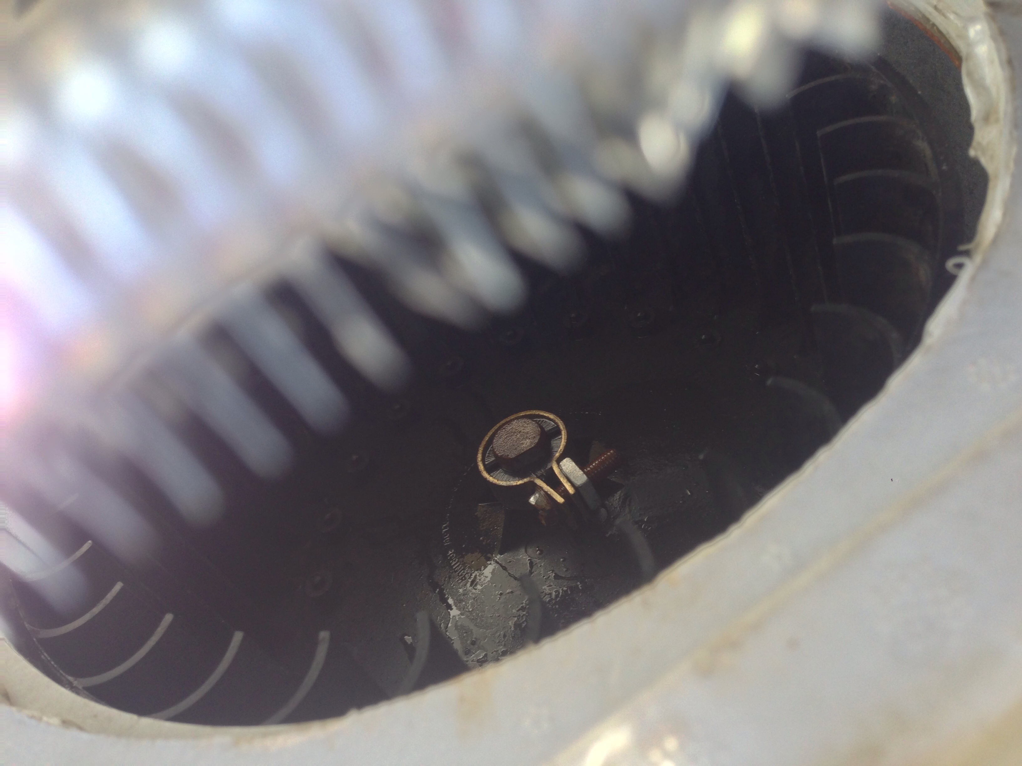

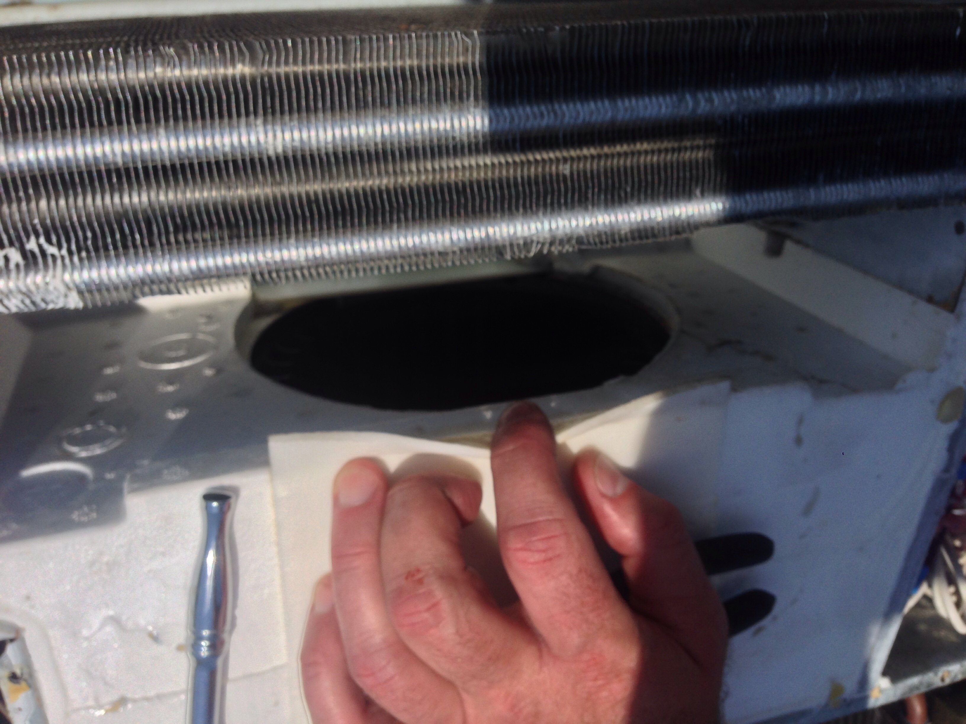

Let me start with this repair is a b!tch. Instructions are less than ideal, but reasonable. The screw/bolt to remove the condenser side (plastic) wheel sucks..
Tools not mentioned in the instructions but required in my case. Tiny pair of vice grips a hammer and maybe some gear puller. I still haven't gotten the metal wheel off. Going to buy a dremel later to hopefully get it off the shaft.
