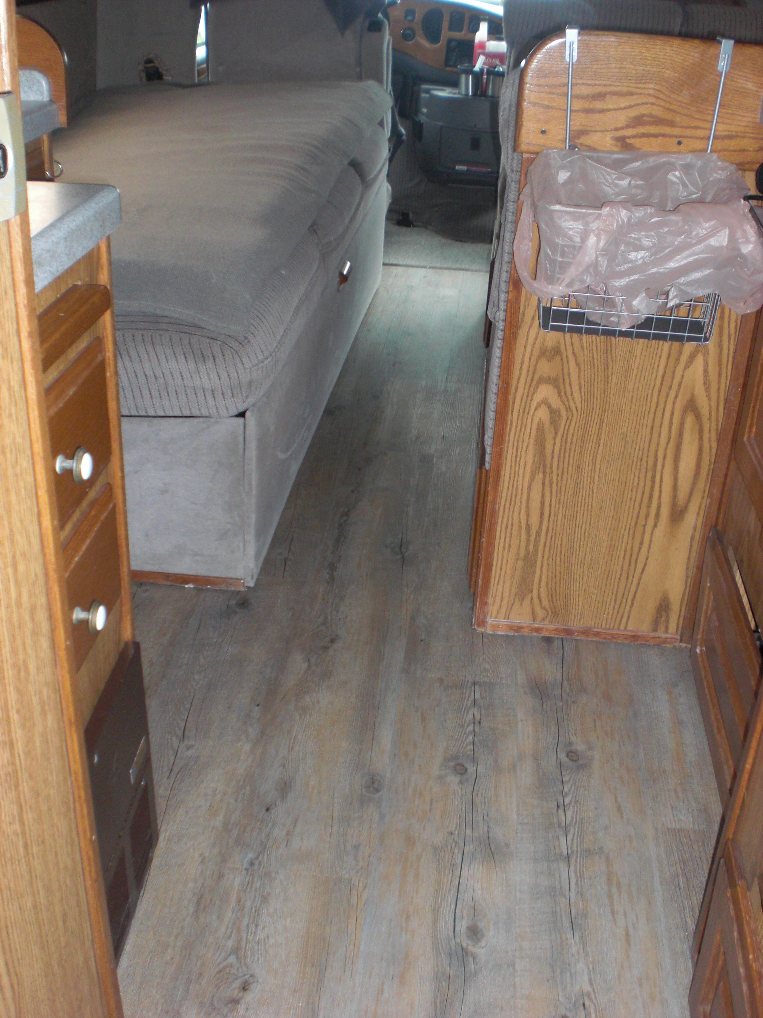

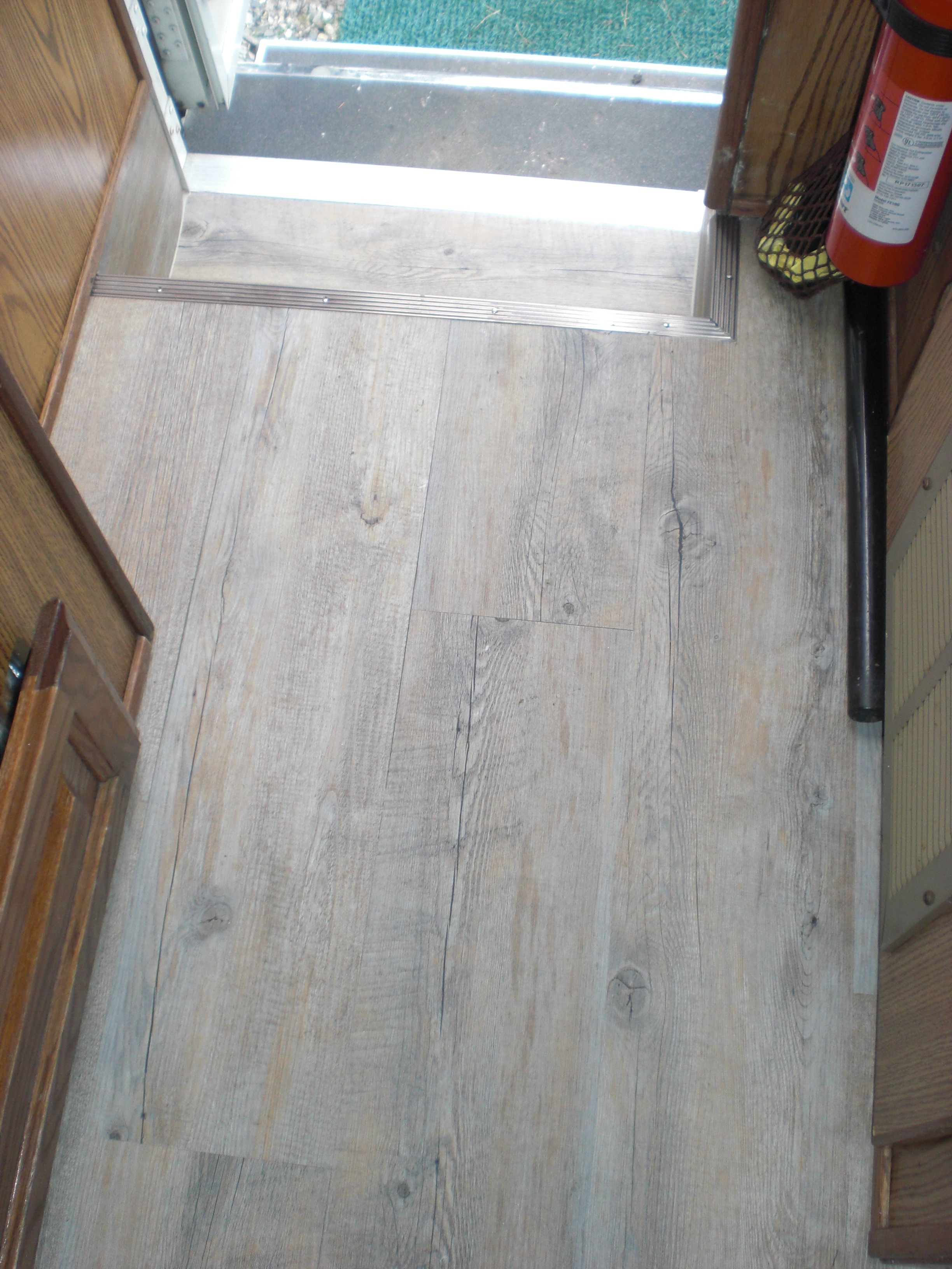

Recently had vinyl plank flooring professionally installed in the living area of my dinette model Concourse. I'm really pleased with it, the gray picks up the corian and the gold hilights pickup the cabinets very nicely, and it's light and bright. It is Ezfit in the Earl Grey color, http://ezlayflooring.com/ezfit-vinyl-flooring/

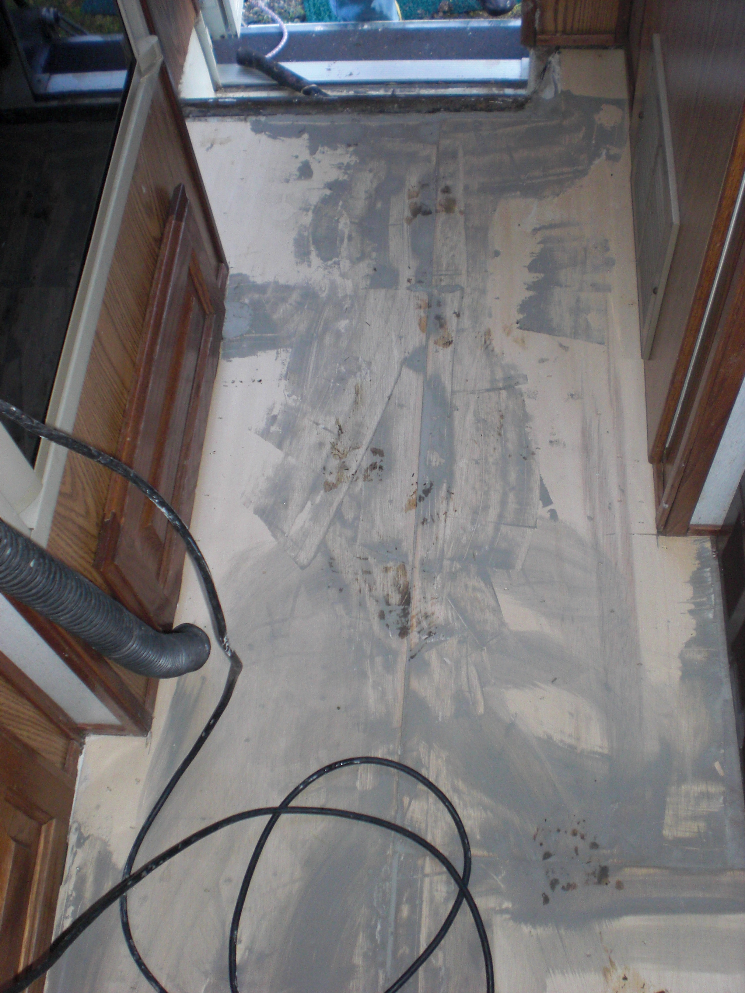

Some history, the original carpet was removed long ago and replaced with cork, which I did like for the sound deadening and look. But, it was a poor install and the tiles edges had shrunk and curled. The installer stripped that out and added ¼ inch plywood as underlayment (in photo below), so that the planks slipped right under the existing base trim. The base was removed and reinstalled when the cork was laid, so don’t know if it had been put back at the original height tho. The carpeting was left under the sofa and in the cabinets, and in the cab area in both installs.
There are bolts sticking up out of the floor that he notched the plywood around and filled the voids, 2 in front of the sofa, 2 behind the driver and passenger seats and 1 under the dinette table. The bolts are longer than the plywood and he did not want to grind them so he also notched the underside of the flooring. It is a floating type floor, but he glued down both the underlayment and planks due to the flexing when underway. He also commented that he did not like the caulk on the rear step, that it turned out too light and that he'll be back to change it to a less-contrasty color.
The void in front of the rear step threshold is covered by a plank that is flush with and tight to the threshold so there must be something solid under that edge but don't know if it needed underlayment or the gap filled. Last year my step got very wet when it rained, re-caulking around the hatch behind the spare tire stopped that leak. On that note, it seems that the dicor tape or whatever the hatch frames were originally set with is failing after 12-15 years. Have had to caulk around the rear hatch, the battery/storage hatch and the refer hatch including the joint between the hatch frame and the hatch floor. Thankfully none of the leaks were long enough to damage under the flooring so no reconstruction needed.

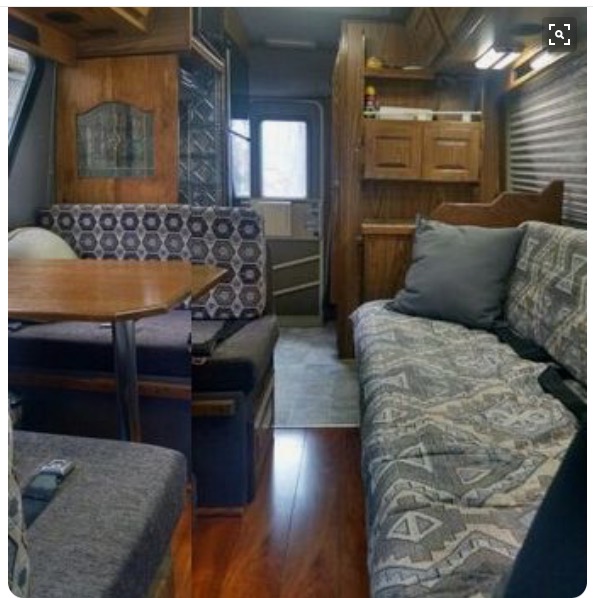

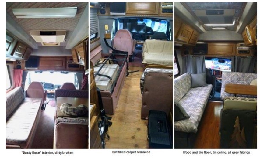

When I got rid of my decades old sand filled carpet, I wanted to divide the cabin into three spaces: carpet for the cockpit, wood for the living area, and stone look vinyl for the kitchen / bath section.
composite pic of wood and tile
Interestingly, the sound/thermal barrier underlayer cost more than the wood and vinyl combined. The wood was about $40, the vinyl a lucky Lowes scrap piece for $8, and the underlayment about $50. Add in two aluminum transition strips between the front and rear of the wood, plus some trim, and total parts was around $150.
The labor was all mine, and done after work and dinner. Removing the carpet was the hardest part and took a few days. Laying the wood and tile took only a couple of slow evenings. My 13 year old daughter helped laying the wood.
carpet removal, new wood

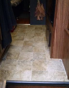

THE VINYL TILE:
The vinyl tile sheet that I used first, was a much lighter color, almost white marble. But that really showed dirt when you walked in, so out it came and in went a slightly darker grey/brown called Pompano stone from Lowes. A side benefit of laying it twice is that I was able to use the first sheet as a template to do a much better outside pre-cut of the second version, which then fit almost perfectly right away, also requiring less wood trim.
Side story: At first I couldn't find this pattern in stock at any of several Lowes I went to. Finally at one store a part-timer said, let's check the remnants, which were hidden off to the side. There he found a piece and sadly said he was sorry, but it's only 4 feet long by 12 feet wide. Ha! But looking at it sideways, four feet wide by eight feet long is all I needed, so it was perfect! And only $8 as a remnant. Score!

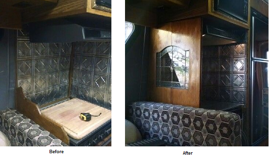

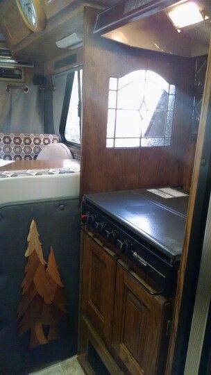

Thanks for noticing! Yeah, we actually love separating the kitchen from the sofa/dinette section. I plan to add some kind of wrought iron scrollwork perhaps on the sink side, as well.
For the stove side, I bought a beveled and frosted glass pane from eBay for about $35. Then I got a 1" wood sheet and used a router to round off the sides, and to cut a groove inside that holds the glass pane perfectly.
The biggest surprise while doing this, was finding out how much the walls curve in as you go up on that side. I had to cut much more of a curve in the wall-facing board that I had imagined it would take. I think it came in almost 2" from bottom to top.
I then took apart the existing low factory divider, and used its trim pieces to help place the new partition. It looks pretty nice (although I still want to add some trim around the glass), and I think it makes the stove area feel safer too :)
