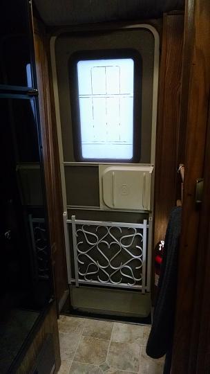

For myself, I made the main see-through "stripes" match the ones running horizontally across the door, and then added a vertical up and over loop matching the top door shape. This prevents people from easily seeing in from pedestrian level, but from the inside and higher we can easily see out from the increased open lines at the top.

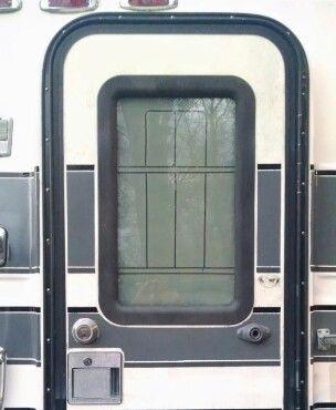

Since we can only include three images at a time, here is a direct shot, showing what NOT to do -- don't rush and make non-straight vertical mask lines, or peel them off too soon:
Woof. Even posting that, I'm embarassed. Oh well, it was good practice, and it can serve as a warning to others ;)
