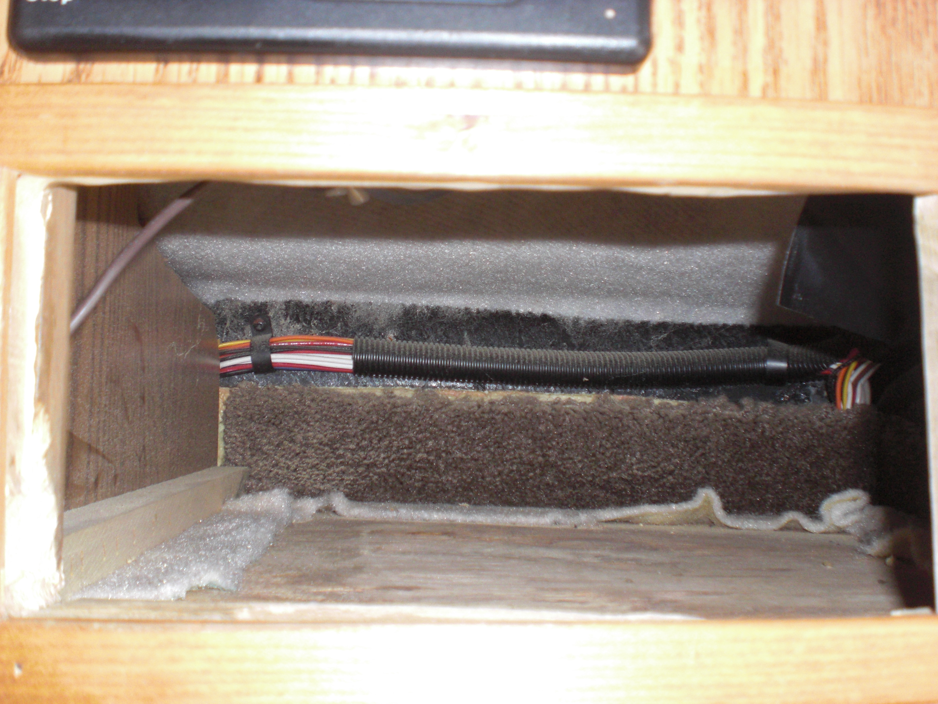

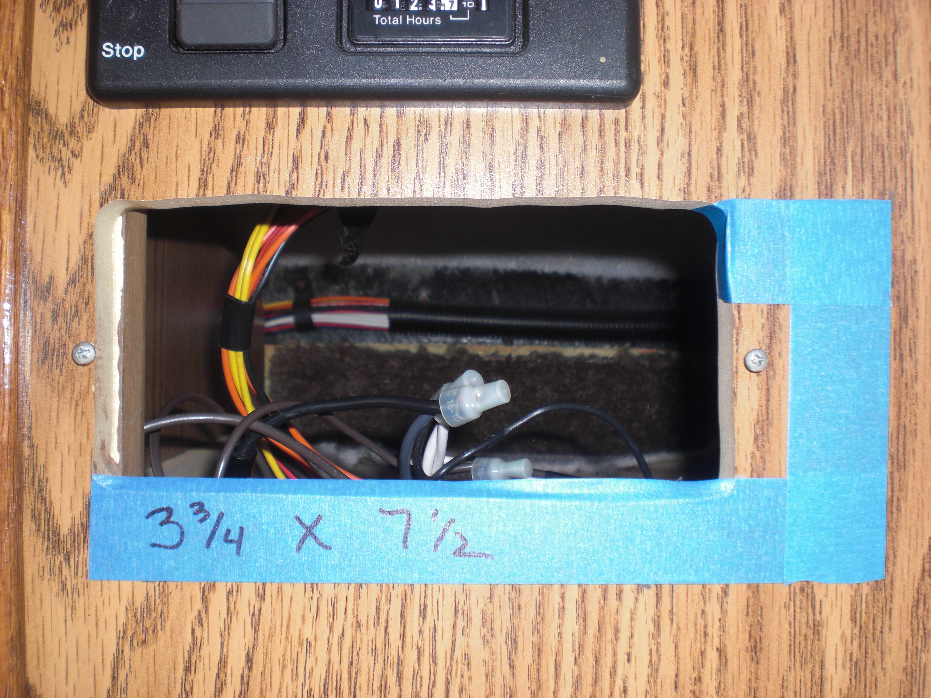

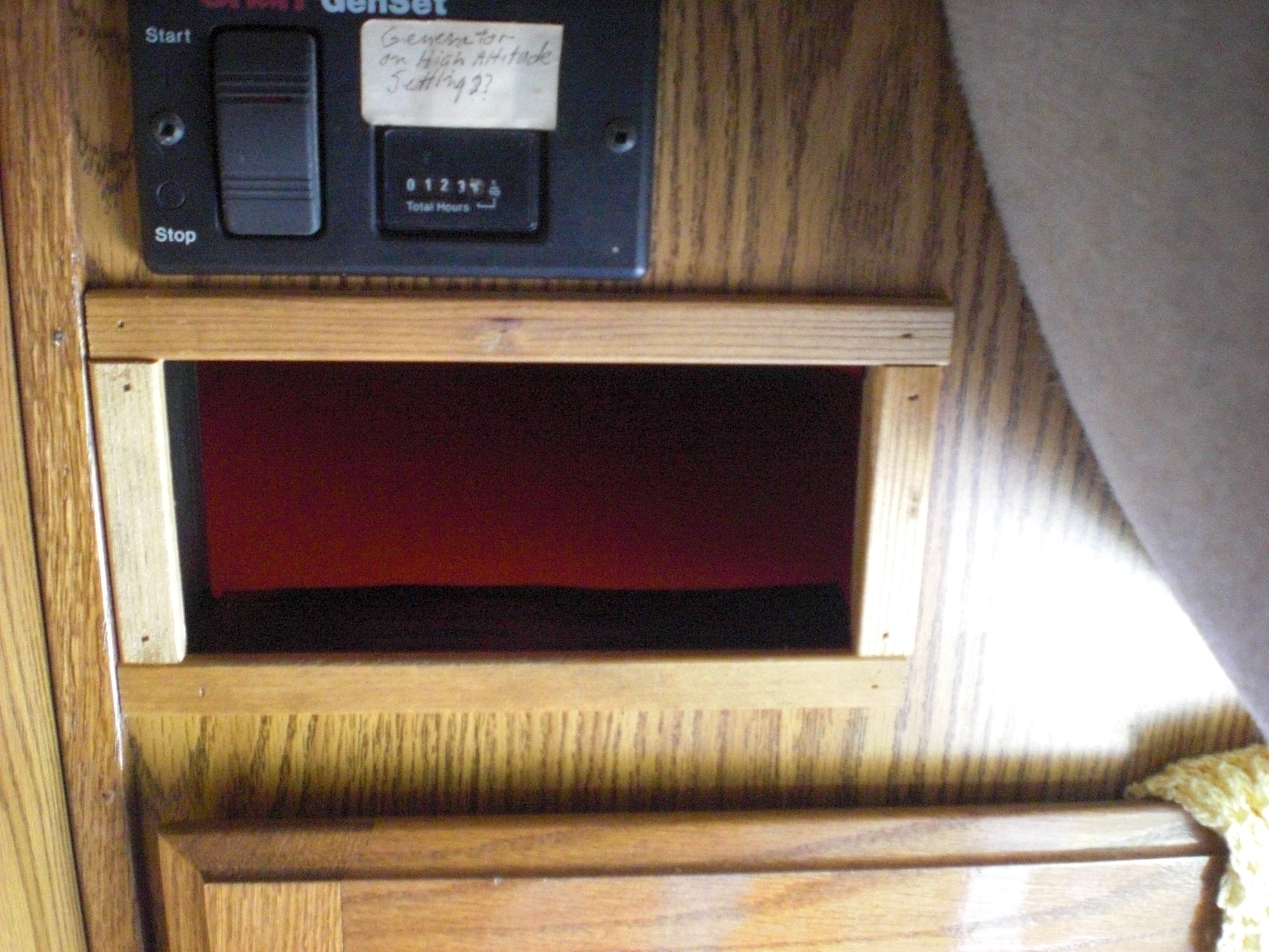

I've completed the conversion of the CO detector space into a great little storage cubby, still in the mock-up stage. I had it in for service and asked them to enlarge the opening and tie up the wires, and they also added the trim around. I'd intended to use neoprene and secure the liner with a nicer trim, but left the trim in place and taped the liner to the opening to see how I liked it. This liner is foam sheets and gorilla tape, about 12x12 and 4" high. Many Thanks to Blue for the suggestion a while ago, it is a really useful space now for fairly soft and light items like hats, gloves and shopping bags.

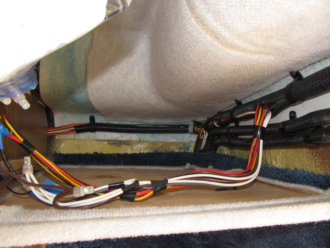

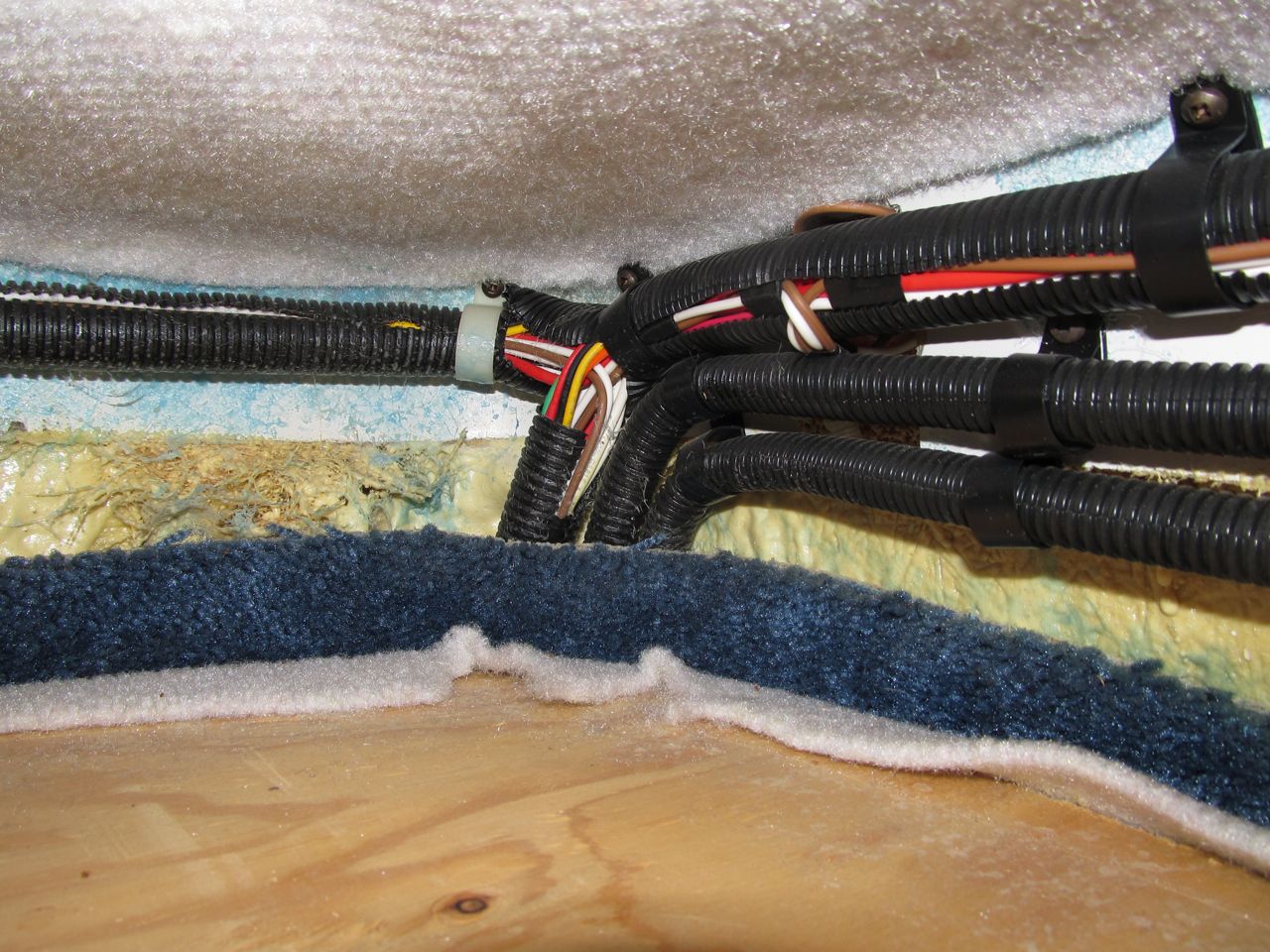

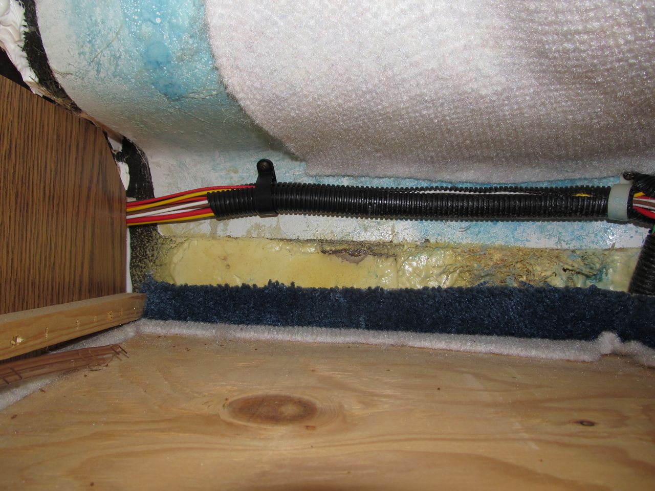

I thought that since you started this topic (good idea), I'd repeat the photos here that I posted in the "fridge removal" thread where someone asked about this space.
Here are photos of the area above the closet "ceiling" on mine (1999). This is with the front closet wall removed. The plywood "shelf" you see is the "ceiling" of the closet as-built. It is carpeted on the underside that faces the closet, and there is a perforated flange on the underside that serves as a closet "rod" (carpet is the white, marine hull liner type carpet they used in many places). This area housed only the generator start panel/hourmeter and the hard-wired CO monitor. Ignore the white "thing" on the left of the first photo; that is the gen start panel that I have in a bag that photobombed.
The rear/outboard corner is where most of the wiring goes up/down after coming "across the great divide" of the rear door. That's why you see so much loom there.
The wires that come across the front of the photo are the ones that "belong to" the above-closet area, and were p-clipped up near the ceiling (the actual ceiling/roof) behind the closet face. The multi-colored ones are all part of the generator start/hour-meter panel harness; the brown is for the closet light, and the grey is/was for the CO detector. The whites are ground wires that lead down to the chassis grounds.
1) "cutaway" overview without front panel on.
2) Same view, but shows detail of aft/outboard.
3) Same view, but shows detail of forward/outboard. The "wall" on the left is the wall that is common with the refrigerator compartment

Many thanks to both of you for the photos. I especially love that one with the original hole dimensions written on the painter's tape. Handy.

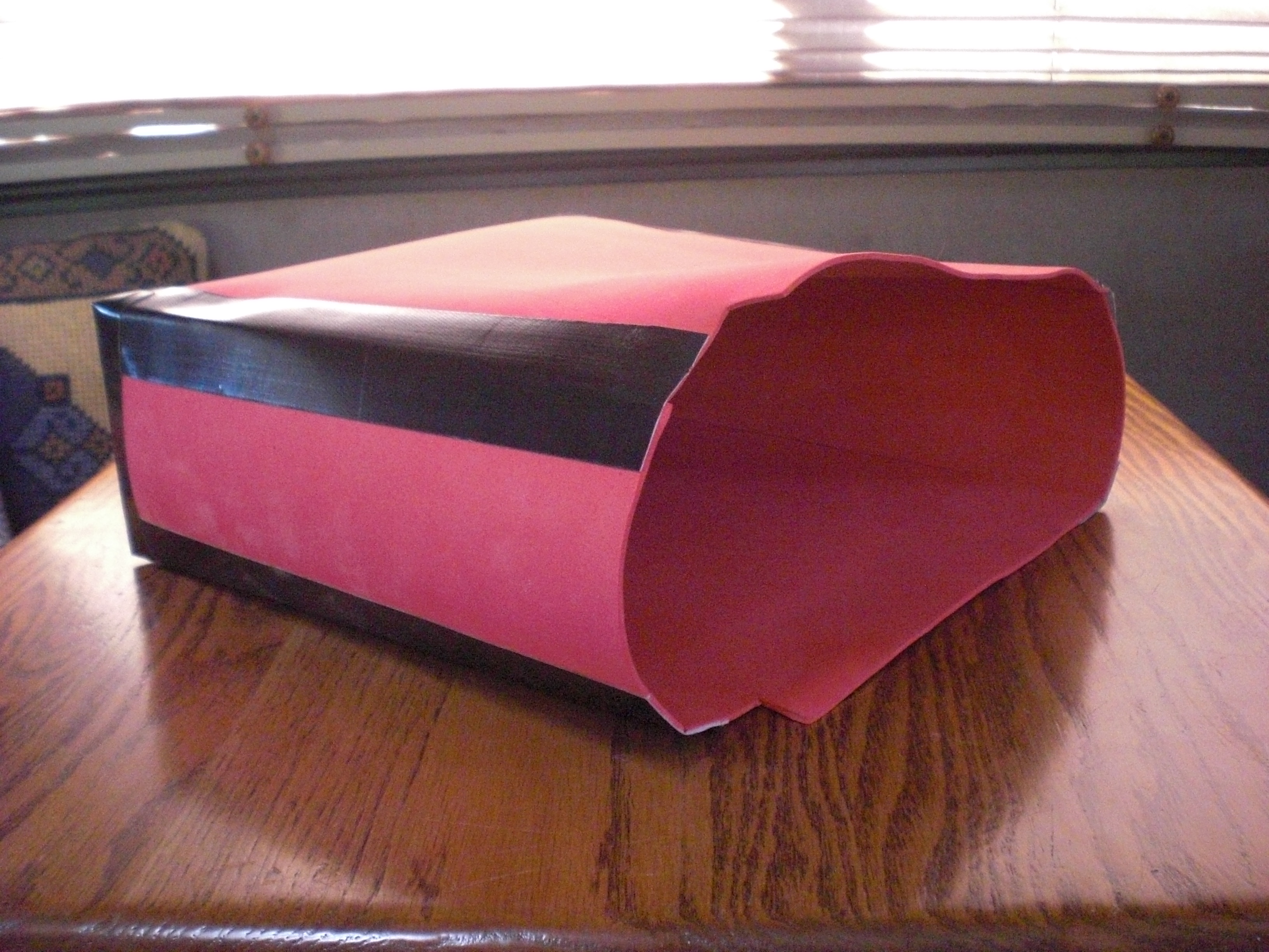

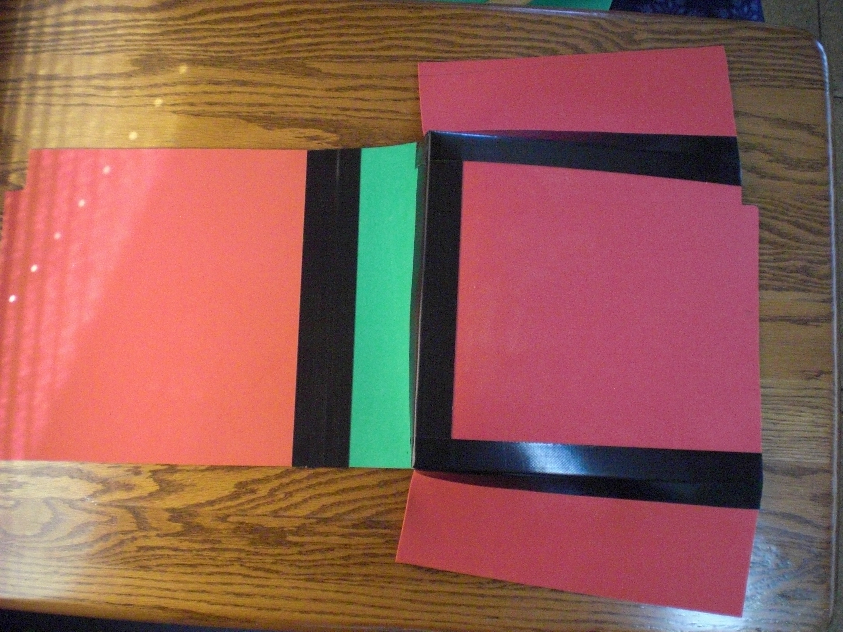

What is so great about Blue's original suggestion of using a flexible bag lining is that it can be larger than the opening to create more usable space than a rigid lining. I gained several inches in height and width with the foam liner.

construction of liner
