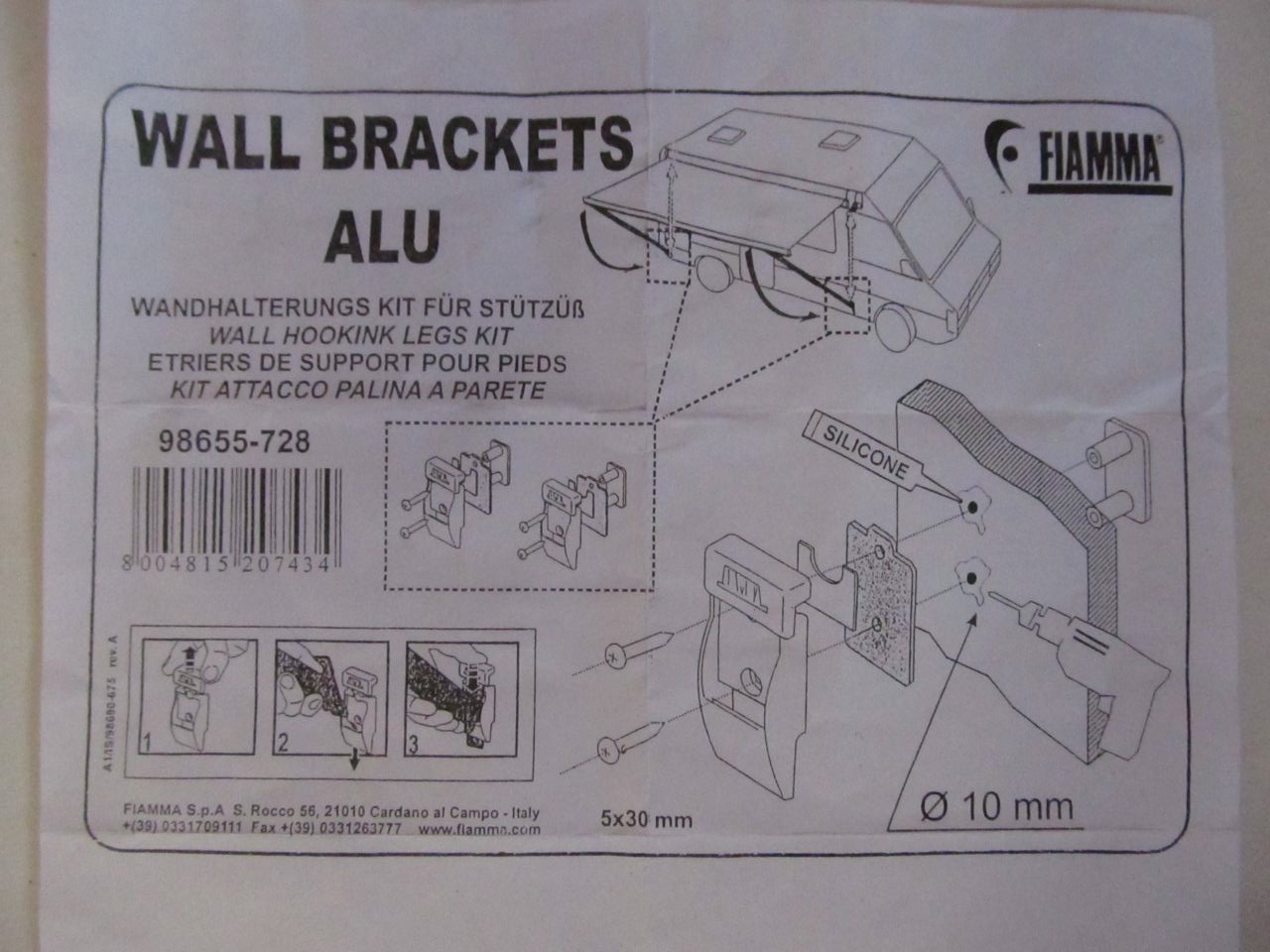

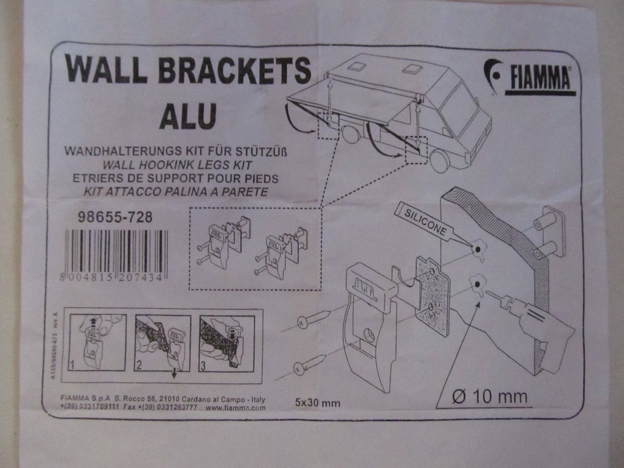

I found a newer (different exterior styling) replacement bracket, bought a pair, and installed them both (they don't match the original one in appearance, as they are streamlined and silver/metal, not squarish and white). These new brackets are Fiamma part number 98655-728. Here is a copy of the instructions, which also shows the part number:

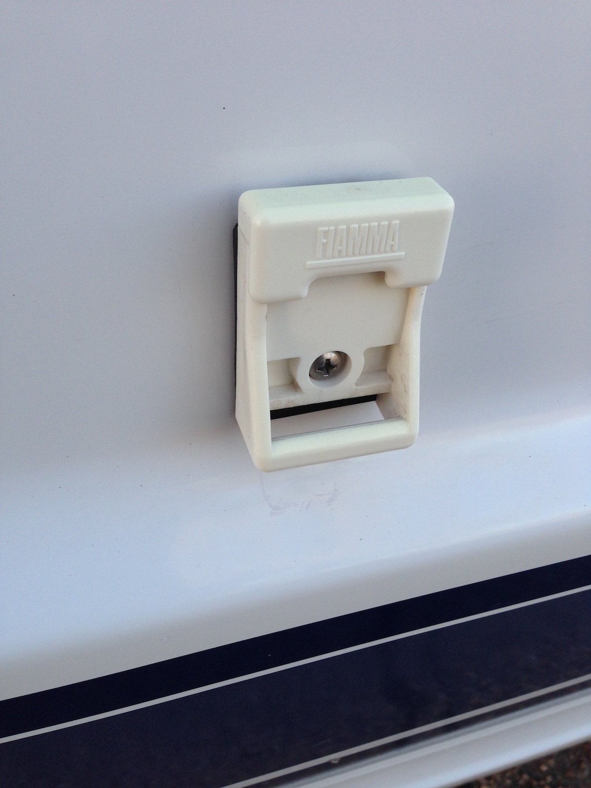

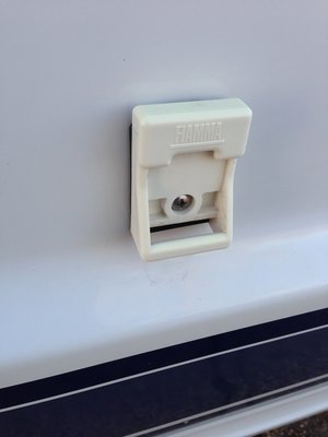

The original brackets on my rig (this is the non-broken one):
