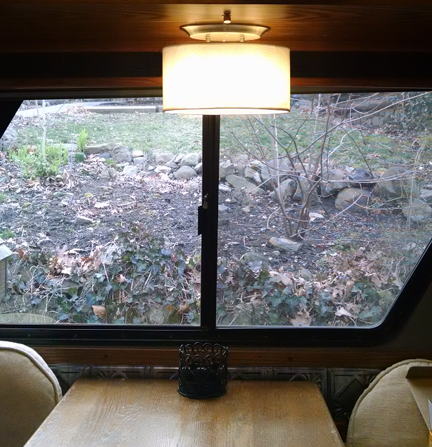

Okay, dinette lamp first.
It's a dual LED RV dinette lamp with fabric shade and brushed nickel body. Something like $25 off eBay.
I also drilled a hole and added a rotating 12V LED on/off + dimmer switch in front of it, so someone in the aisle or either dinette seat could infinitely adjust the brightness. About $29 off eBay.
I chose this lamp because it's short enough to not block the view from the sofa very much, and it's oblong so it doesn't stick out towards the aisle either. It really makes the cabin look a bit more domestic, which the wife likes :)
Again, the reason why it's offset to the right by about an inch off center, is because Trail Wagons put a one inch hole at the far right hand side for the original fluorescent light wires. The edge of the new lamp base just covers it. If only they had centered the hole a bit more. Some day I might just re-veneer the bottoms of the cabinets so I can move all the holes!

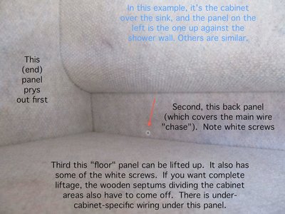

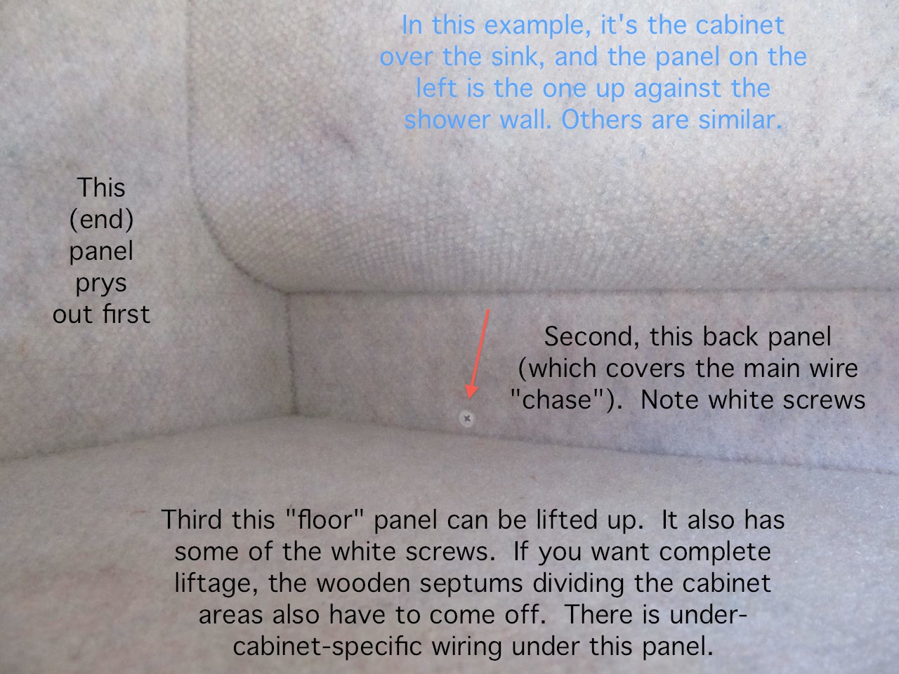

On the off center hole: If your upper cabinets were made anything like mine, it's not TOO bad to get to the wiring and I think maybe you could then put the lamp on center with the base just covering the off-center hole. Maybe you already know this and there is some reason it can't work... Or yours are different... But anyway, the way my upper cabinets work is this (going on memory here, so hope I have the order correct):
1) Pry out inner/end carpeted piece.
2) Pry out back (outside wall) carpeted piece.
3) Lift up bottom carpeted piece.
These all (except maybe for #1, I forget) have some white, washer headed Phillips screws holding them in place (I guess they don't make those in Robertson drive ;) ). They are all easily visible on my rig.
Behind #2 is all the wiring that runs fore-and-aft.

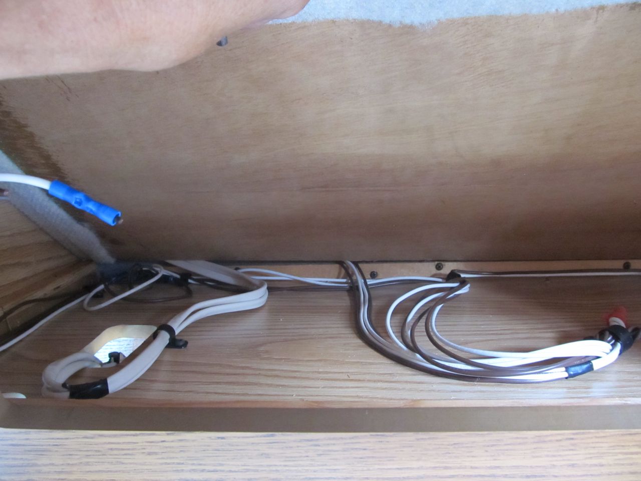

Under #3 is all the wiring for the "overhead" lights on the cabinet bottoms, the 110 outlets, etc. The false floor has a fair bit of space under it (because the speaker backs stick up some inches and they are under it - at least in the Concourse).
So - at least on my Chinook - if you had panel #3 lifted up (I prop it up with a screwdriver to work under it) you could just make a new, centered hole, and run the wire through it. I wonder if it's the same or similar on yours?
Edited to add a couple of photos:
This first one shows the basic idea of the various carpeted panels I described above. At least in a '99 Concourse. In this one we're looking into the cabinet over the kitchen sink. The "wall" on the left is the one that is common with the shower.
Here it is with the "floor piece" lifted up. The whites are the bundled (chassis) grounds. The 110 wiring is the Romex style wires; the others are DC. The bundle on the lower right is (although you can't see it very well) going out a small hole to the Thin Lite over the sink. There are multiple wires because it continues on to the other Thin Lite over the couch, etc.

Re: cabinet wiring. Those photos should be very helpful to newer model owners. In my '94 Chinook, the cabinet internal false bottoms are plain thin paneling. They're lifted up by removing a few black Philips screws around their edges, and then you can get to the wires the same as yours.

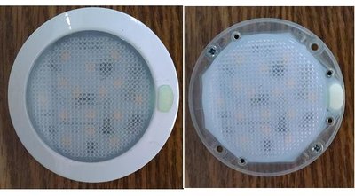

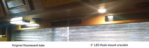

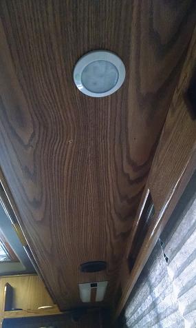

As for replacing other lamps, today my eBay package arrived with a $15 three inch flush mount multiple warm white LED light with glow-in-the-dark-on/off-button. I got the 3" because I figured I'd put one over each sofa section... three lights in total. I started with just one to check it out.
Even though I had ordered it, at first I did a double-take at its small size, like a kid's pancake. I was like, whoa! That's TINY. Maybe it'll be too dim. But what the heck, I removed the original 12" flourescent above the sofa, and mounted the new 3" LED disc over the wire hole. (I will have to put a little wood putty in the old light's screw holes to hide them.)
To my surprise, to me it's bright enough to replace the old light all by itself, no need for three. I like the way it's so small and thin (less than 1/2 inch thick) that it visually opens up the space above your head. Easier to find the switch and looks more modern, too. Here it is off and on.

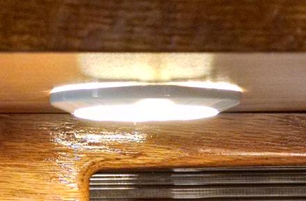

The round bezel snaps off so you can use screws to mount it to the underside of the cabinet (or ceiling), and then you snap the bezel back -- voila, no screws visible. Btw, the light flare in the photo makes it look rounder than it is. It's actually pretty thin and flat, as mentioned above.
I'll either get another for above the sink, or I might get a rectangular dual brightness version for the kitchen area. Undecided.

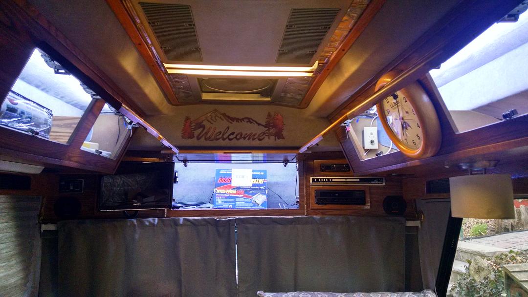

Oh! I forgot to take pictures of the LEDs I put in the roof fluorescent holders... along with wireless remote controls... so that I can turn them on/off from anywhere in the RV... and remotely dim them as well! This is here to remind me to post those tomorrow.

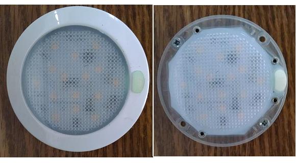

kdarling, I'm looking at doing the same style LED fixtures under the cabinets as well. Any product info on the one you got on ebay? Are you happy with the quality?
Re: Removing Fluorescent Light Fixtures
Hoosier, I got it from eBay seller "dollarled", aka http://www.12vonline.com/
Here's the bezel on and off. From the ad description, I had thought the button glowed from electricity, but instead it's just a rubbery glow-in-the-dark thingie that builds up a glow from the light. Which is okay with me, since that means it has no power draw for that.
The quality seems fine. More LEDs than I expected, that's for sure.
The only thing I'm not sure I like or not so far, is the slight light leak from the top that you can see from the side. But of course that could be easily cured with some electrical tape inside. Plus I might not have it screwed down tight enough.
EDIT: Today I've decided I don't like it, because it's TOO bright for me. I mean, glaringly bright if you sit under it. So I'd say you should get just one, like I did, and try it.
I'll keep it installed for when I need real light, but I think I'll go ahead and install the two dimmable reading lamps I've previously planned for each end of the sofa.
And/or I'll add a dimmer to it as well.
