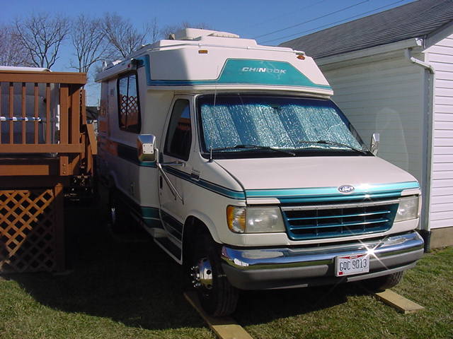

Does anyone know if, or more importantly where replacement "Chinook" lettering decals can be found. Mine on my 95 Concourse are badly faded, and I'm afraid can't be restored.

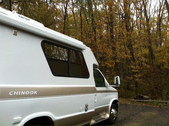

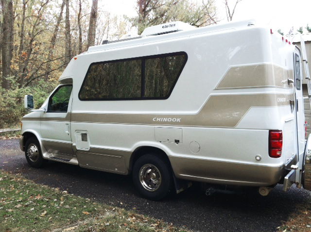

When I had my '01 Concourse painted (base coat/ clear coat) last fall, I replaced my "Chinook" graphic with decals made up by the body/paint department. I supplied them with vector-based artwork (Adobe Illustrator) of what I wanted. I updated the original Chinook logo somewhat, but it fits with the new stripe graphics I also designed (IMHO). You should be able to provide any local sign shop with artwork and they will fix you up with the right vinyl decal. Most have the capability to create the art as well. A "vehicle wrap" shop would also be a source and could provide the application. Good luck!

This has already been alluded to in the above responses, but the Premier and the Concourse are two completely different beasts when it comes to the graphics. So any repair/upgrade/etc. would need to take that into account.
1) Premier
White background is a molded gelcoat. Graphics are vinyl applied "stickers." When these fail it's faded/cracked vinyl, which you can remove and then reapply new ones.
2) Concourse
White background is a molded gelcoat. Graphics are painted on (mine uses two GM paint colors, for which the code was put in the doorjamb area by Chinook), and then clearcoated over. When these fail, it's typically the clearcoat that has a problem (although eventually then the paint could too). Options for repair include possibly re-clearcoating, or completely re-painting, or something else. But not just "re-stickering."
1) Premier
2) Concourse

I read a lot of comments from others that have used this method, and they had nothing but good remarks. I think that I'll do a section and see how that comes out. The worst place is on the front overhead, above the windshield, which is understandable. So that's probably the section that I'll do, it includes the "Chinook" lettering which I'll probably mask off and spray paint before applying the sealer. I'll take some pictures of the process.

That's pretty much the same for me SMan. Blue said that the lettering on my Concourse should be painted on, so I think that I'm going to mask the letters off and spray paint them then sealing the whole area.
