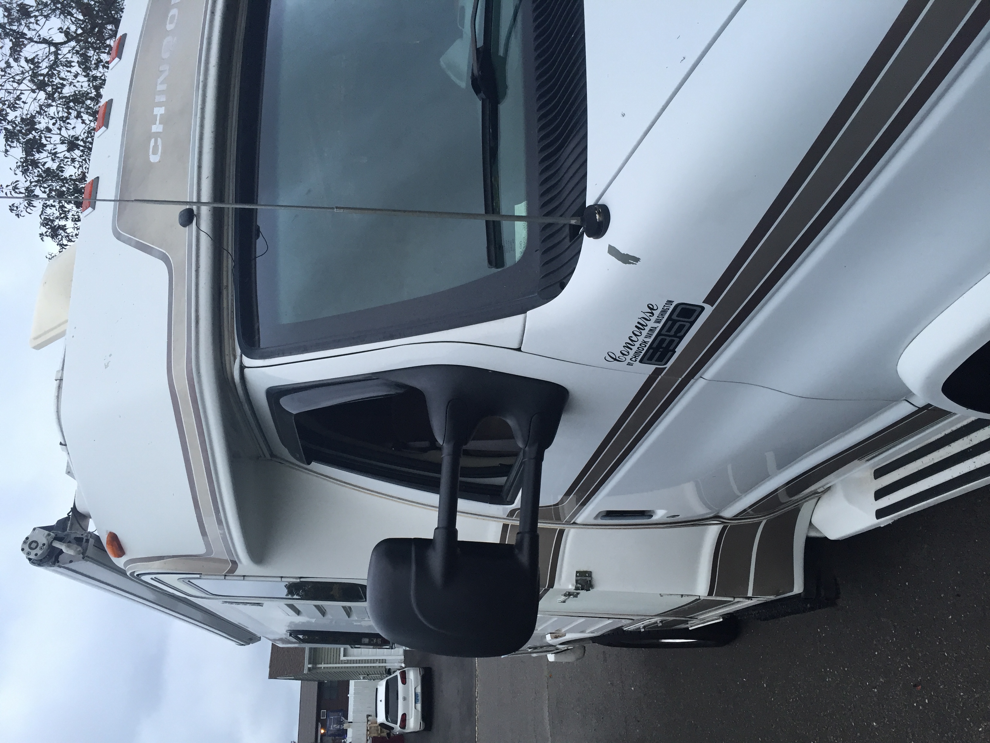

My biggest complaint about my cross country trip home was the mirrors! Besides being faded and yellowing, they didn't stay out. At highway speeds they would slowly fold in and I would have to always be adjusting them. So first thing I ordered was a set of later E350 power towing mirrors.
Reading online I thought it was going to be a easy swap. Turned out it was a little more involved but not bad at all. I had to drill two new holes and open up the existing holes with a step drill bit.
Overall I'm very happy with the outcome, should look better once I do my 08+ front end swap with black grill.

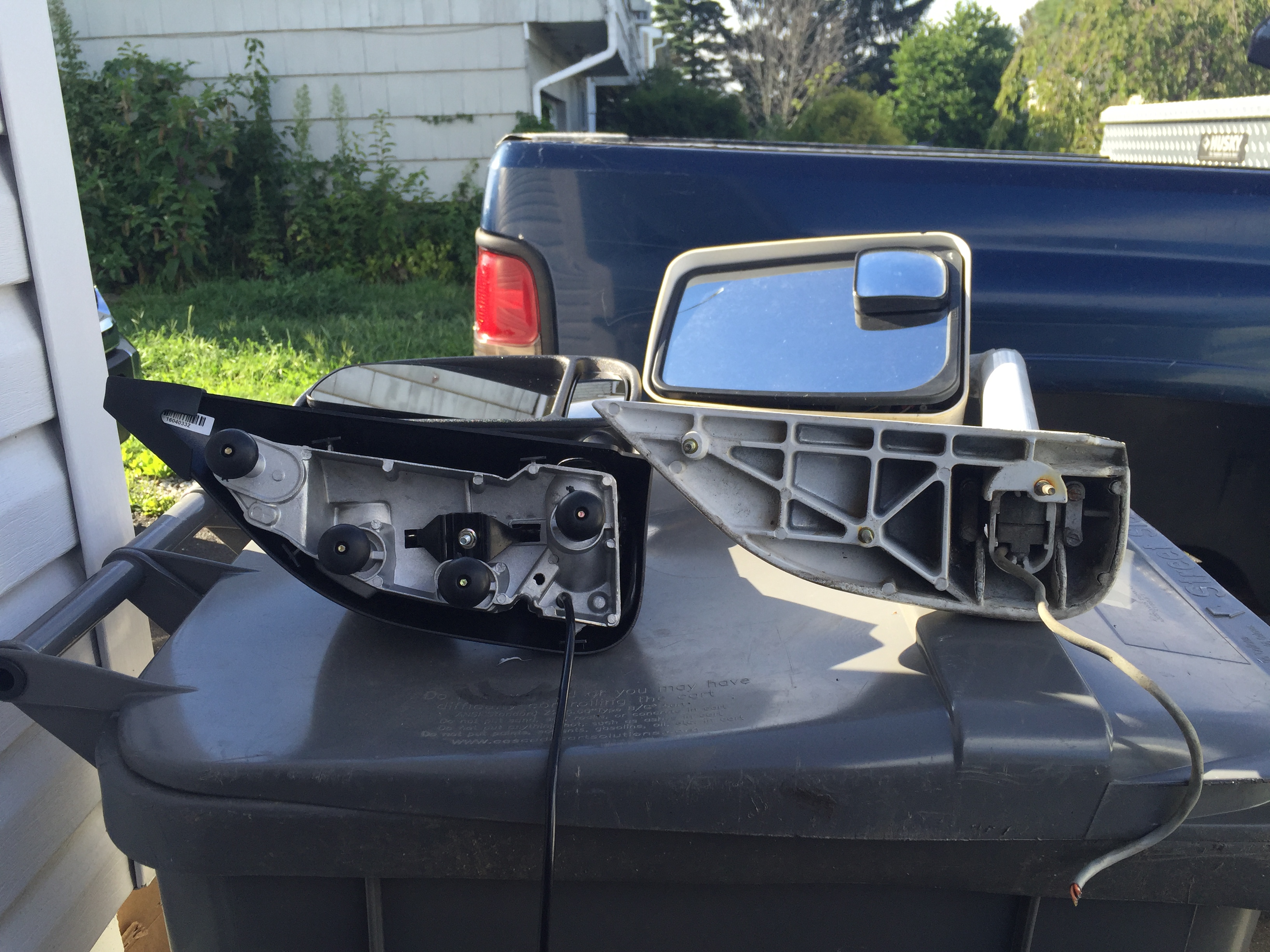

Little more info on the mirrors. I purchased them on Amazon for $127 shipped with Prime. Obviously they are not OEM but for the price I couldn't justify the OEM ones. The quality is really nice, but will see how they hold up over time. They have power glass but no heat which I wasn't too worried about.

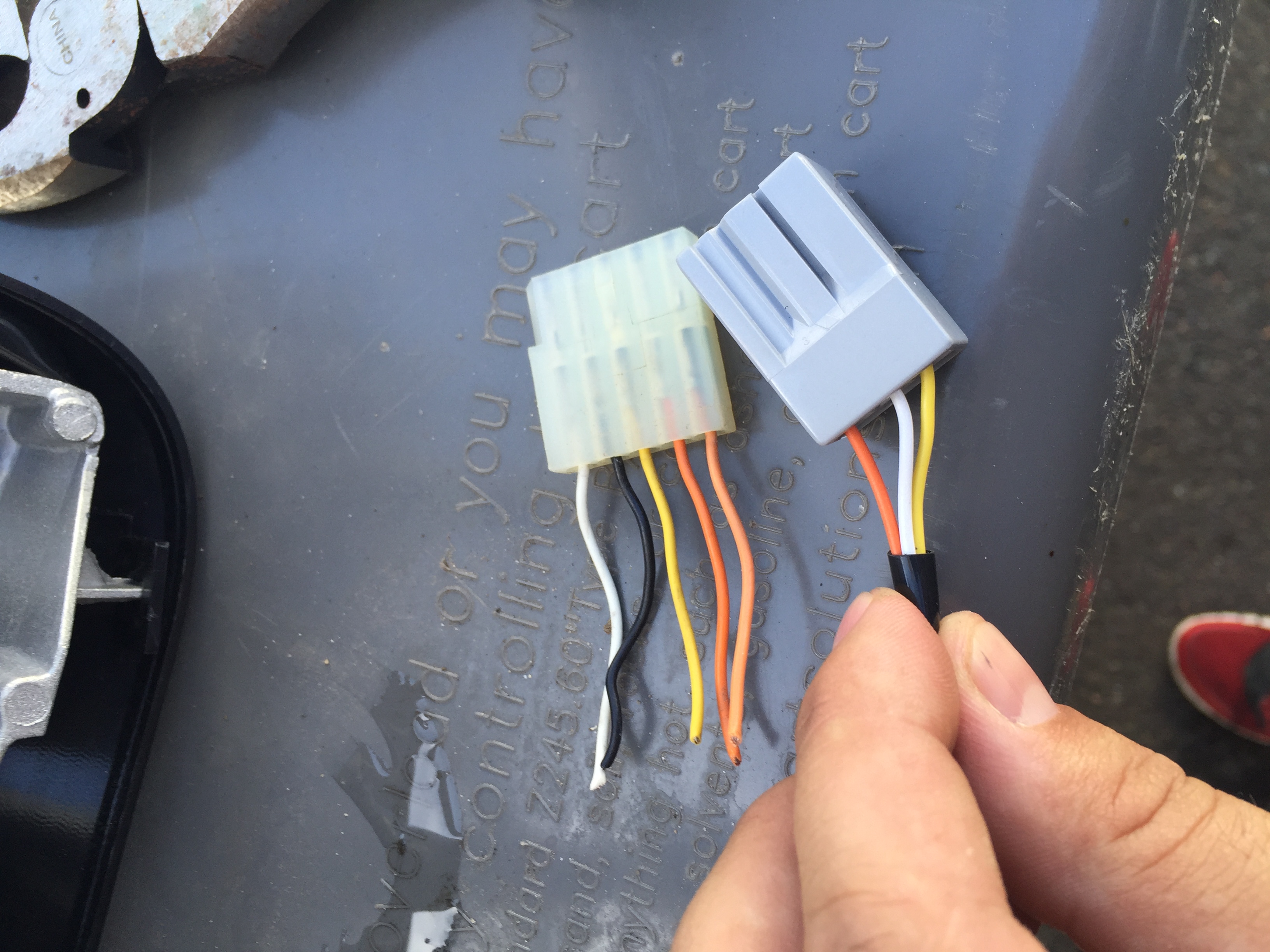

Here are a couple pictures of the base of the two mirrors so you can get a idea of the difference. Also pictured is the difference in the plugs, which I cut and spliced the plug from the original mirror to the new mirror.

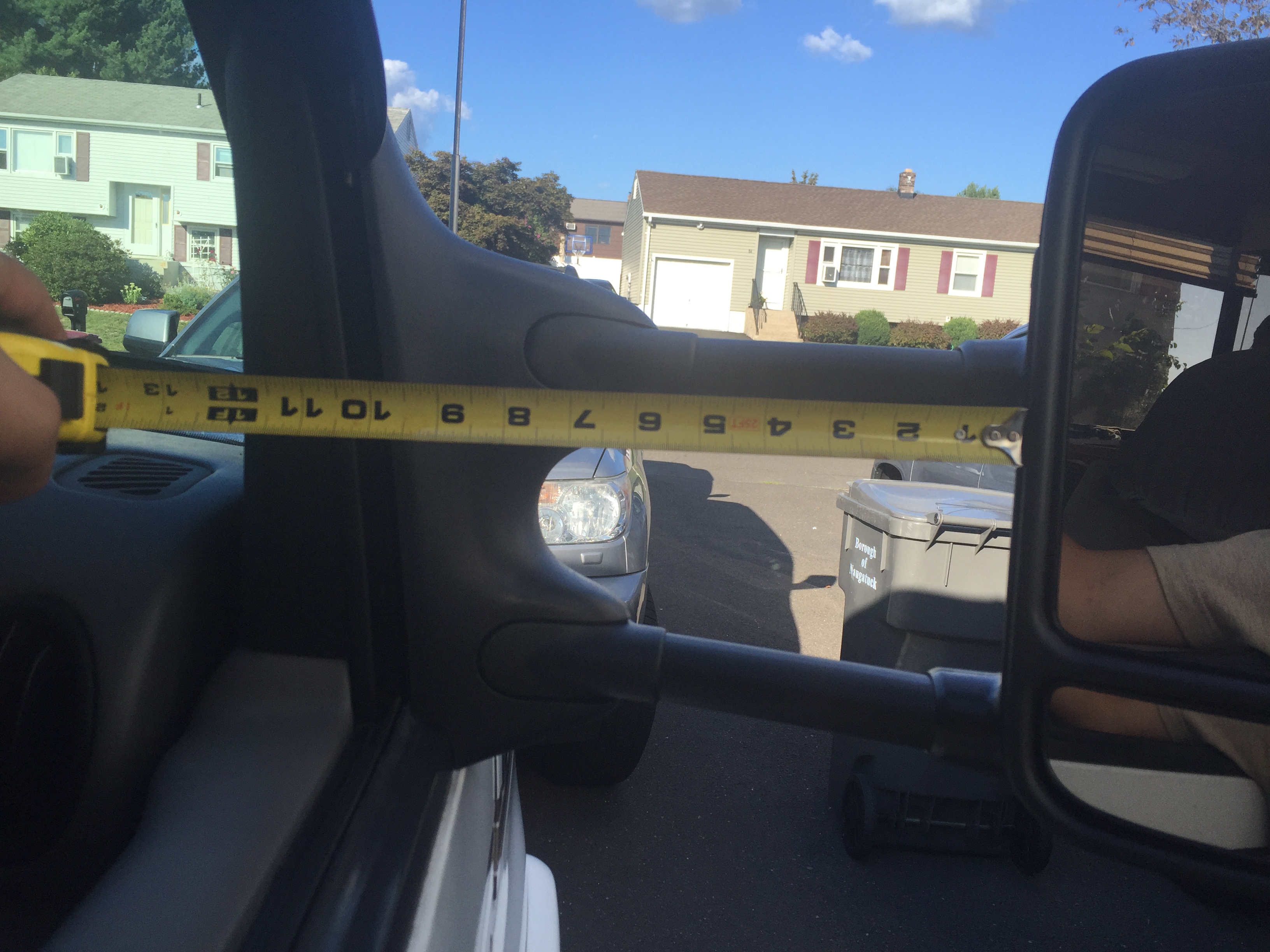

1) How far do the mirrors project when telescoped out? I guess a good measurement would be to the side of the mirror that is still closest to the van body. I like the "reach" on my Velvacs, but don't remember how far the Ford mirrors project. Plus of course no need to ever "un-telescope" them since the Chinook body never gets narrower like the varying widths of the combo of a "thin" van and possibly wide trailer.

Also just a tip if anyone else plans on doing this...
The wiring goes like this:
The new mirror has a White, Yellow, and Orange wire.
On the plug from the original Velvac mirror you will only use three out of the five wires. You will use the Black, Yellow, and Orange. The light orange is a ground wire that's not needed as the mirror itself is grounded. And the white wire was for the heated feature which the new mirrors don't have.
Connect the Black wire to the White, the Yellow to the Orange, and the Orange to the Yellow. Took me about 5mins to figure this out so I wanted to post the information up to save time for someone else.
Re: Installed New Towing Mirrors
Thanks for measuring and the other details.
I'll compare the 10" to the Velvacs when I get back to my rig, and post back.
