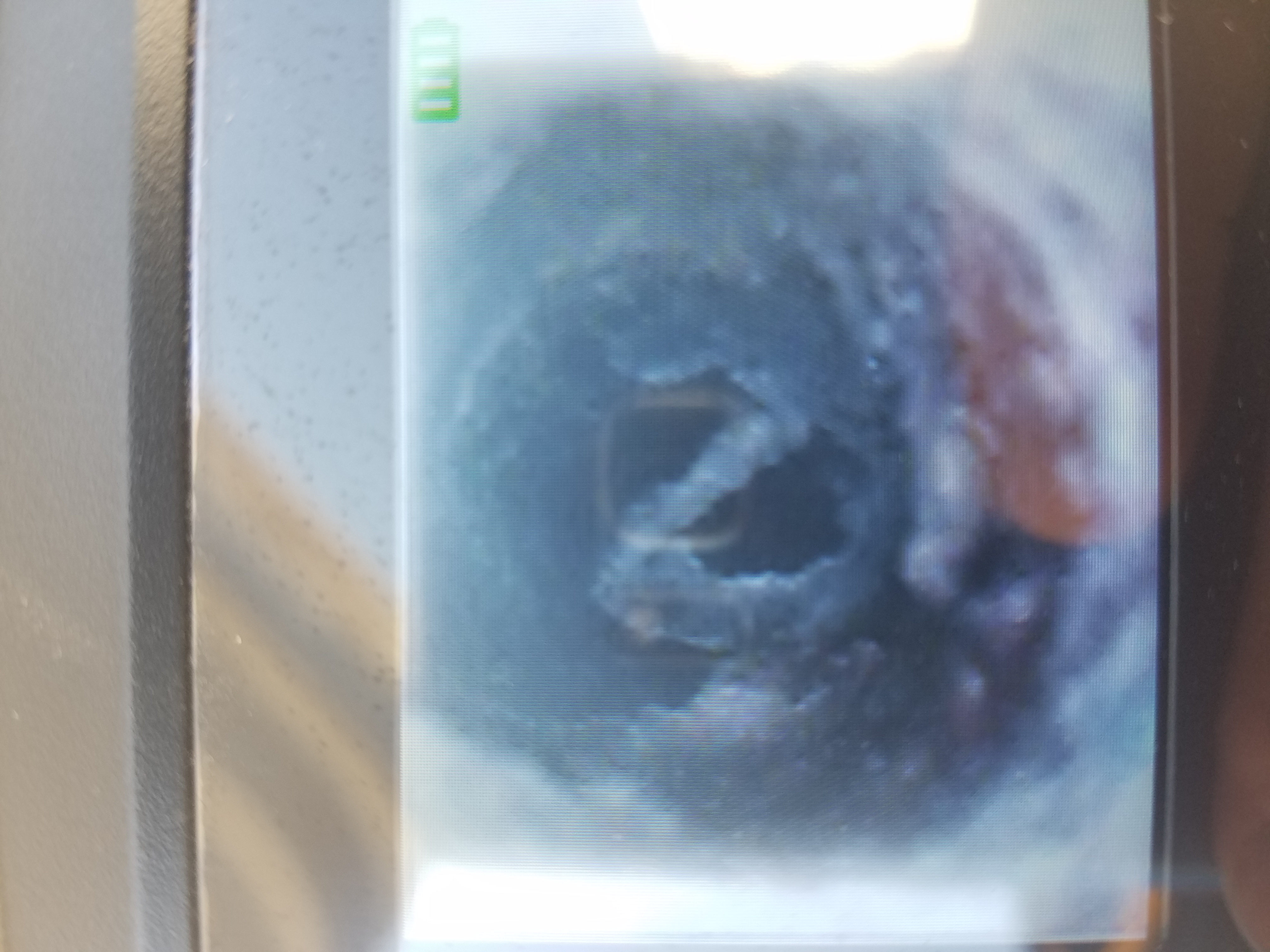

I used my cheap borescope to peer down the tube and while it looks open for the first 6", I can see build-up on the walls like calcium or something. I can't shove it any further down. The exterior has screws and I was tempted to take them out to see if I can see any better but it was getting dark and I didn't want to start a project without much light. I was thinking of pouring vinegar down the line and letting it sit for a day or two.

Sounds to me like a simple clog, since the cap was missing. I would try poking with a piece of wire to get through the block. Maybe even spin the wire with a drill to work it out. I use the flush port with a hose all the time and it works great. Once you get it open, find a plastic hose plug to keep it covered. Vinegar probably wouldn't hurt either if it is calcified.Skillet wrote:Does anyone use or have used the San-t-Flush port on the driver's side (at least on my Concourse) rear to flush the tank once you've emptied it? Supposedly jet cleans the interior walls when hooking a hose up to it. I attempted it for the first time and barely any water comes out the dump. I figured the jets or something must be clogged. Also, is it supposed to have a cap? Mine doesn't and I can see stuff getting in it over time.

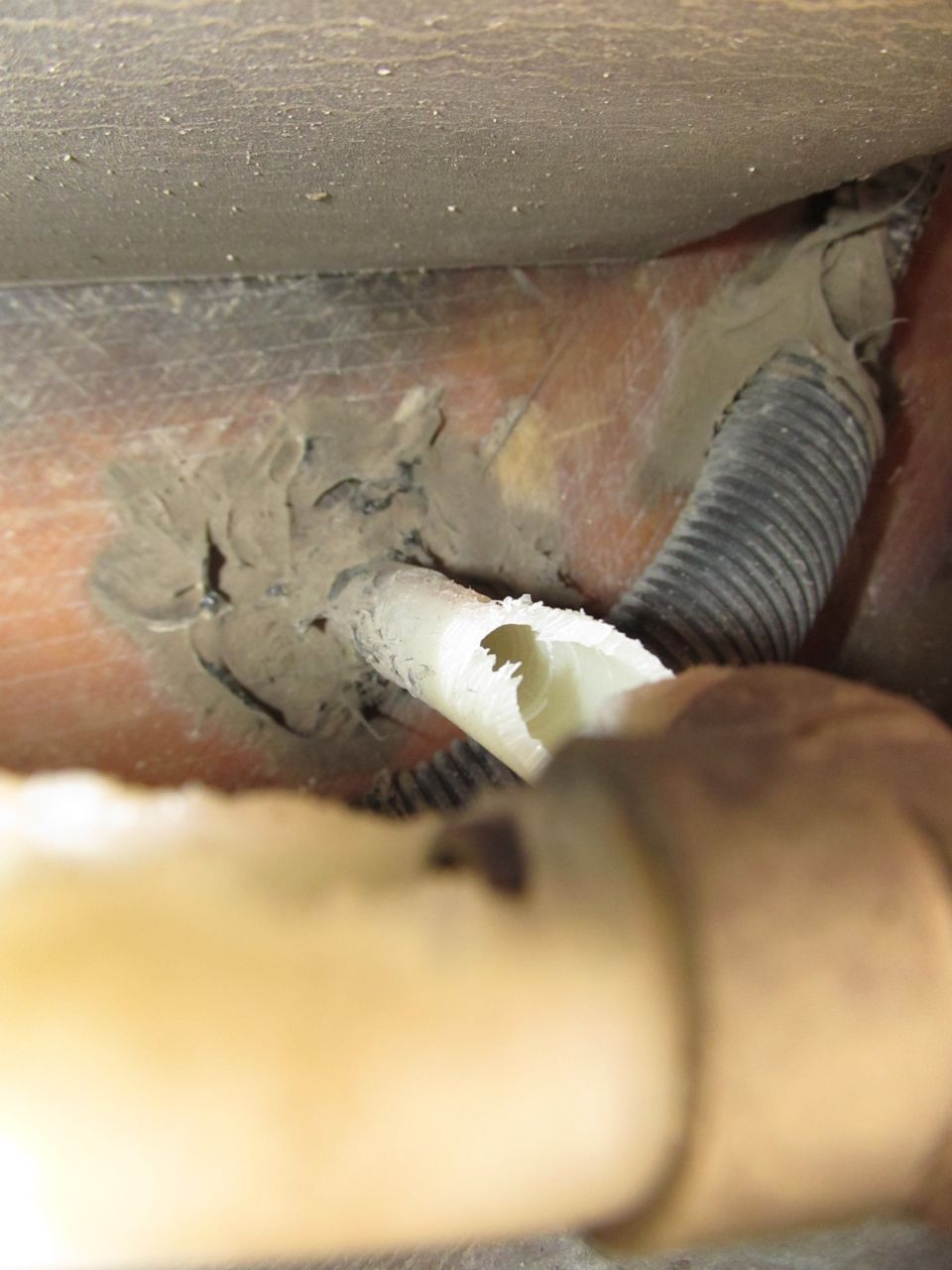

This is what it looks like at around the 7-8" area from the outside. The big pieces fell and I can't knock them out of the way. My mechanical fingers can't go past the initial narrowing of the tube so I can't use that to grab 'em. Something is keeping my scope from moving foward and I don't have anything stronger than a long zip tie that will fit. I need something bendy like a thick copper wire. I'll probably end up dumping vinegar down. I'm assuming some kind of hose or faucet bib cap would close it up. The square in the center is the reflection of my camera lens.

Blue: So you're saying from the port inwards, it should be PEX tubing? I'm thinking if I can't clear up the clog, I could cut it out and replace it relatively easy. If I take out the screws on the port, does that just remove the collar for the hose attachment? I wonder if I can see those jets. They must be clogged...

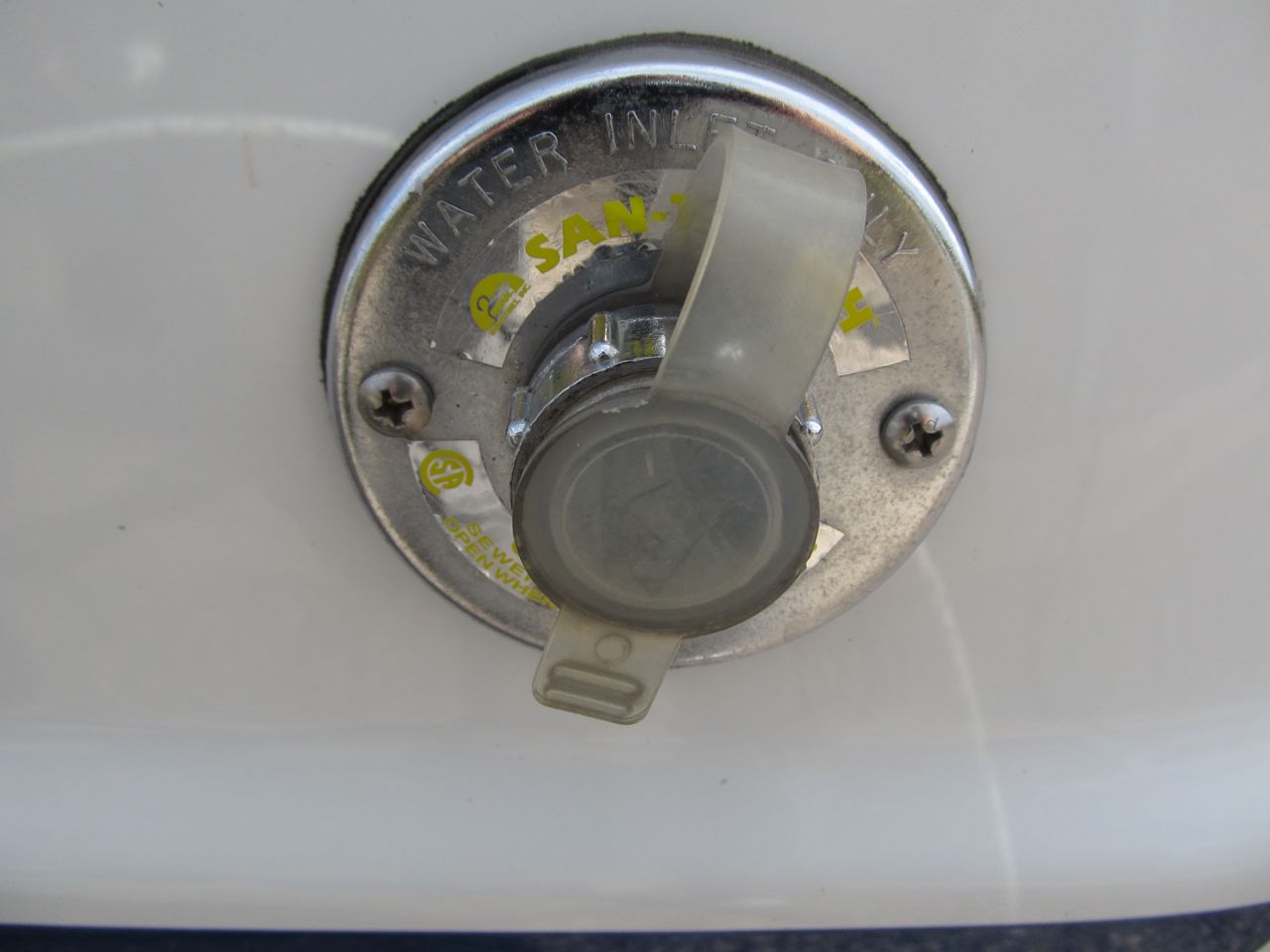

As I remember it, it's just all made up of PEX, with the Oetiker clamp type fittings. I'll see if I can find some photos. I'm kind of straining my memory here, but I think the outside fitting on mine had some type of flip cap that wasn't very secure. Since now that I've removed the PEX, any leak through the outer flush port would come into the tire locker (I kept the outer fitting), I closed it off with a white plastic threaded cap that's "solid." It's readily available from RV shops (white cap with grippy type things so you can screw it in by hand).
I think it's this cap, but not at my Chinook right now to check for sure. I picked it up at a hardware store that had a decent RV aisle, so nothing exotic. I didn't use the keeper strap at all. Hasn't come loose in the 2-1/2 years since I put it on.

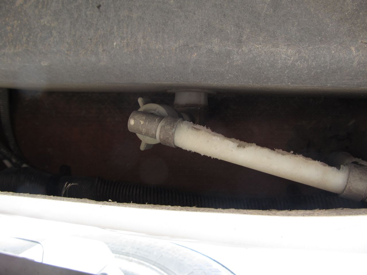

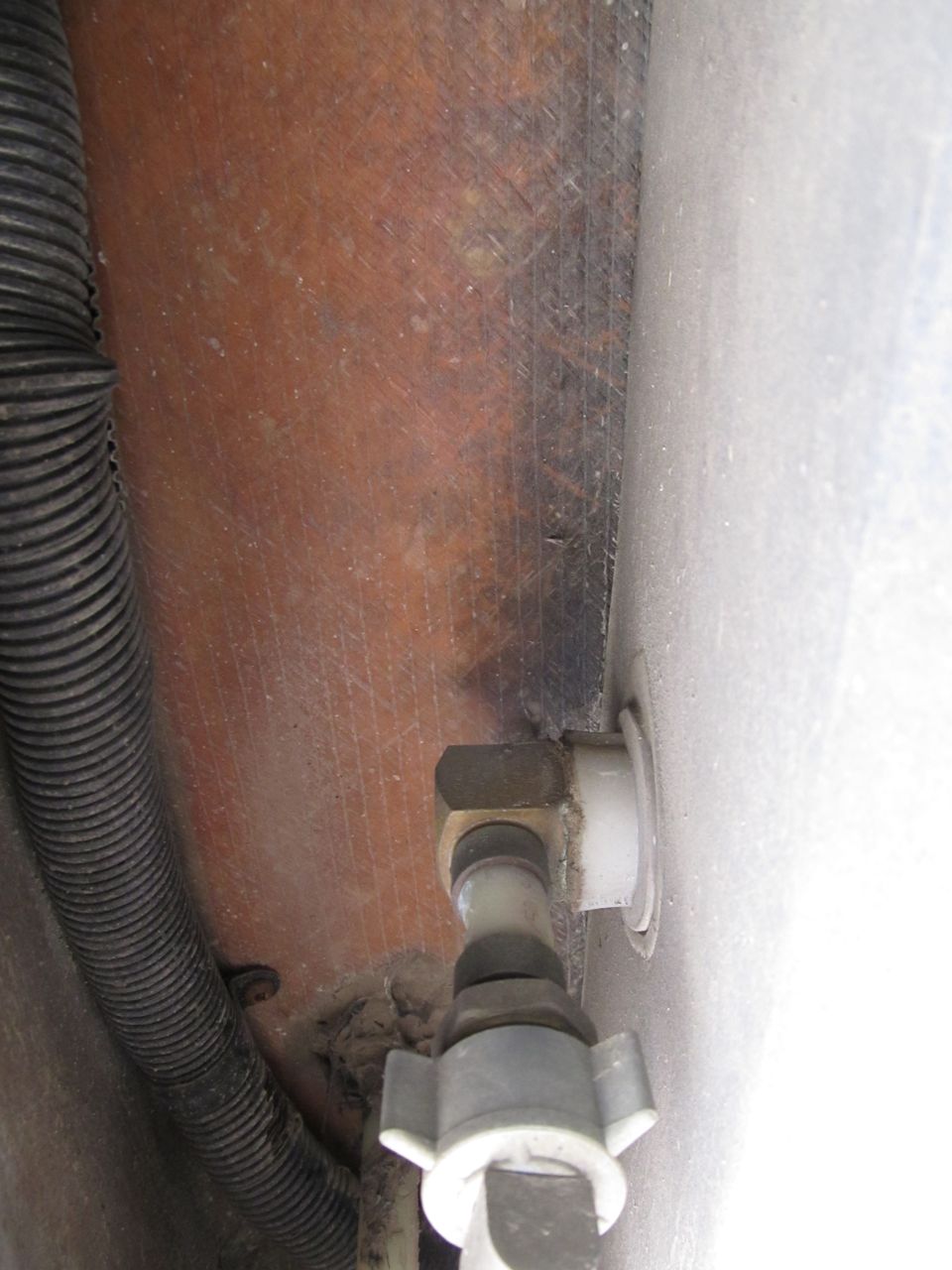

Okay, here are some photos. I don't have a complete "before" photo, but this should make it fairly obvious. In a nutshell, a section of PEX pipe comes in from the backside of the fitting on the outside of the rig. Then it makes a 90º bend and goes down to the floor and continues straight through the floor (hole in carpet/plywood floor). After it comes through the floor on the underside of the rig it makes another 90º bend and there is a straight section that's around 8" long (we're horizontal now), and then it makes another 90º bend (now we are going back up and are close to the wall of the black tank) and goes directly into one of those hand-tightened fittings -- and then a short straight bit long enough to line it up with where they wanted to be on the black tank, and then lastly a 90º elbow and into the spin-welded female fitting that's in the wall of the black tank.
See photos for clarity (I hope, anyway).
We'll start at the fitting on the outside of the rig. Mine looks like this. This shows the original "flip off" cap that tended to flip off on mine.

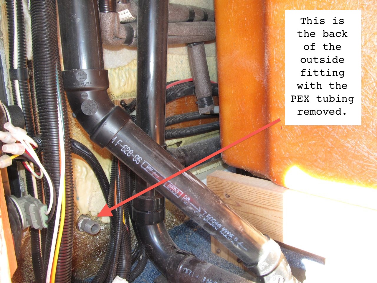

Here is the back of that same outside fitting. As you can see, this is after I removed the PEX tubing from the back of it. This is what is behind the "side wall" of the tire locker (what I call the compartment that's blocked by the original spare tire location) after you remove it (just screws). Although I did remove the rear wall of that locker (forward wall actually as the rig drives), I put the two side walls back. They come out and go back in easily.

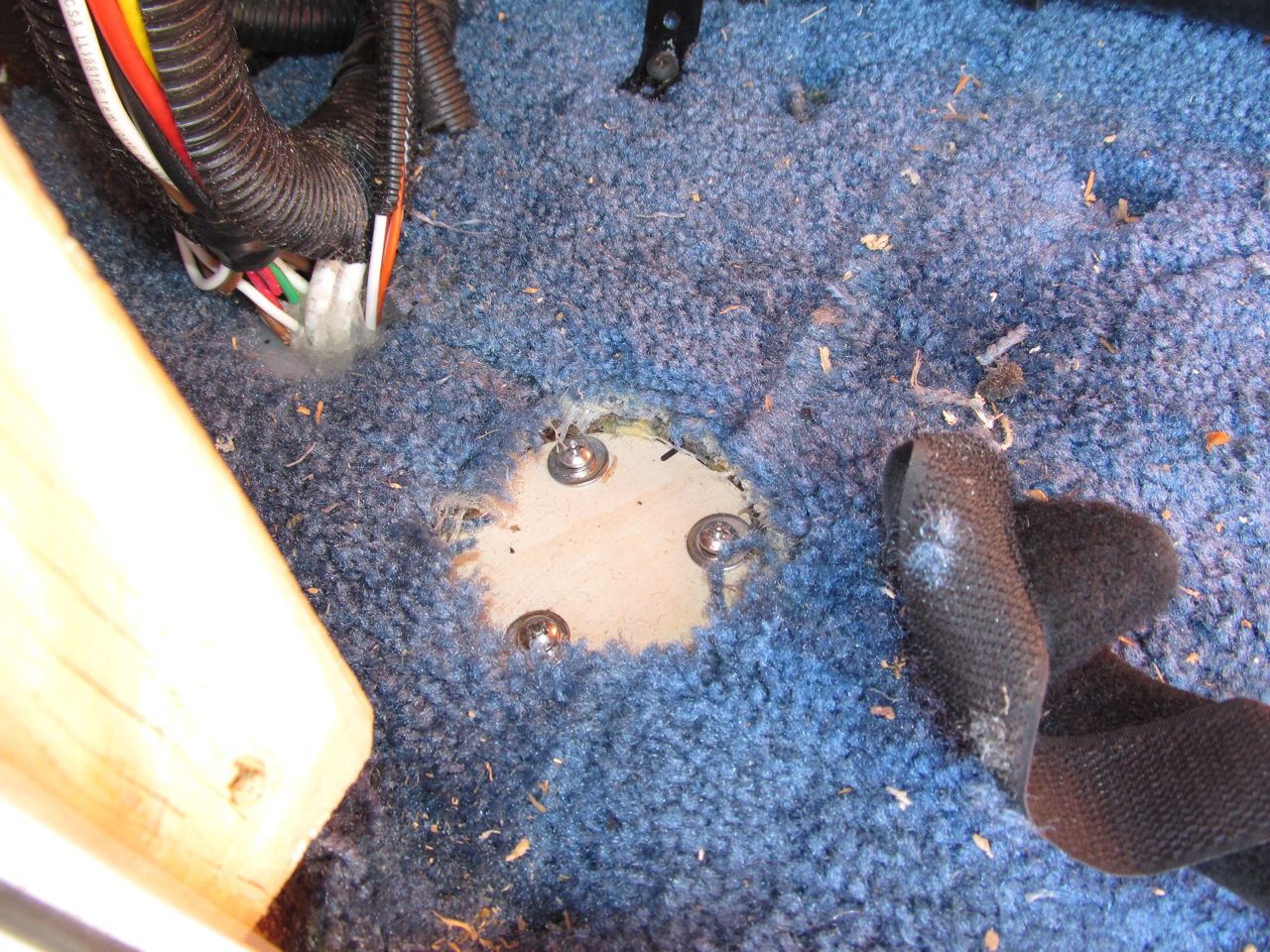

After the PEX tubing came in from the back of the fitting, it made a 90º turn with an elbow fitting, and then went through the floor to the underside of the rig. Here you can see where that was (the round cover with the three fasteners):

One of the reasons I decided to remove the flusher in the first place is that - although I never saw one sign of mice ever having been in my rig - something had chewed on the PEX pipe that was exposed under the rig at some time before I bought it. So I needed to repair the flushing tubing if I wanted to use the system. I decided that, at least for starters, I'd just remove it. That said, I kept the outside fitting, plus the fitting in the side of the black tank; so the system could be put back with just some PEX tubing and a few 90º elbows.
This first photo continues along where we left off. So this is the underneath part of the vertical section that would have come through the hole in the floor and then the 90º elbow into the cross (horizontal) piece. You can see where someone snacked on it.
Then here is the cross (horizontal) piece that comes off that elbow. The elbow to the right in the photo is the one you can see in the previous photo.
And lastly, here is the bit that goes back upwards to the tank fitting (spin-welded female threaded fitting in tank wall).
