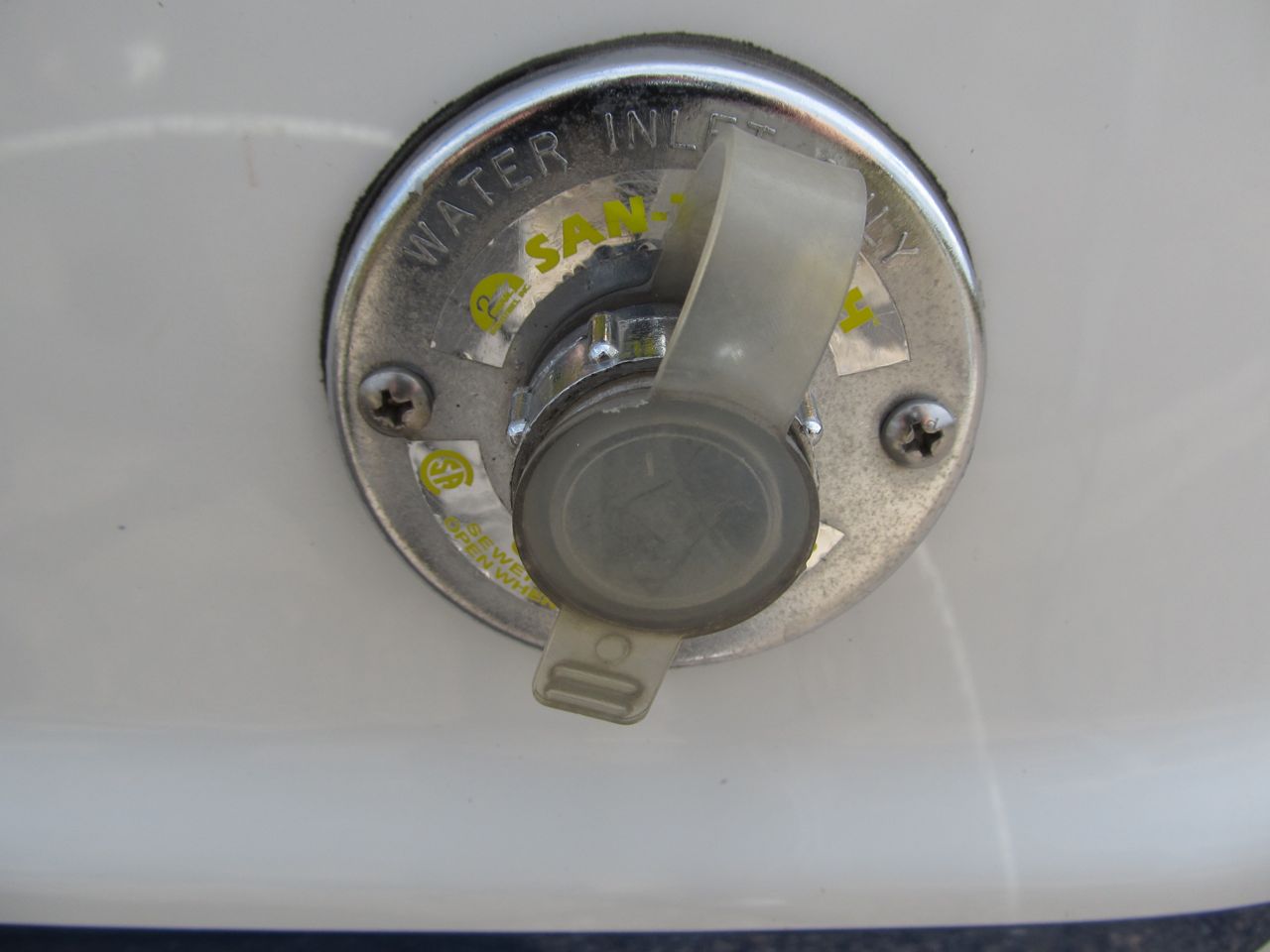

As I remember it, it's just all made up of PEX, with the Oetiker clamp type fittings. I'll see if I can find some photos. I'm kind of straining my memory here, but I think the outside fitting on mine had some type of flip cap that wasn't very secure. Since now that I've removed the PEX, any leak through the outer flush port would come into the tire locker (I kept the outer fitting), I closed it off with a white plastic threaded cap that's "solid." It's readily available from RV shops (white cap with grippy type things so you can screw it in by hand).

We'll start at the fitting on the outside of the rig. Mine looks like this. This shows the original "flip off" cap that tended to flip off on mine.

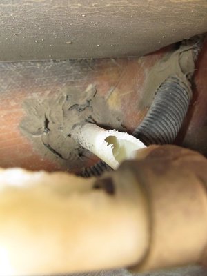

One of the reasons I decided to remove the flusher in the first place is that - although I never saw one sign of mice ever having been in my rig - something had chewed on the PEX pipe that was exposed under the rig at some time before I bought it. So I needed to repair the flushing tubing if I wanted to use the system. I decided that, at least for starters, I'd just remove it. That said, I kept the outside fitting, plus the fitting in the side of the black tank; so the system could be put back with just some PEX tubing and a few 90º elbows.
This first photo continues along where we left off. So this is the underneath part of the vertical section that would have come through the hole in the floor and then the 90º elbow into the cross (horizontal) piece. You can see where someone snacked on it.
