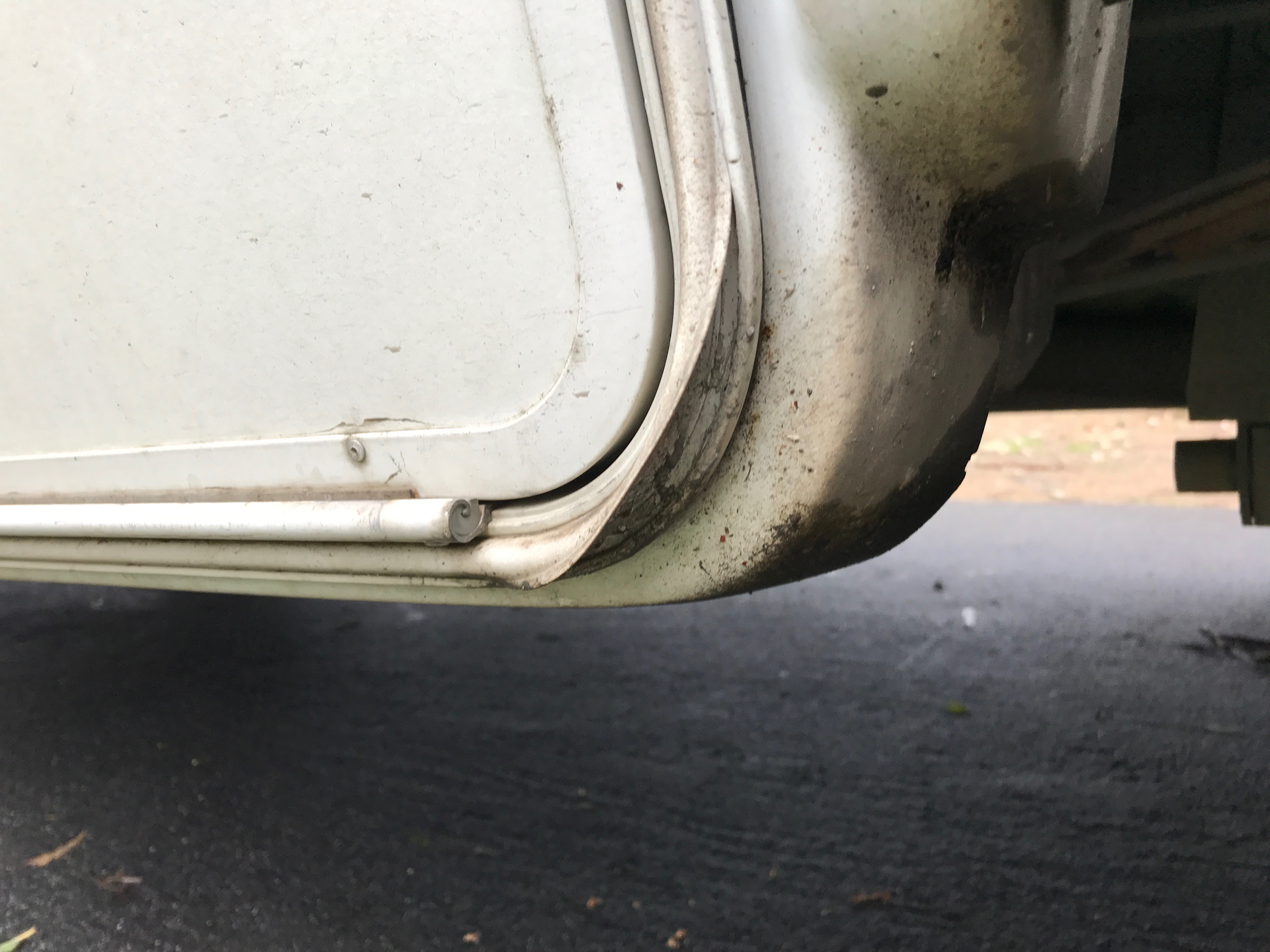

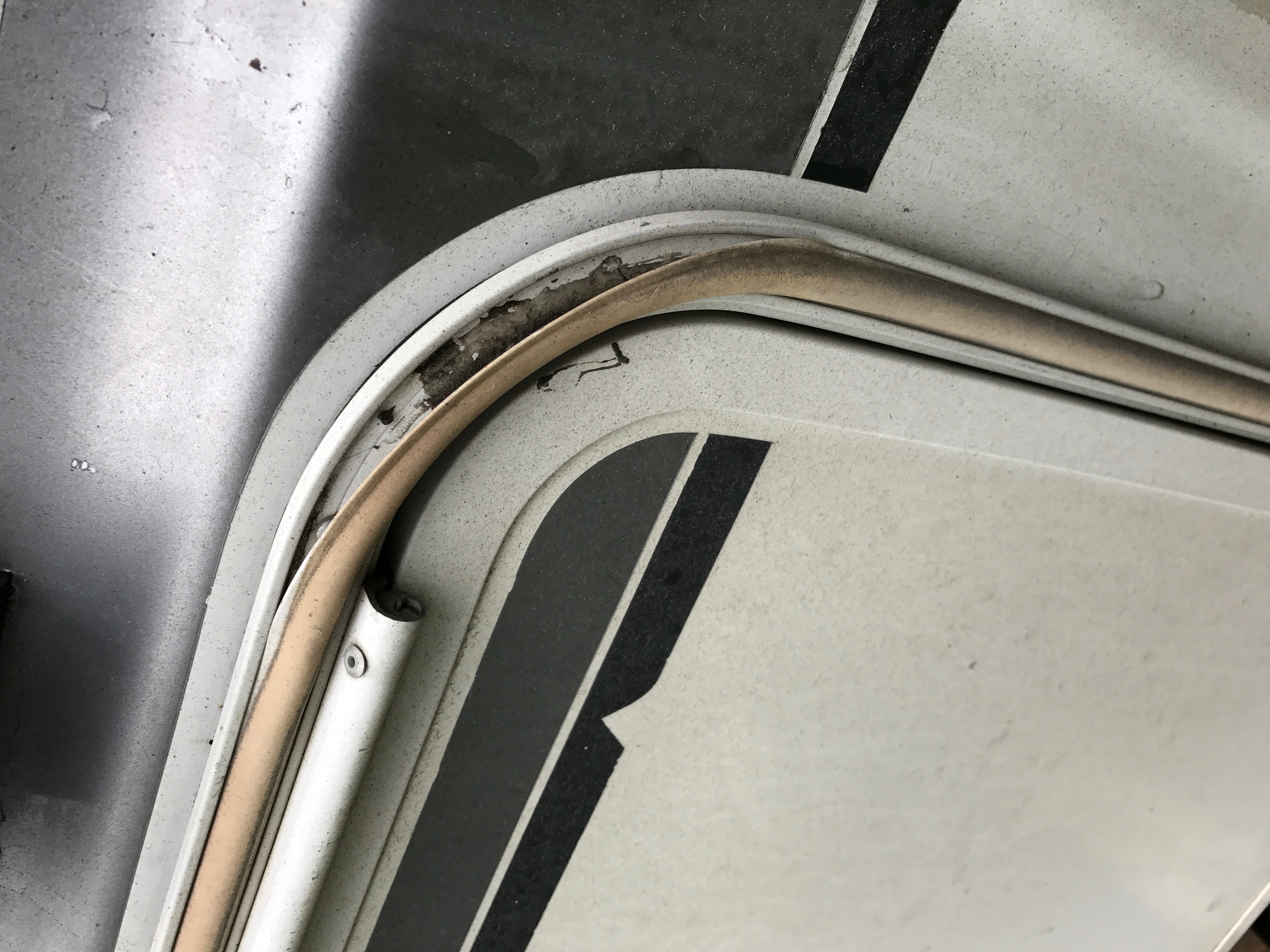

Does anybody know where/if these gaskets can be purchased and replaced on my outdoor hatches?

I think I just answered my own question, but will keep the post up for reference. It looks like this is going to be the right stuff. http://a.co/dtvoGTY

Can you let us know how that 3/4" Camco vinyl insert fits?
The irony is that I just bought a roll of this, but misplaced it before I could check the fit :x
Ours is narrower than the typical insert, but I'm not sure how the published size relates to the final width in our hatch frames -- because in the end it bulges up by design into that half-round shape.

Will do. I pulled out some of mine and measured it and it is 3/4". Hopefully this will work.

Update on vinyl trim insert replacement:
The camco stuff was crap, extremely stiff and impossible to install. I bought identical 3/4" Trim Insert from RV Designer not expecting much, but it is way better, really soft and supple and easy to install. What would have taken likely 1-2 hours with the camco brand will now take 10-15 minutes with this product - http://a.co/gEumgad
