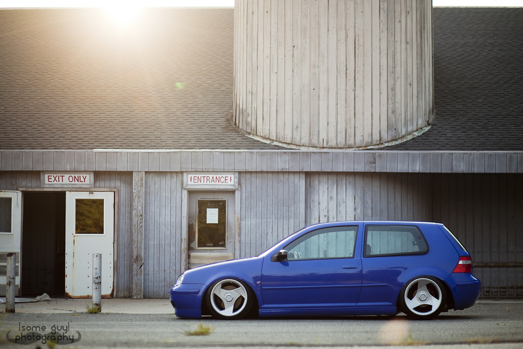

As for an on the go air ride kit, it is possible although probably expensive. I've installed air ride kits on many of my cars, it was with the intent to be able to have my car on the ground when parked(for looks) and then be able to raise it up to be able to drive. You would need on board air and a heavy duty double bellow airbag on top of your rear spring. In the front you would probably remove the coil spring and just run a bag over coil setup.
One of my old cars that I built a custom airride suspension for...
