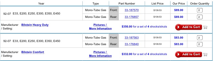

Those are the C for "Comfort" ride versions. They ride softer than the Heavy Duty HD versions.
Here are our Bilstein shock choices: http://eshocks.com/bil_veh.asp?Model_In ... &SubChar=Q
I recently put the HD version on the rear of my 1994. I like them. My rear rides smoother now, but then, I think all my shocks were originals, so no huge surprise there.
Anyway, I've seen plenty of people who've put the HD on back and the Comfort up front. So I was stumped about what to get for the front, and have indecisively gone back and forth for days.
I Googled like crazy and found people who favored each kind, but in the end someone's comment that the Comfort model might as well have been a stock Ford shock, finally tipped me towards the HD for the front as well, as they'll supposedly help prevent sudden tips because of the faster damping. OTOH, they could end up riding rough, who knows.
I just ordered them this morning. I'd love to hear opinions though. In fact, it's too bad we don't all go in together on a Chinook dedicated to simply testing various part choices

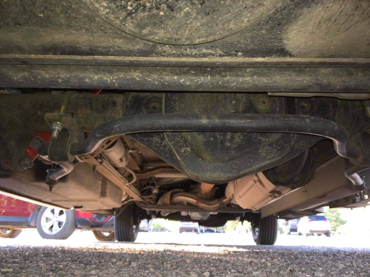

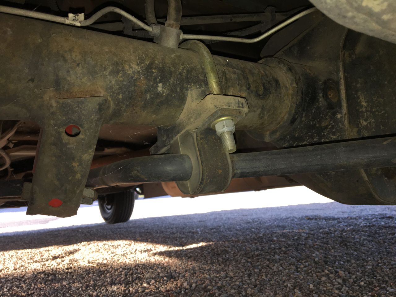

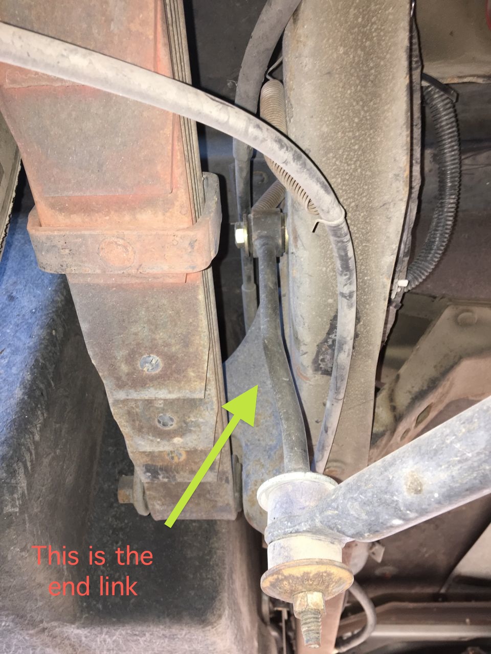

Let me take a look, but I don't think the bar uses attachment points, per se. I think they are U-bolty clampy things. Be right back after I shinny under and look...
Okay, I'm back - had to refresh my memory. I didn't install the bar, but I was down in the pit with the pro who did. Anyway, there are basically two types of attachment points. The bar is a sort of U shape with a long bottom and short arms. The whole U lies flat with the ends facing forward. Down on the bottom of the U (under the axle), it attaches with saddle brackets that are part of the bar not the axle. They include the bushings. That whole bit (came with the bar) sits under the axle tube and attaches to the axle tube with U bolts that fit over the axle tube and come down to meet the saddle.
The tips of the U attach to the frame, forward of the axle. There are vertical "rods" (I know the name of those but it's 98º in the shade and I think that part of my brain has melted) that go up and have holes at the end and those holes are bolted to the frame. They also were part of the bar IIRC. I can't remember right now if we used existing holes or made new ones. I *think* the instructions talked about how you might need to make new holes if the stock ones didn't place it correctly but I believe mine did so we used stock holes. I realize you have a '94, but likely the same frame (nothing guaranteed of course, we know how that goes!). I can take a photo later if that would help.
Main thing, as I've mentioned before, is that is has to be a "dually" bar. A "singly" won't work as I understand it.
I can't imagine not loving the bar upgrade, unless you hate cornering and/or never come off a gas station driveway at an angle.

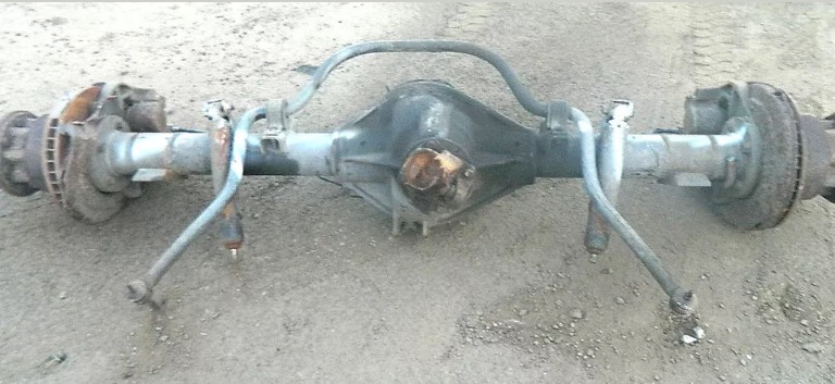

Re: Shock Absorbers
Thank you for taking the time in the heat to check!
Not to hijack this thread too much, but yes sir, I'd love a photo of your u-bolt saddle bracket attachments.
Cuz here's what a normal E450 axle looks like... notice the welded on attachment points. Btw, I'd never have thought to ask about being sourced from a dually. Good reminder!
Thanks again!
Thanks again!

Re: Shock Absorbers
I see what you mean in the photo. You know, I think perhaps our Chinooks didn't have any rear bar to begin with (it's been a while!). So perhaps that's why no welded on mounts on my stock, original, E-350 rear axle. I can say that both the Roadmaster bar (which I had mounted for a couple of weeks) and the E-450 bar (that I have had for the past 2-1/2 years) used the same mounting system. This is - as shown in the photos below - "saddles" below the axle that are attached to the axle with U bolts over the axle.
So here we go. First somewhat of an overview, although you can't quite see the passenger side (just a bit of the edge of that saddle). Second a close up of the driver's side "saddle," and third, a close up of the driver's side end link.
Re: Shock Absorbers
Again, many thank yous!
Hmm. I wonder if they might have reused your Roadmaster sway bar u-bolt based mounting kit. Is that possible?
In any case, for any of us to follow what you have, we'd need those saddle parts somehow. The used bars I've found all came from trucks having a factory axle mount, and thus don't have a separate saddle and u bolt assembly.
