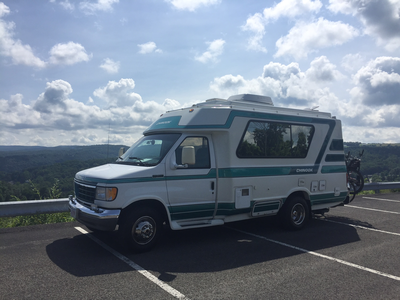

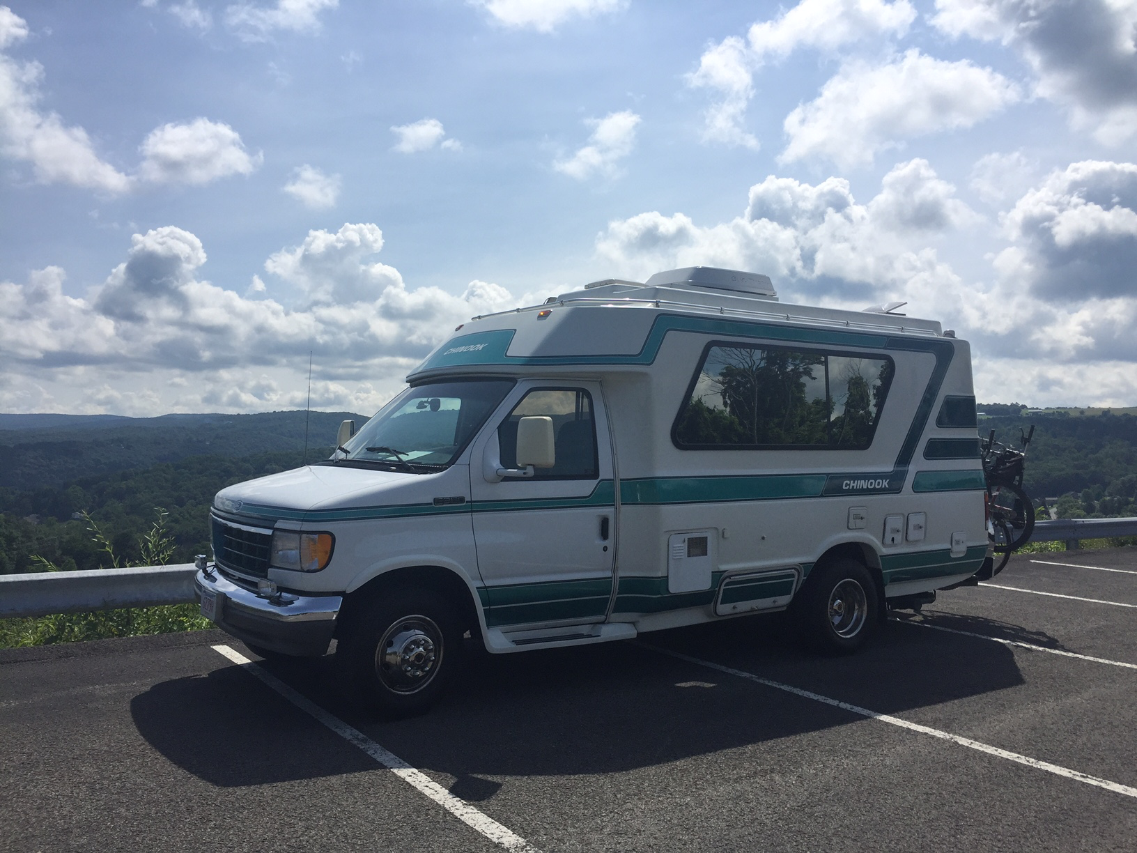

I've attached a picture of my beauty queen, sat in a heated garage for the last 10 years unused ( 11 more totalling 60K miles ) and now I'm putting her to work. She looks as new inside and out . Like many supermodels ...lots of issues...

Sitting, like miles and usage, can cause issues. You'll get it. Sure is a nice looking rig!
Good luck!
