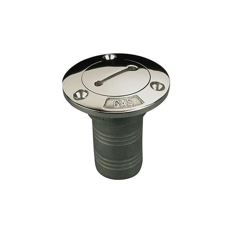

Marine deck fill (they come with different labels, the part number listed should be "water")
Sea Dog 316 Water fill part number 351322
$30 at Fisheries Supply (available multiple places):
https://www.fisheriessupply.com/sea-dog ... s-351322-1

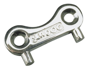

"Key" to open fill:
Sea Dog 351399 (these also come in plastic and other styles):
Sea Dog key 351399.jpg (21.87 KiB) Viewed 7178 times
Fisheries Supply, under $5:
https://www.fisheriessupply.com/sea-dog ... y-351399-1
