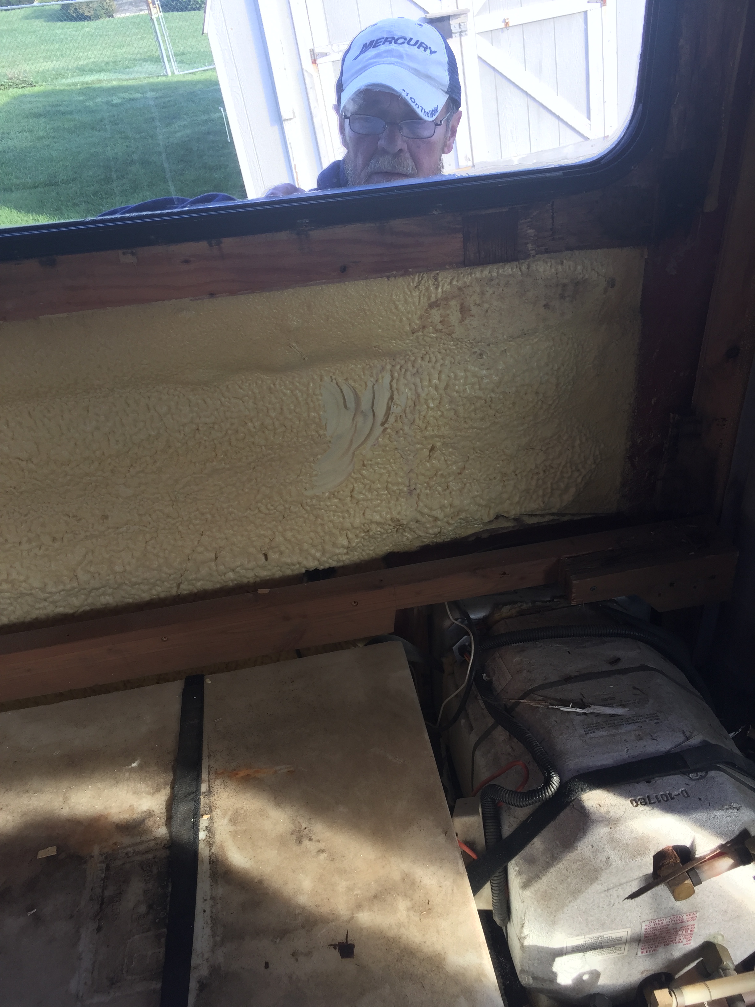

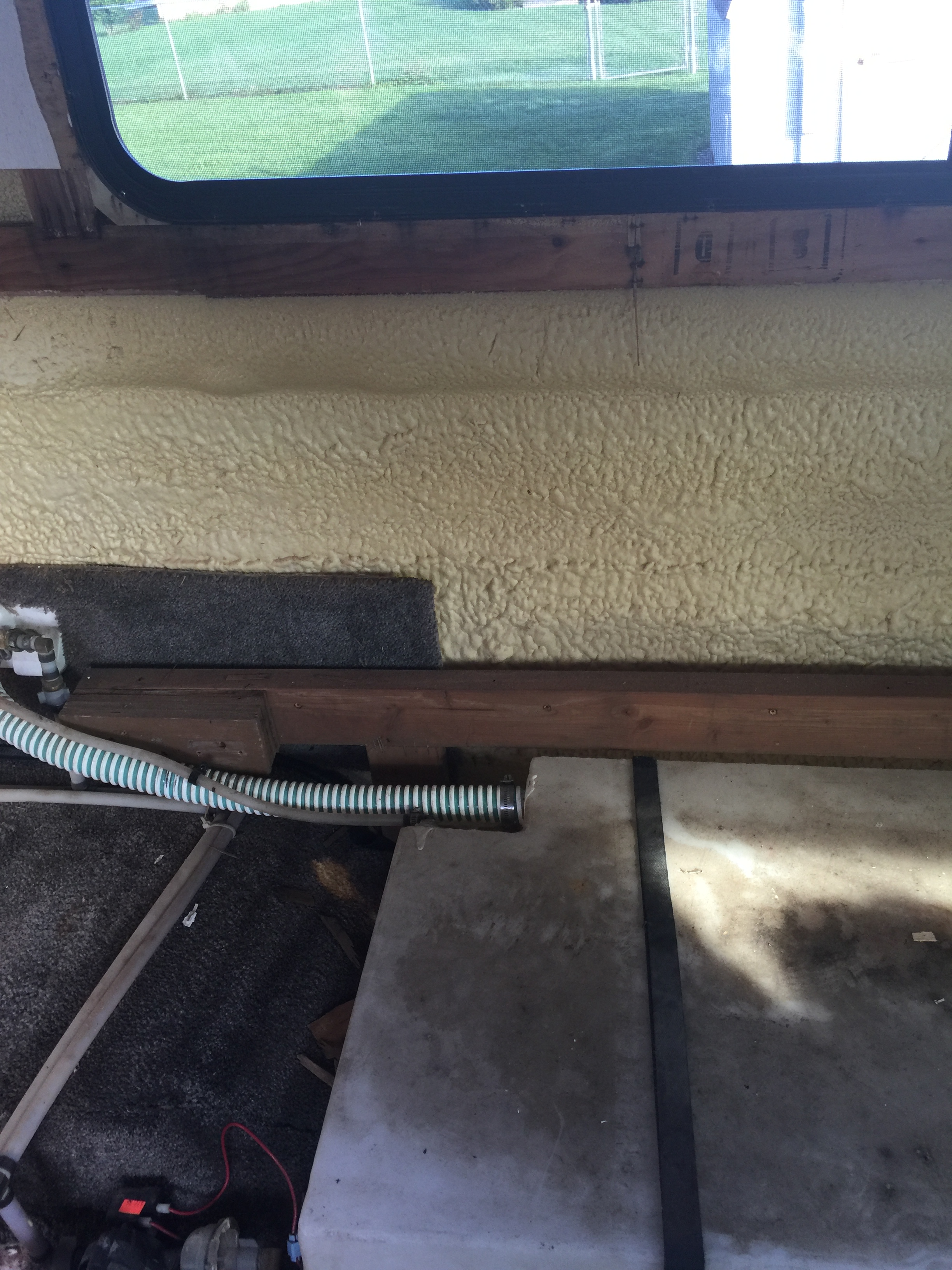

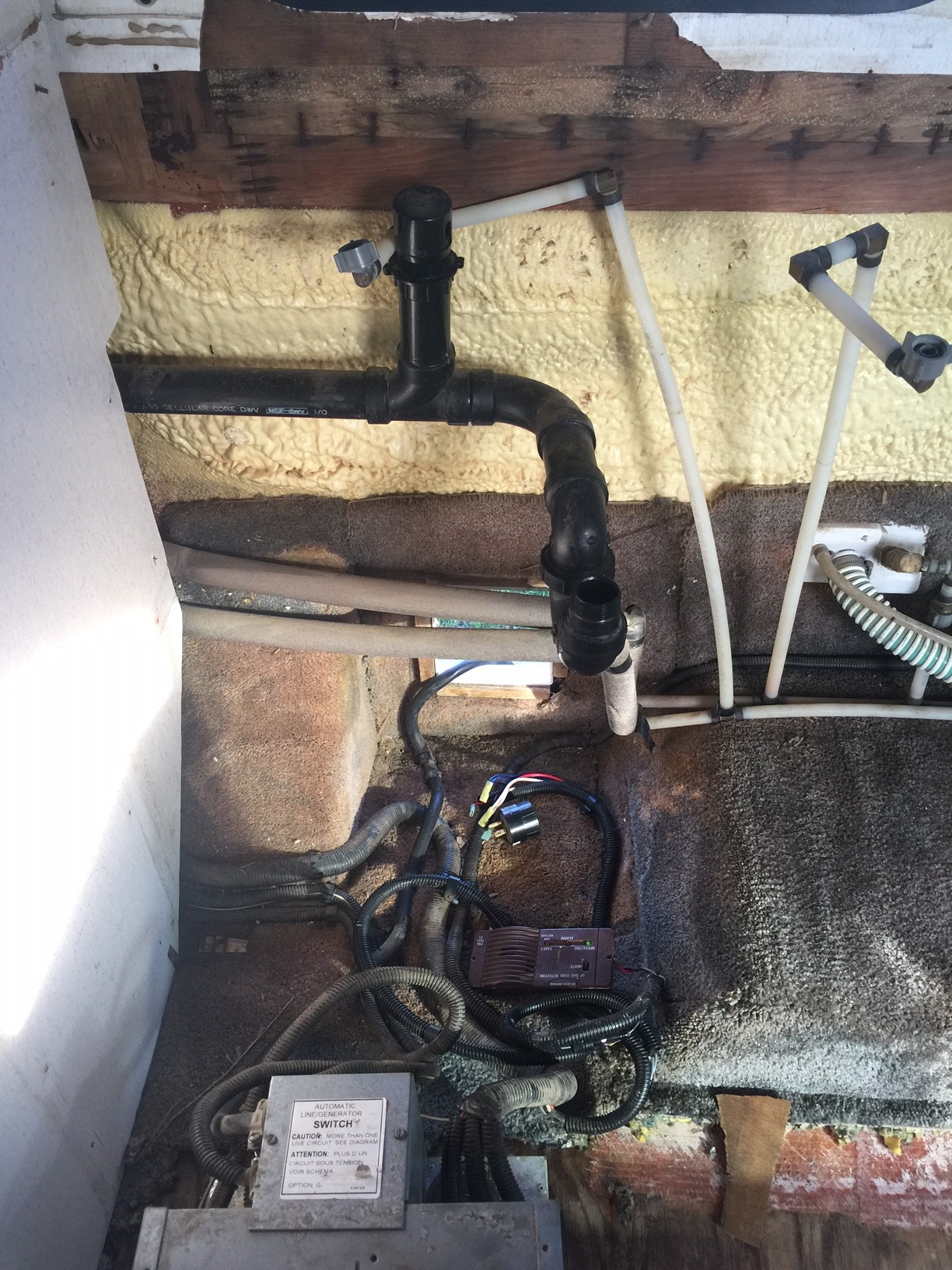

After removing the couch and the very thin wallpapered luan paneling, we saw the damage was not as bad as we first thought. There were two rotten sections of wood on the window frame/support/stud. After reading the forum, I realize there is some interest in knowing how that wall is actually constructed at the factory. Well, IMO, not that well... (we've had 2 Airstreams and now own a 2002 all-fiberglass Alpenlite that is SOLID). I attach images. There are no real studs, only a strip of wood underneath and around the windows. We might put some wood in behind the sink area, but haven't played with it yet. Also the electrical just comes in under the sink and there is an open hole - it is not blocked off. Hello Mice! Welcome Aboard!

Other side showing more of window framing.  Sorry it's dark.
Next post....rebuilding the wall and window frame, and re-installing the window. Let me know if you're interested.....I can outline the work and attach images.
Wood under window and foam insulation.  The big piece of wood at bottom is the only structural piece and it holds the couch, but we're using it to hold the new luan.
Sorry if this is not upright....save it and then view.

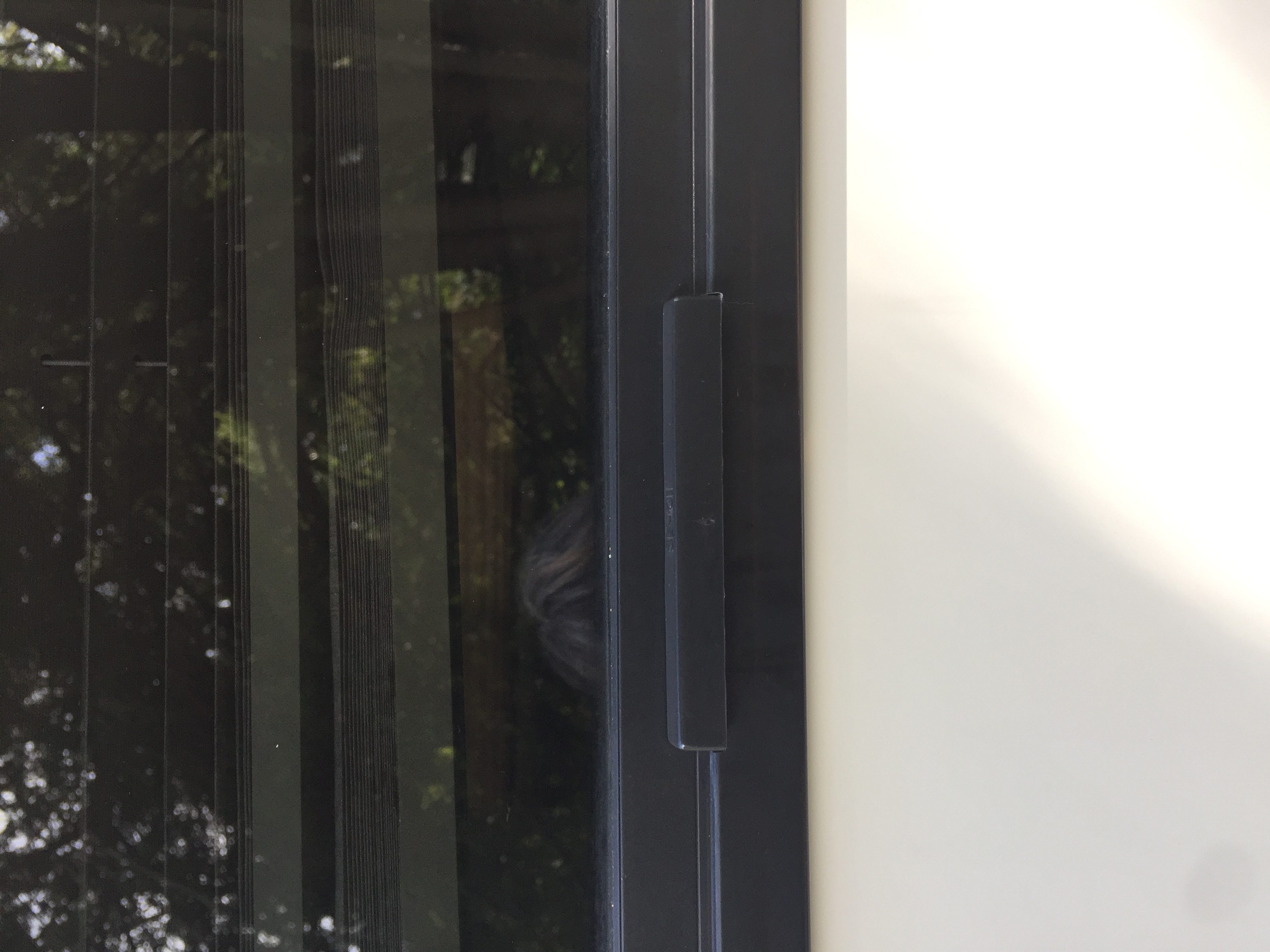

Our window by the table we think is leaking. When it rains the bottom of the window on the inside it has a gutter and it fills with water. How did you get the window out? I see no screws anywhere. Our Chinook or a 2002 Cascade. Any thoughts???

Sammy wrote: August 27th, 2018, 4:54 pm Our window by the table we think is leaking. When it rains the bottom of the window on the inside it has a gutter and it fills with water. How did you get the window out? I see no screws anywhere. Our Chinook or a 2002 Cascade. Any thoughts???
There should be some "weep holes" in the gutter that allow drainage to the outside. Sounds like they are clogged up. They are slots in the outside rail of the window frame, and have rectangular covers, if they are still present.

Hello Sammy,
I noticed the clips on the bottom of the outside windows and noticed the holes but didn’t know what they were were for since there were no screws I figured they didn’t have anything to do with removing the windows. So that is it!!! Do you know how to clean the gutters out? I thought maybe using a pipe cleaner and run through the holes from the outside?

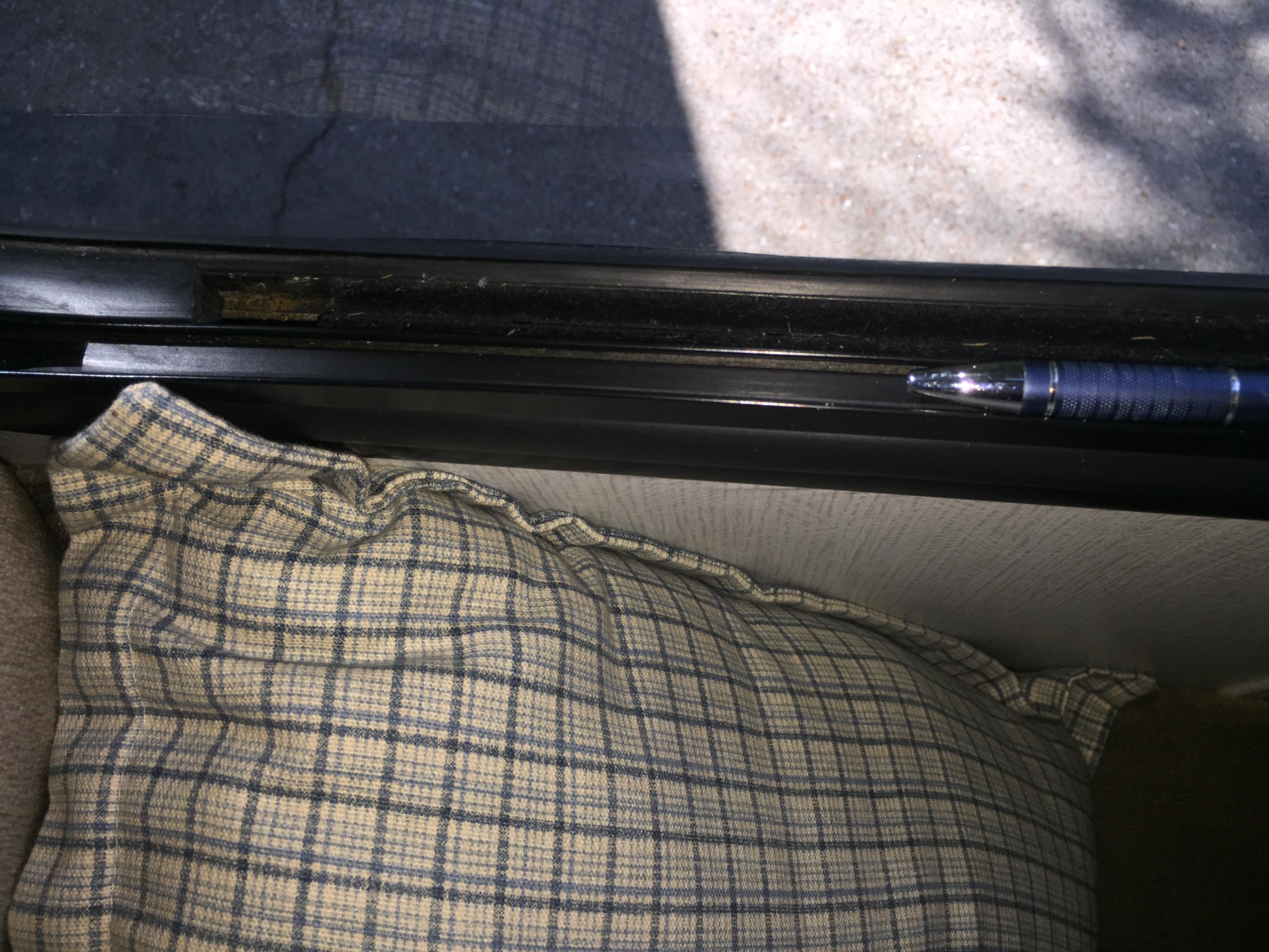

Just as background, Chinook has used a few different manufacturers and styles of windows throughout the years (and even within years). For example, Hehr brand various models, and SE-GI brand various models.
Different years have different "things." Now, if they are leaking around the bedding that's under the flange, then the only proper thing to do is remove the whole window, re-bed (under the flange) and then re-install.
BUT here is another example of something that happens on my particular era of window (and perhaps others). When it rains hard and a little from the side (on the side of a particular window), then the outside track of the opening part of the window fills with water, and it can run into the INSIDE track of the fixed part of the window. (This is regardless of having clean weep holes.) My rig tends to sit high in the stern, so that exacerbates it.
Normally it just sits in the track and doesn't really do any harm. Or it can be soaked up with a bit of paper towel or etc. One time, when the rain was positively *lashing* from the side, AND over 3" fell in something like an hour (roads were washed out), then it filled up enough that it would have run over if I had not been there with the paper towel. On the other hand a similar deluge that came more straight down gave me no problems, and normal rains don't either (neither does driving in the rain).
You probably don't have the exact same windows, but there might be something similar happening. Or clogged weep holes (but that is not the source of my problem).
Only if the water is actually leaking between the flange and the body do you typically need to remove the window and re-bed.

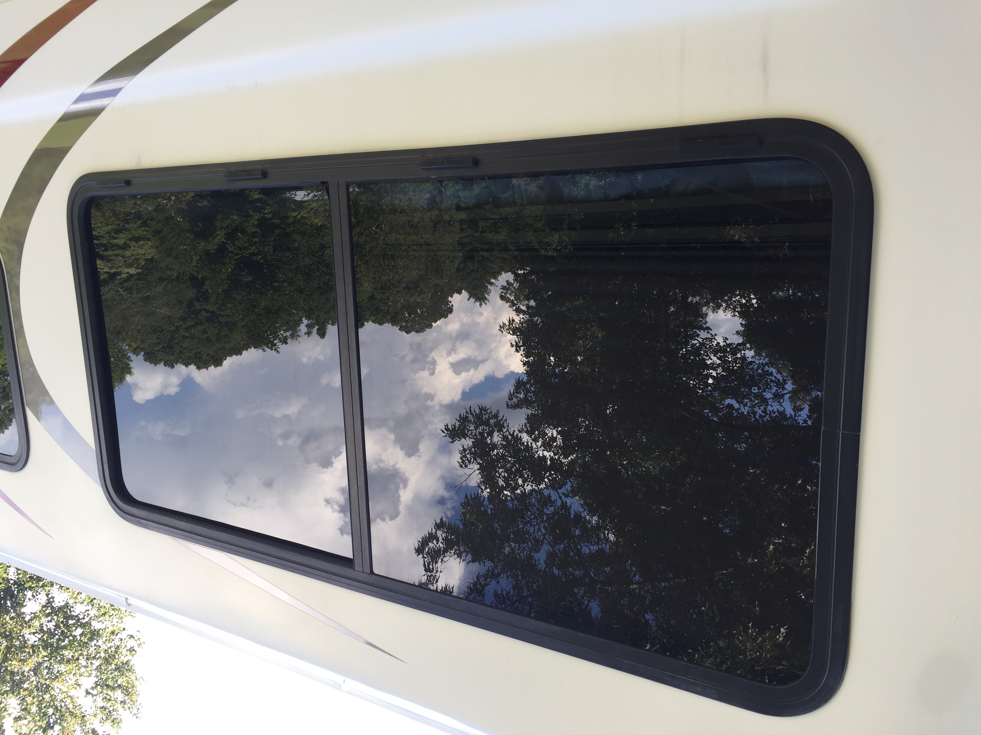

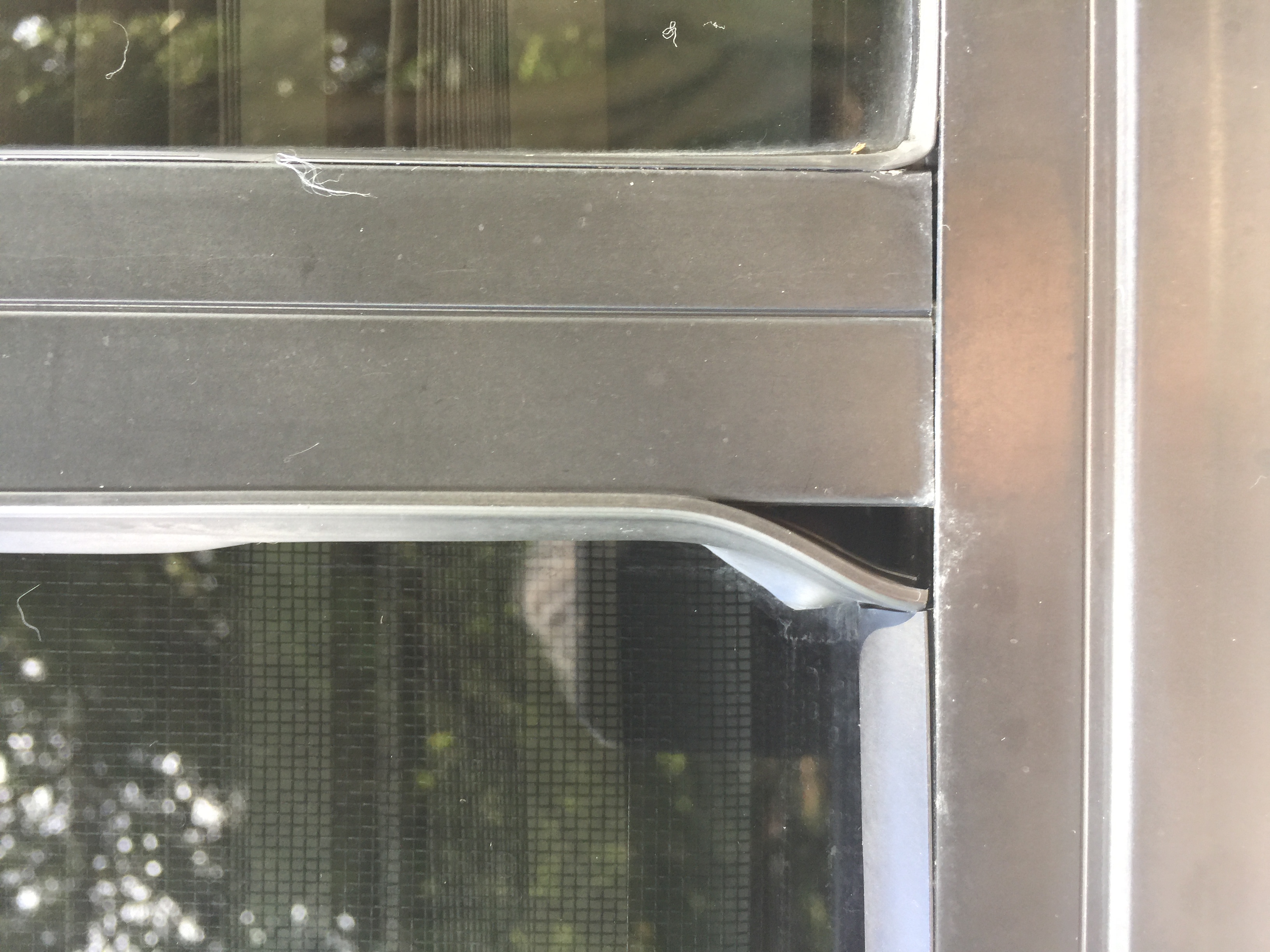

HEllo again!
I have enclosed some pics. The one with the pen laying in the gutter is exactly what you said. We were in a heavy rain for couple of hours and the gutter filled up but this was the only one and I haven’t noticed any water damage inside on the walls at all. I did send pics of the outside close up of two areas on the outside where it looks like the rubber seal have pulled away. This may be normal but just don’t know and I have all the original Chinook owners manual and do documents but there is nothing on the windows as far as what kind.

I think there should be small drain holes under those four rectangular "blocks" on the rubber trim?

I've been having the same problem Blue mentions, in a big storm with water streaming down side of rig and collecting in the track.
This conversation just made me think, "Just drill a few new or enlarge the existing holes.
