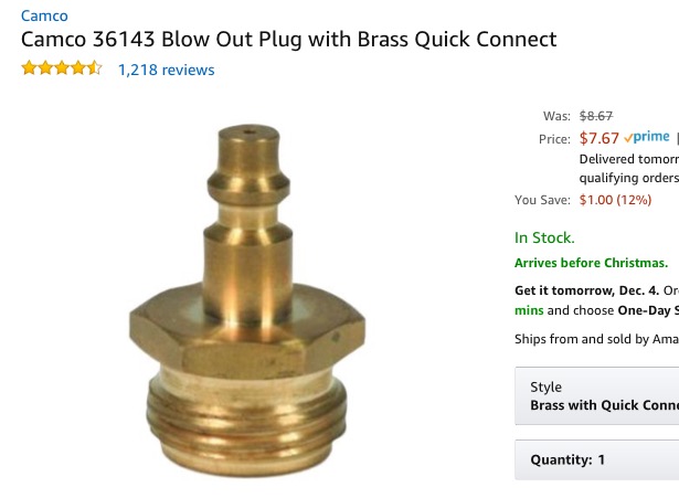

Also, besides running the pump with all the faucets open and the grey water drain open as well, there's also using air pressre to blow out the lines.

Thanks for all the information. Did fiND the valves by water heater. More water flowed out!! Air compressor finished the job.
