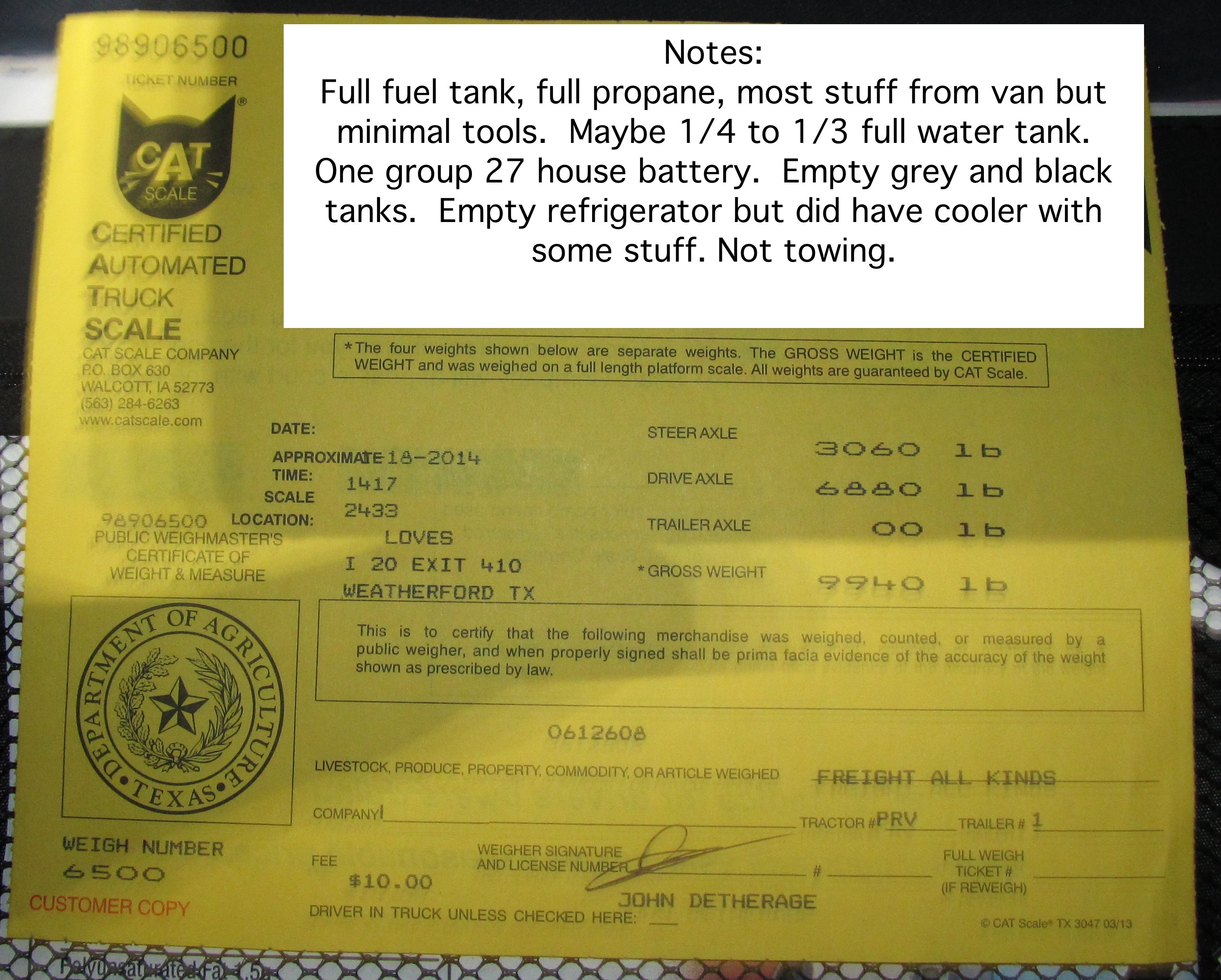

So at baseline weigh, I got these figures:
1) GVW = 9,940# (760# to spare)
2) GAW-F = 3,060# (640# to spare)
3) GAW-R = 6,880# (620# to spare)

So could I add 500# of motorcycle and carrier?
1) GVWR, maaybe. I only have 750# to spare and still need water, stuff, and food, so this could be tight.
2) GAWR-F, sure. No problem there.
3) GAWR-R, likely not. Much of my "stuff" weight will also affect the rear axle, the bike plus carrier will add 600-700# to the rear axle and I only have 620# to spare to begin with.
Since the weak link establishes the rules, I don't think I'd be able to carry said cycle. I'd likely move to a lighter one, or tow a small trailer which has the plus of also being a built-in garage, plus you can more easily get in and out the rear door (in fact I do tow a small cargo trailer from time-to-time).
