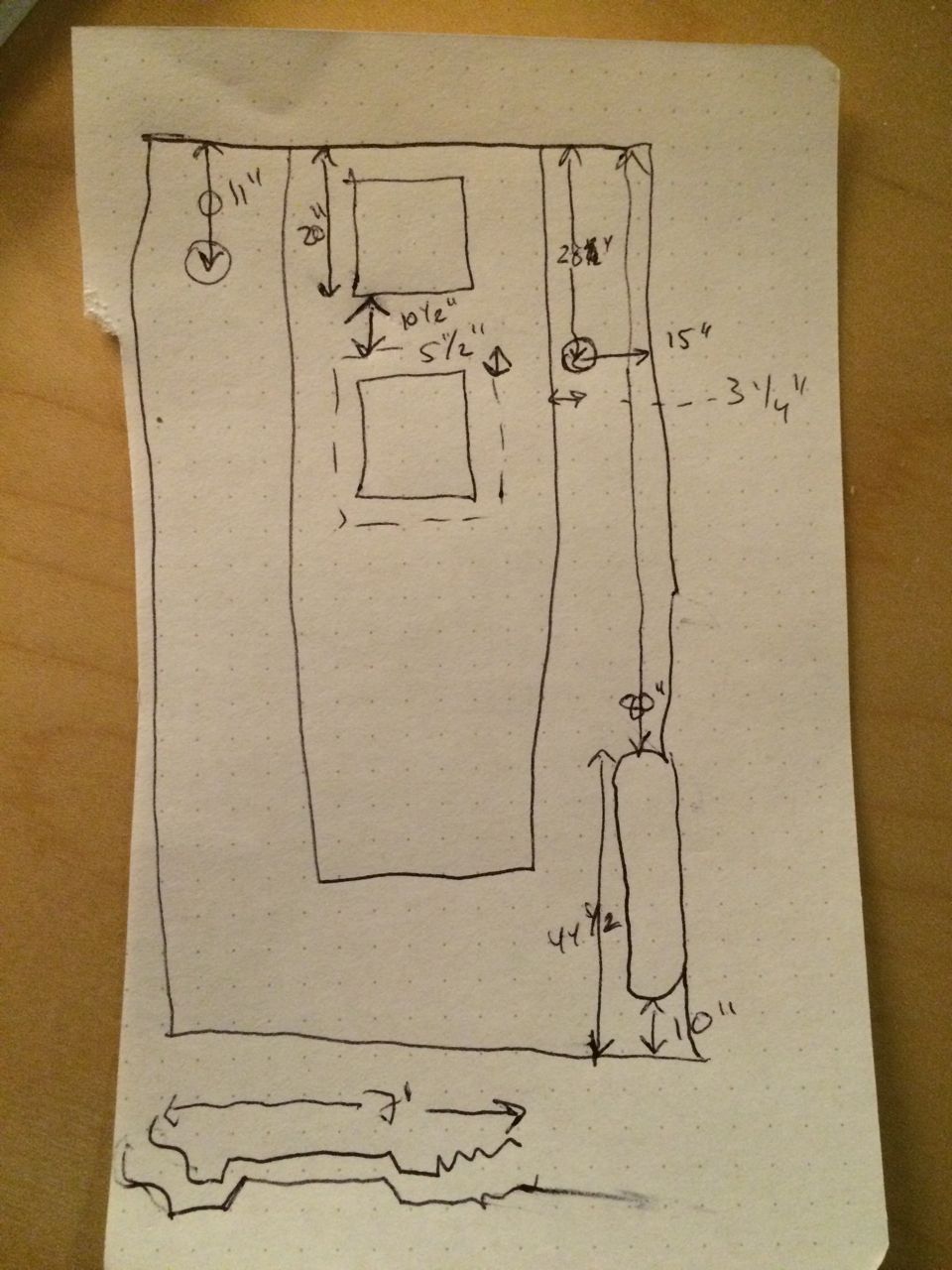

On the wiring, since I have a '99, this should be pertinent:
Starting on the roof, if you were to remove the original panel, you'd find an SAE connector coming up out of the roof (has a three-screw flange). Here is a ridiculously primitive sketch I made a couple of years ago that shows where the hole is (and also shows the big antenna-rotator hole on the other side). I can't remember what the jaggy thing at the bottom is at the moment, so ignore. It meant something to me at the time
From the SAE connector on the roof, two, IIRC 12 gauge wires (I know, so small) go through the roof cavity and then pop out into the overcab just above the original controller (which you won't want to keep if you are upgrading panels). Then from the solar controller to the batteries (which are practically in a different time zone) with another skinny wire (this goes across inside the overcab) which ends up at an inline fuse at the house bank and then right to the battery posts.
One thing I don't have on the sketch is the bathroom roof vent. This limits the driver's side tier to around 109", IIRC. At any rate, it's not enough space for two ~58" panels end-to-end on that side.

So, I'll just be running new wire, in a new place, with a "good" through-deck gland. There I'm still considering a few options (ridiculously, with the effectiveness of the ground panels, I still don't have my roof solar on yet!). The glands I'm speaking of are generally used on boats for deck penetrations.
1) A Newmar DX-5 will eclipse the large hole that originally held the TV antenna adjustor crank. This will fit multiple wires. On the other hand, they "stick up" as they come out vertically. May not be a problem but depends on how thick the wires are (bend radius) and how high you have the panels off the roof.
2) Multiple Scanstrut 90º roof glands. These only handle one wire apiece (and only up to 10AWG, IIRC), but then the wire doesn't go up/down in a shepherd's crook type fashion after exiting the gland on the roof. If running series pairs (as I do/will), then 10AWG is sufficient, depending on panel size/run length.
Scanstrut also makes a nice oblong one that handles multiple wires, but it doesn't "cover" the antenna hole. But you may not be using that. Blue Sea makes glands as well; I just happen to prefer the Newmar or Scanstrut ones, but I have used the Blue Sea in the past too.
With these scenarios, any junction "box" will be inside, either in the overcab or one of the upper cabinets forward. I don't want a junction box up on the top tier, and not even really anywhere else - just not convenient (or necessary) to have it on the roof for my setup.
