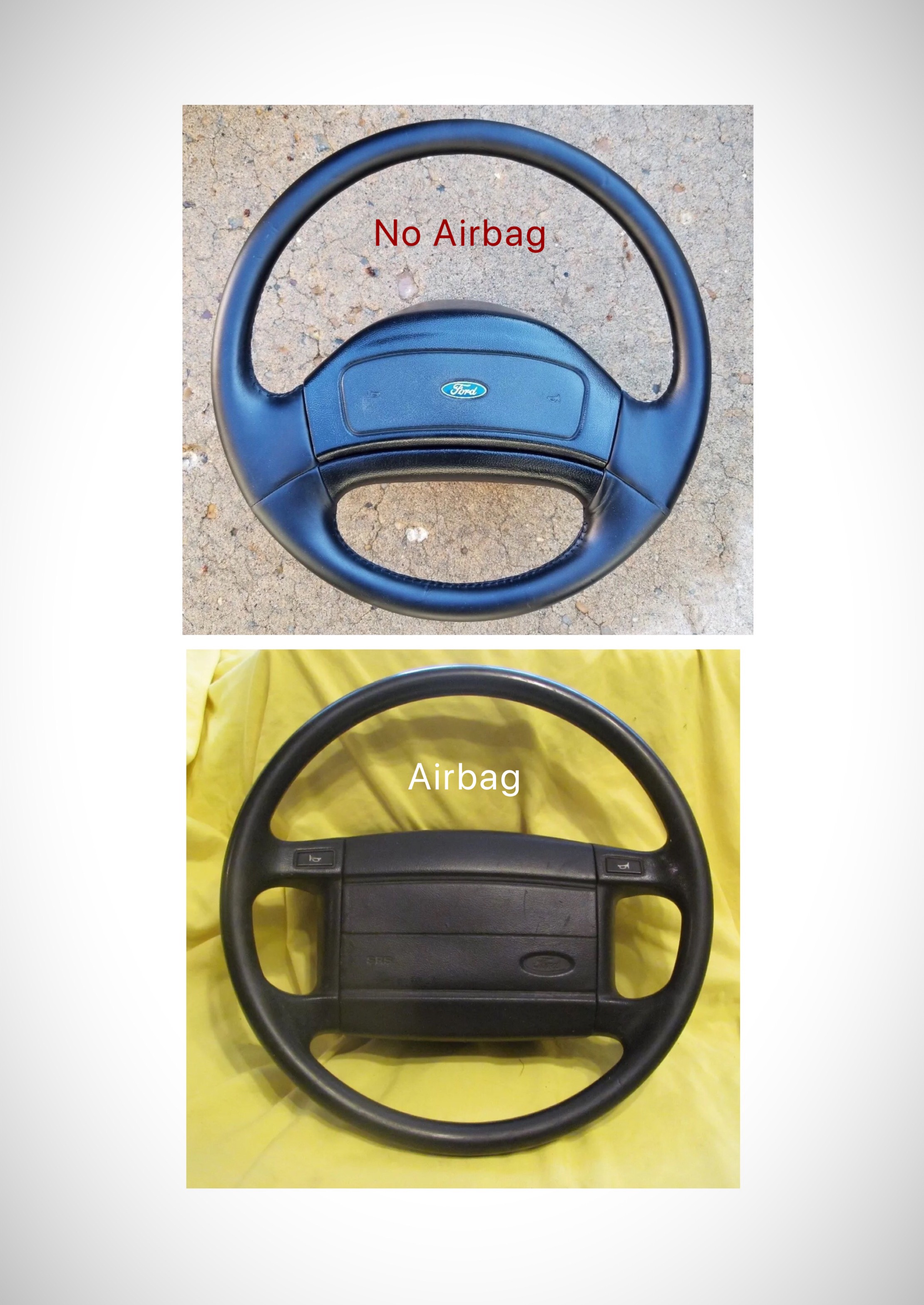

Re: Safety Air Bags
It's really easy to tell the difference. Here's the two types of 1992-96 steering wheels used by Econoline vans and F150 trucks.
As noted above, the cutaway E350 never got the above airbag version, because it didn't get airbags until the next model revision in 1997 with a totally different wheel.
Still, it's not unknown for someone to install the rectangular wheel just for looks, with an airbag that's not hooked up. That's why I asked for your VIN, in case someone had done that on yours.
Kev
