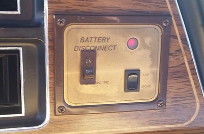

PS. You might also have another dash switch which connects house and starter batteries in case the starter battery needs a boost. On some models this allows the alternator to charge the house batteries as well. Later this was all automatic and the start boost switch became momentary, but Chinook's designs were less sophisticated back then.
Does your switch set look anything like this 1991 version?
1991 dash switch
1991 dash switch

Manual says there's a battery switch is by the driver's seat (I know some were). Is yours?
It also claims the converter will run the 12V lights no matter if the battery switch is on or not. But we already know that's not true. Unless you have both a house switch and a battery switch??
Do you have a second battery under the hood?

Yet my 94 Concourse and that of others, does not have the floor battery switch. Instead, we have a lower dash mounted switch to the left of the steering wheel.
