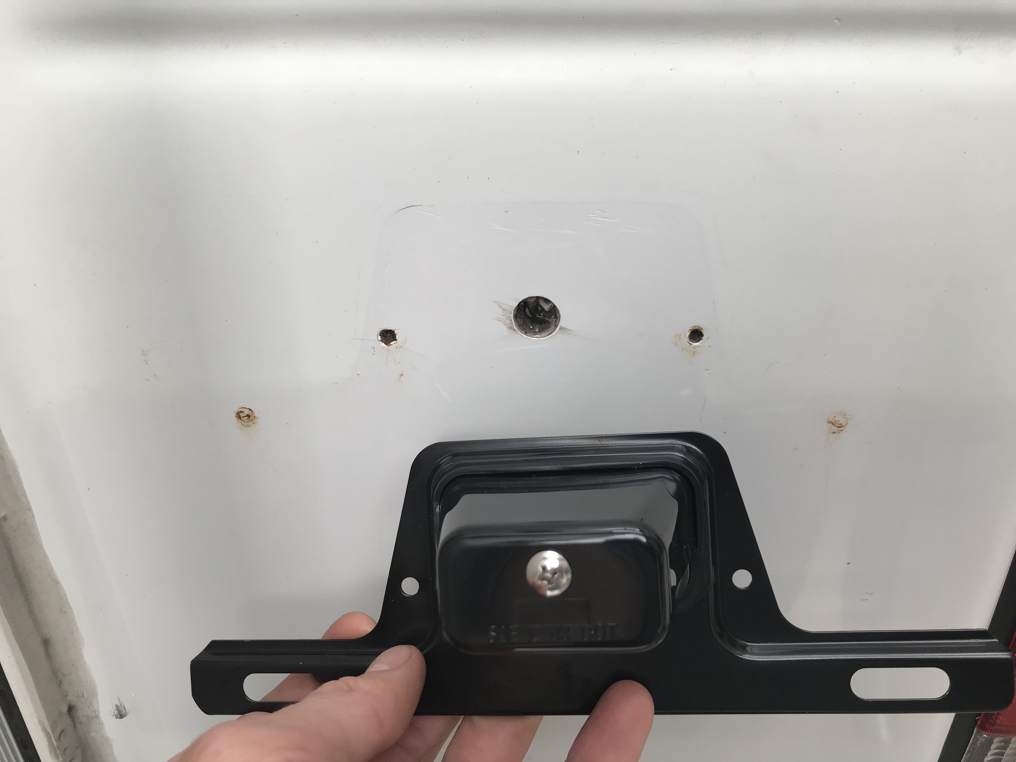

Just installed this to replace my broken/rusted license plate holder. I think mine is factory, but it looks like it may have been replaced before. Probably not the safest spot for it with the ladder right there...
"ONLINE LED STORE LED Trailer License Plate Lights w/Bracket "
https://www.amazon.com/gp/product/B0793 ... UTF8&psc=1
$9.99 and the quality is good. It has the exact same mounting hole locations and overall size.
Used a plastic razor blade & soapy water to get most of the funk off. The remaining caulk/goop came off with mineral spirits.
Only problem is the bolts are too long, so I had to bend the ends of the plate bracket out, and then bend back parallel with the fiberglass. So this is sort of the view looking down: _/¯¯¯¯¯¯\_ Quick fix that was better than cutting stainless machine screws...
And I used butyl tape.

Changing out the license plate with my new one. The PO had screwed his plate INTO the fiberglass! since as you say, the bolts are too long. He used long drywall screws. Anyway, so now I have a nice new frame and plate, securely attached to the holder, and yep, the bolts are too long. I will try to bend the holder like you did. I hope it's not so old that it will break, but if it does, at least now I know where to get a replacement.

I think I’m going to have to use shorter bolts or cut the ones I have. If I bend the plate holder like in the d ample above, it will make the holes move in narrower and won’t line up with the holes in the plate. Time to get out my cutter.
Re: Replacement Rear License Plate Holder w/ LED Light
When I replaced mine, the included bolts were about 1/16" too long. I just put a fat washer under each head.Astrodokk wrote: January 3rd, 2019, 10:54 pm I think I’m going to have to use shorter bolts or cut the ones I have. If I bend the plate holder like in the d ample above, it will make the holes move in narrower and won’t line up with the holes in the plate. Time to get out my cutter.

Mine were about half an inch too long, so I went to auto store and bought a kit that had several bolts in there. I was able to use the shortest ones so it’s all good now, but the light doesn’t work.
