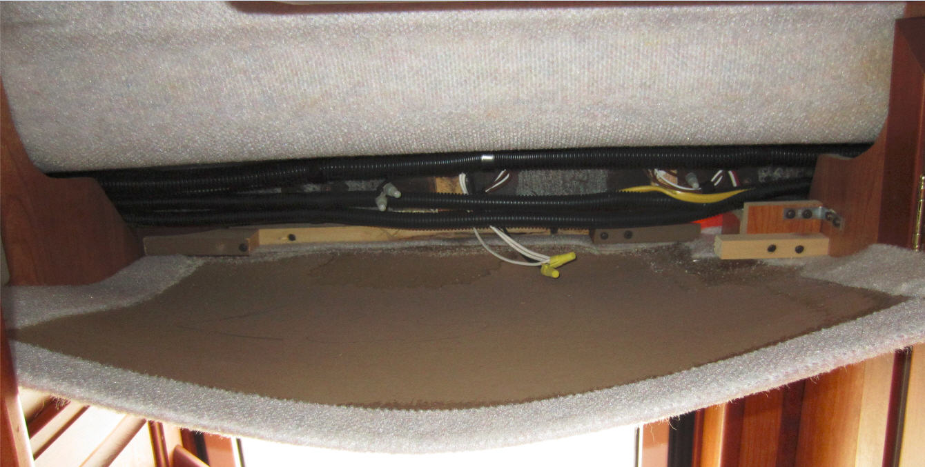

The curved header carpeted trim above the rear door can be dropped down to peak behind by removing the screws from the wood trim strip at the top. Behind it are 3+ armored wiring harnesses and some view of the clearance light wires. Not much space in there. Looking at a picture I took I don't think I see the camera wire. It might be just beyond that area behind the bathroom wall.

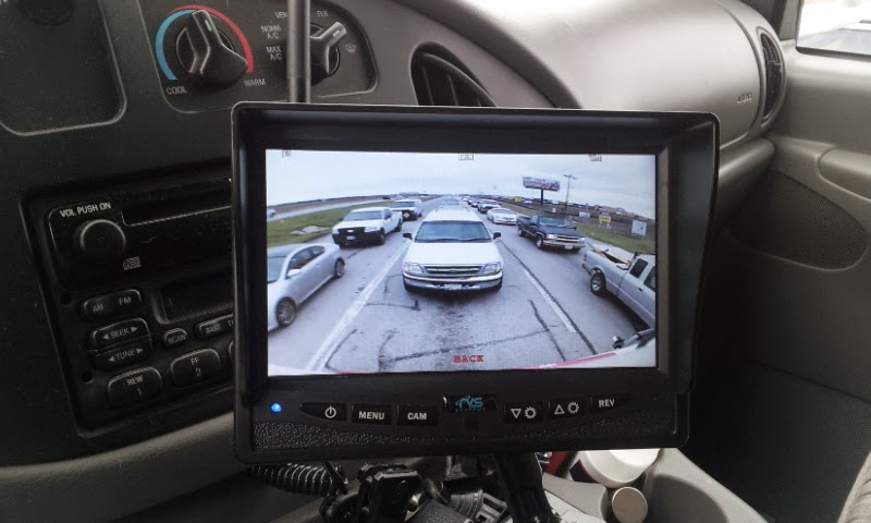

The system I used is this one http://www.rearviewsafety.com/products/ ... rette.html
Without audio and gridline option the current price is $299.95
It does have a 7" monitor (not 9" as commented above)
I chose it based on guarantee of no interference in a wireless system, reviews, ease of installation, ability to quickly remove monitor if needed, wide angle lens, infra red for night use, everyday driving not just for backing up.
So far it has worked out very well.
More at http://chinookers.blogspot.com/2015/02/ ... amera.html

I like the 7" monitor - I don't like peering at tiny screens - maybe that's a function of now being of a certain age!

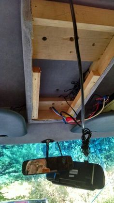

Receiver - I wired it and the display into the overhead console on my 1994, with a switch tapped into the overhead map light power. I drilled a hole in the right front of the console so the wire could go behind the headliner down to the display.
Overhead console
Overhead console

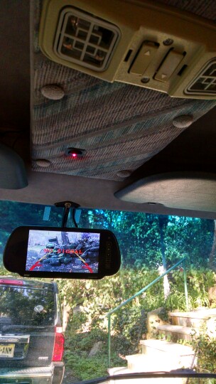

Display - I'm really proud of this. The Pyle has spring-loaded rubber tabs that let it mount over a regular rearview mirror. However, its heavy weight kept pulling down the Ford window glued stock mirror.
So I thought about it, then found a $14 black 1948 Willys new stock mirror that I simply screwed into the ceiling! It's small enough that the Pyle completely covers it. Perfect.
Display
Display
Since the Pyle has two video inputs, I've bought a second camera that I'm going to mount above the rear door, power off the running lights, and run a video cable along the ceiling to the front console... that way, I can leave it on all the time while driving.
