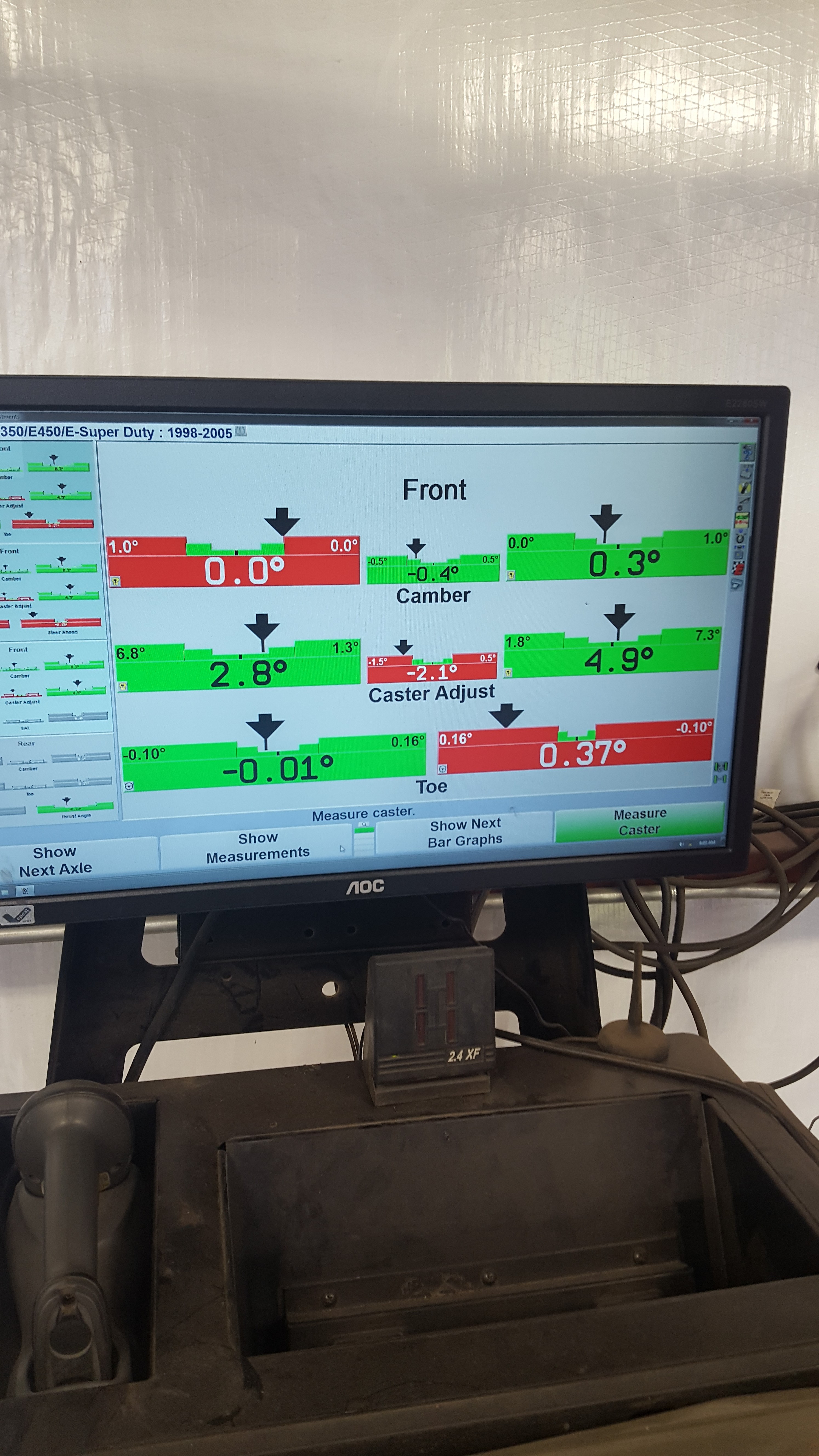

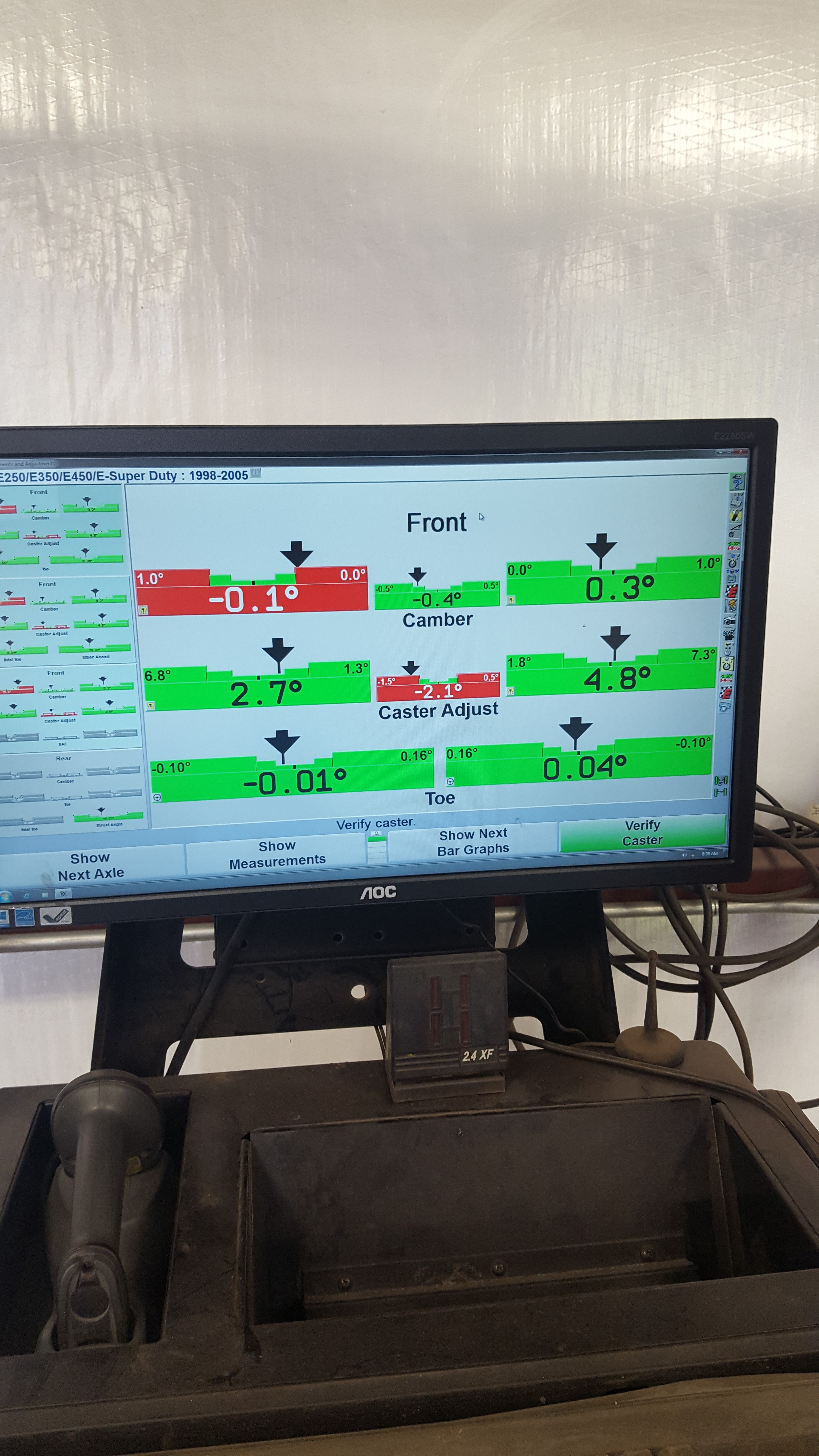

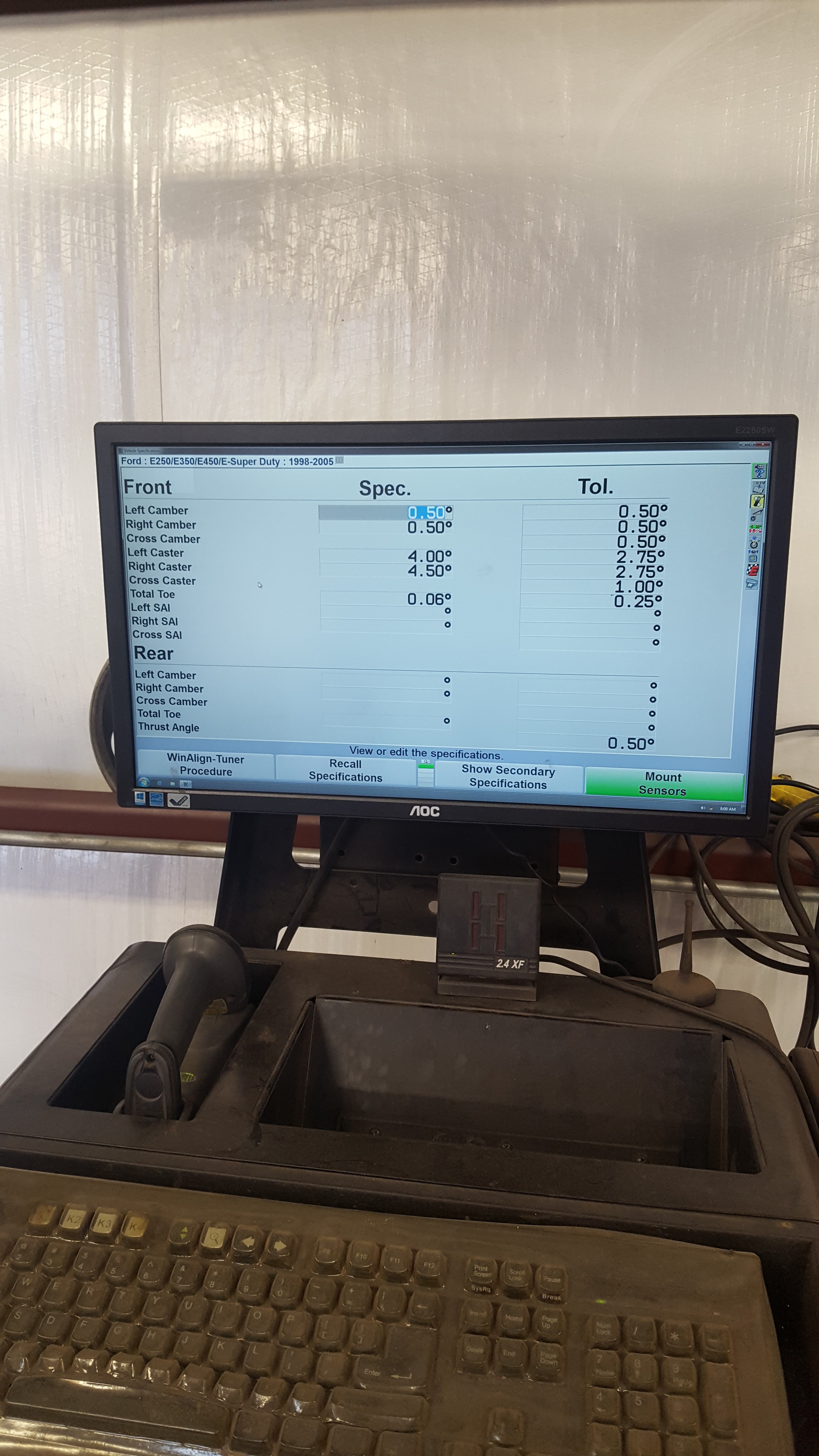

Well, I just got back from the front end alignment and basically...they did nothing. It still pulls to the left although I did rotate the two front
tires back the way they were originally and it is a little better. Only adjustment they did was toe and that wasn't much. At least I did get to get under it and we inspected everything very well. Even wheel bearings and brakes so was glad to get that done. I am attempting to post before and after photos of the alignment readings. Maybe someone can tell what we're doing wrong. Picture #108 is oem spec sheet,...#109 was before adjustments,...#112 is after their final adjustment. Hope you can read it.
Flame
Posts: 409
Re: 1998 concourse front end alignment specs
Post by Flame »
Well, top picture is after completion and middle is before they started. Bottom is oem specs.
