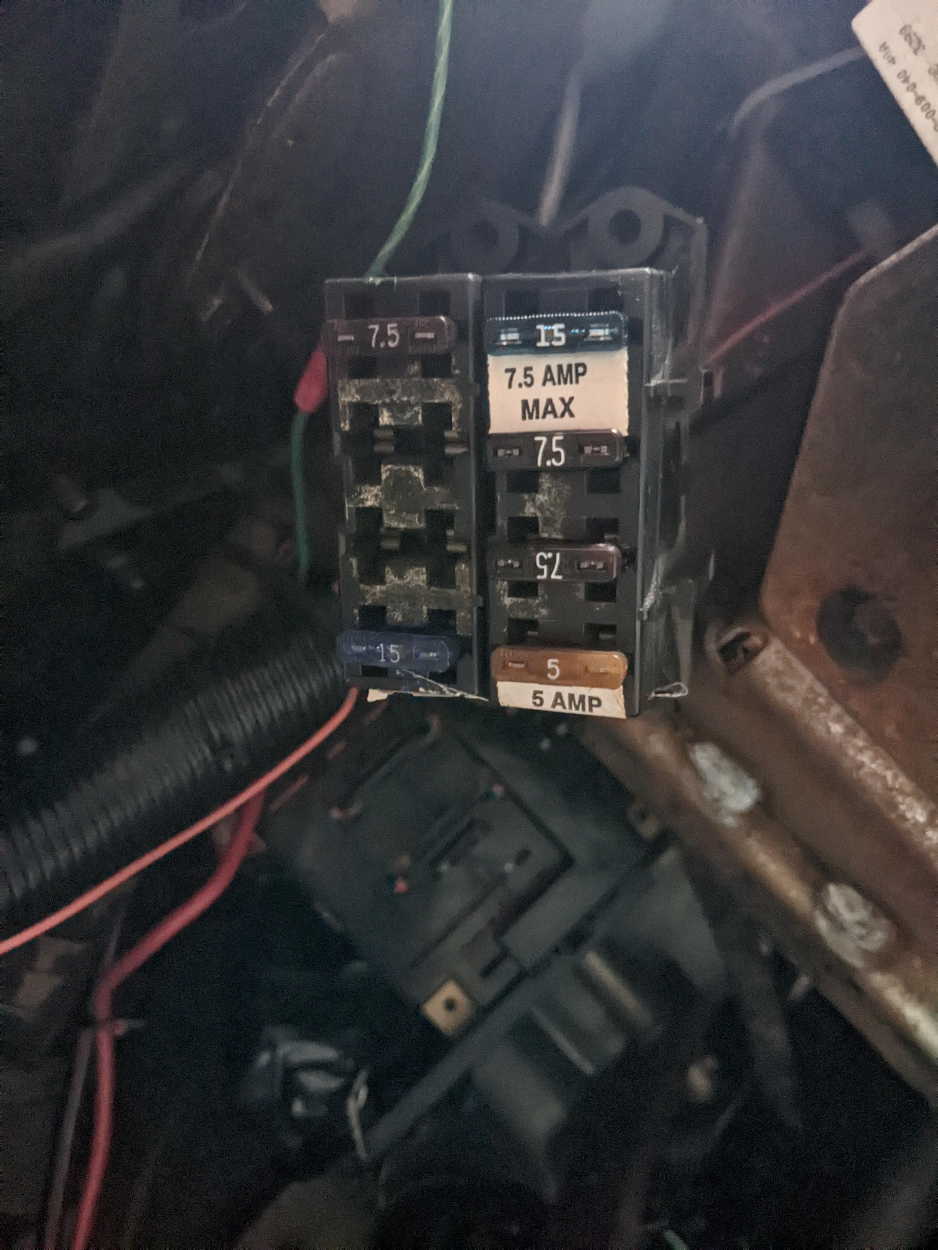

I've attached pictures for your reference, but from what I have learned it seems like the first item to check is the fuse box (image attached). I checked the top left 7.5A fuse and other than the fuse box being held in place by duck tape (which I've removed) the fuse seems fine (I replaced it with a new 7.5A fuse just to be safe).

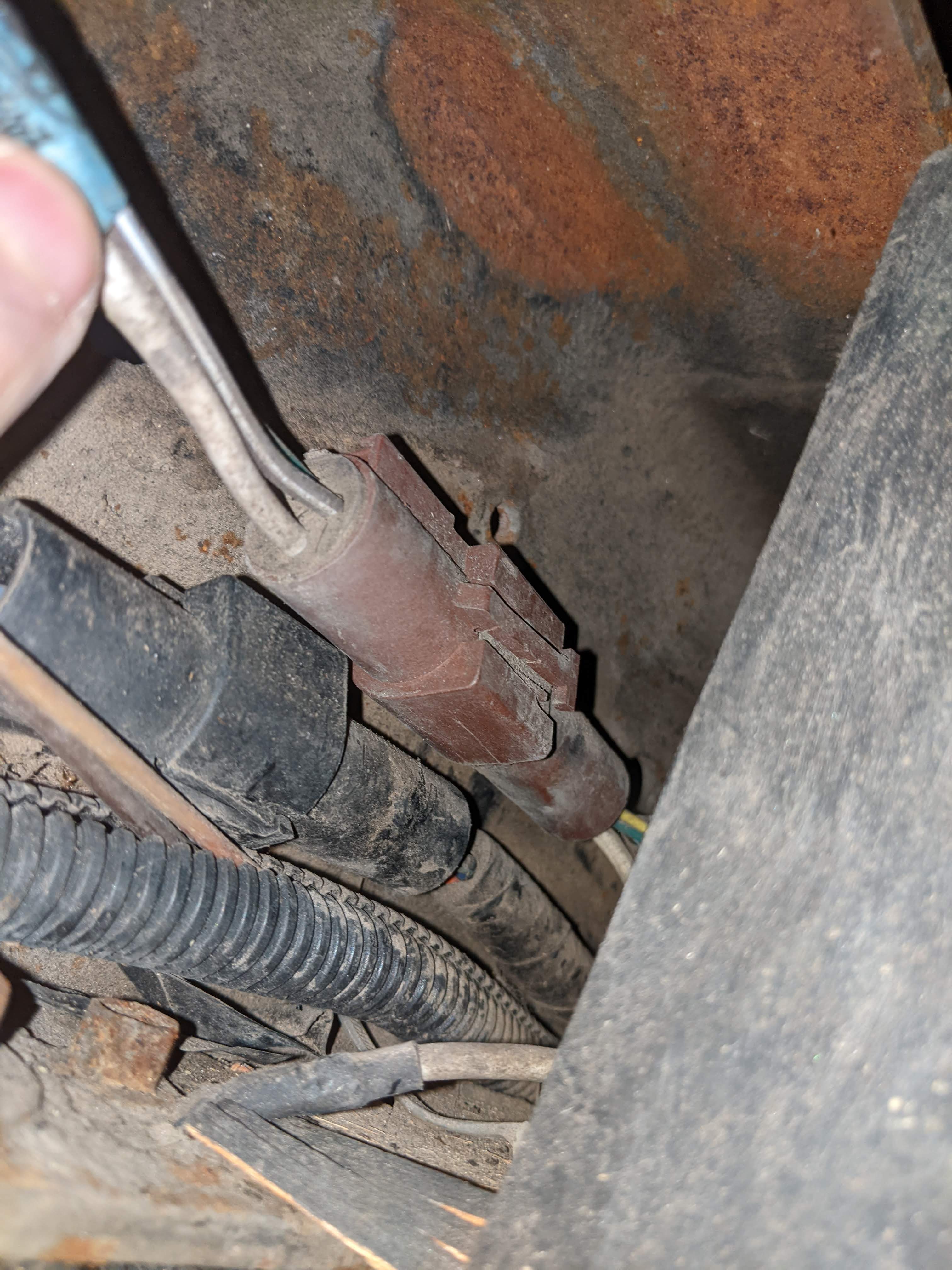

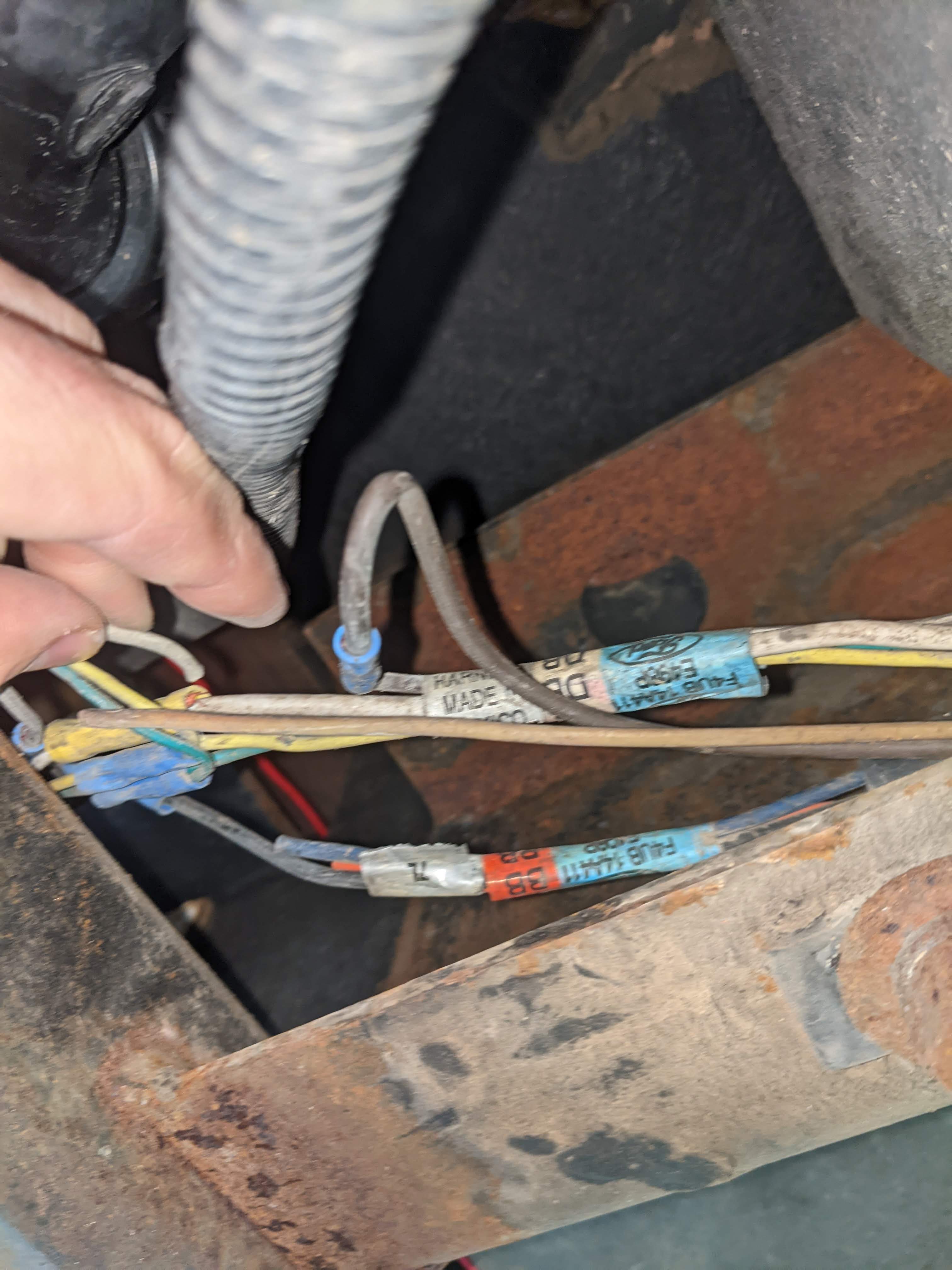

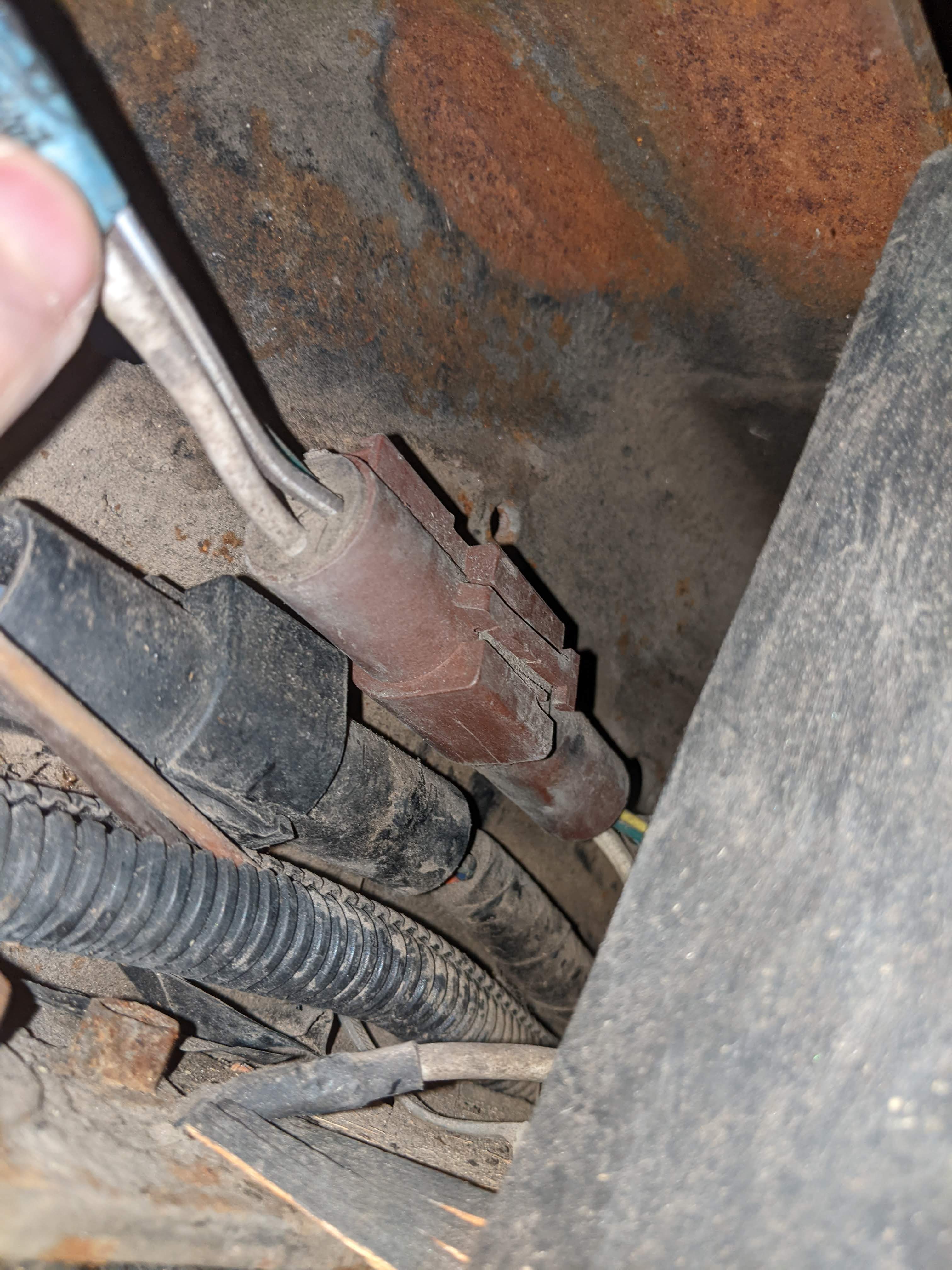

I then made my way under the rear of the vehicle where the brown connector is located (I believe in this forum you reference this as a "schnozzle"). I learned that this connector is where the wires that power the tail lights and marker lights is located. I'm not certain which colored wire powers the tail lights and the marker lights, but I took a couple of pictures for your reference. When I was moving the wires around, the white wire broke off at the crimp connection while conducting the inspection. This might have been the issue all along or I might have disconnected power to something else entirely. I'm not really sure what to do next.
Should I remove the crimp connection for the white wire all together and just solder everything back with a heat shrink tube cover? Does this white wire even power the tail lights and/or marker lights? Any help would be greatly appreciated.
Disconnected white wire
Brown connector
Brown connector

The white wire is ground, so it the connection is good, you should be able to use a volt meter on DC mode, and see no voltage potential, and when you measure the resistance, it should be zero to the chassis. Nothing will work if the ground is not working.
The wire at the brown connector is the right place to trouble shoot. The marker wire does not go from there up, but instead, go all the way to the front on a small wire, thru the fuse box near the left leg of the driver, then came all the way back again before going to the marker lights. Test the connect at the brown connector and confirm that all the wires are working as expected. You should have the marker, left and right turn, and backup working there.

Prior to breaking the white wire (ground) connection, both turn signals and brake lights work (yellow and green wires). My tail lights and marker lights do not work, which are connected to the brown wire coming from the brown connector. As you indicated, the brown wire looks like it goes back to the front of the vehicle.
I have a volt meter, but I'm not sure how to test for voltage potential or resistance on this wire. For voltage potential, do I disconnect the brown connector and connect one probe to the pin connector and the other probe to ground (i.e. the chassis)? Do I do the same for measuring the resistance?

I do think the first step is to repair the broken white wire. If there is enough slack on the wires, you can just cut the "butt" connector off, and redo the connection. If there is not enough slack, you will need to remove the old connector and preserve as much of the wire as possible so that you can redo the connection without making the wire too short.

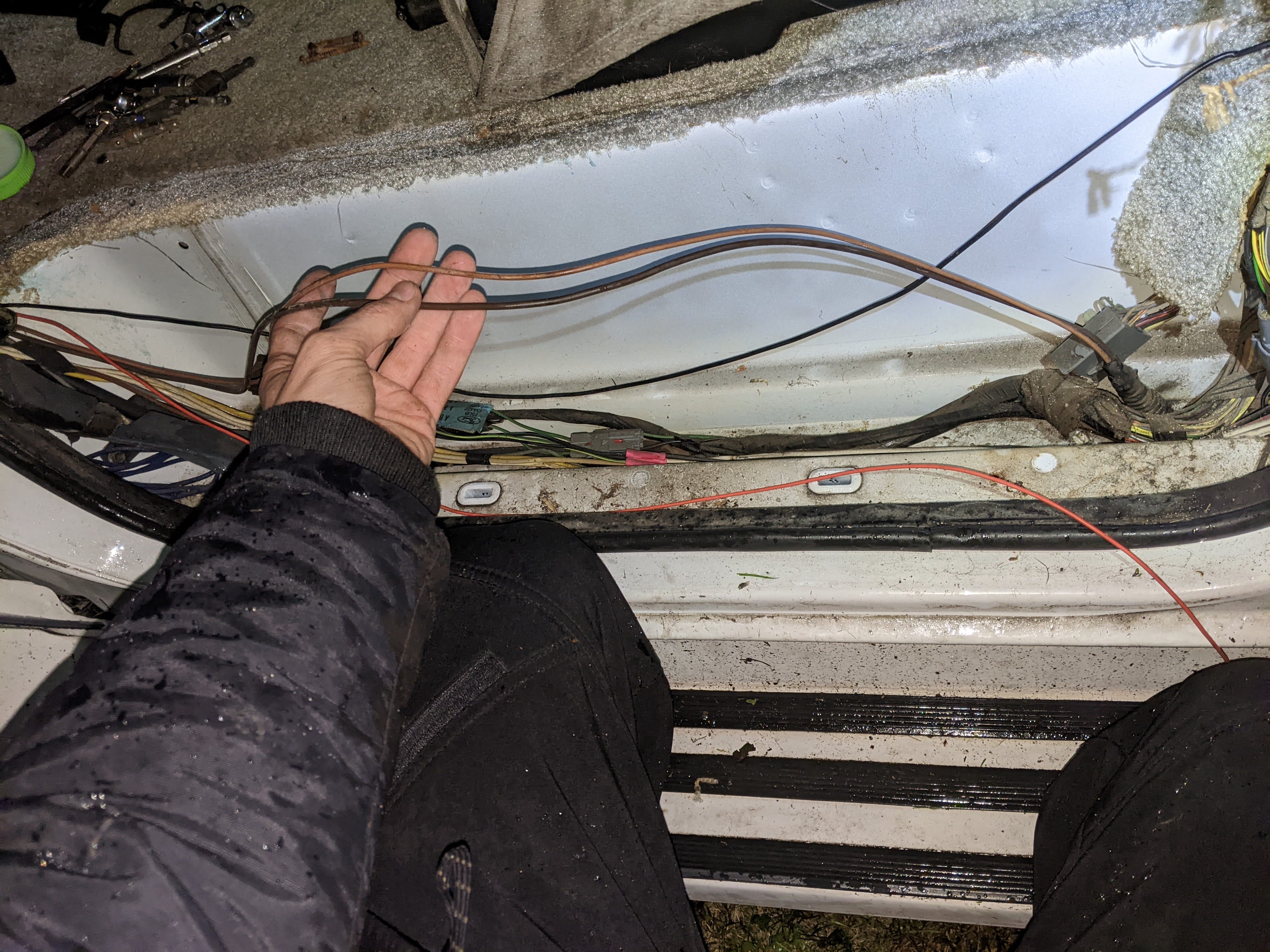

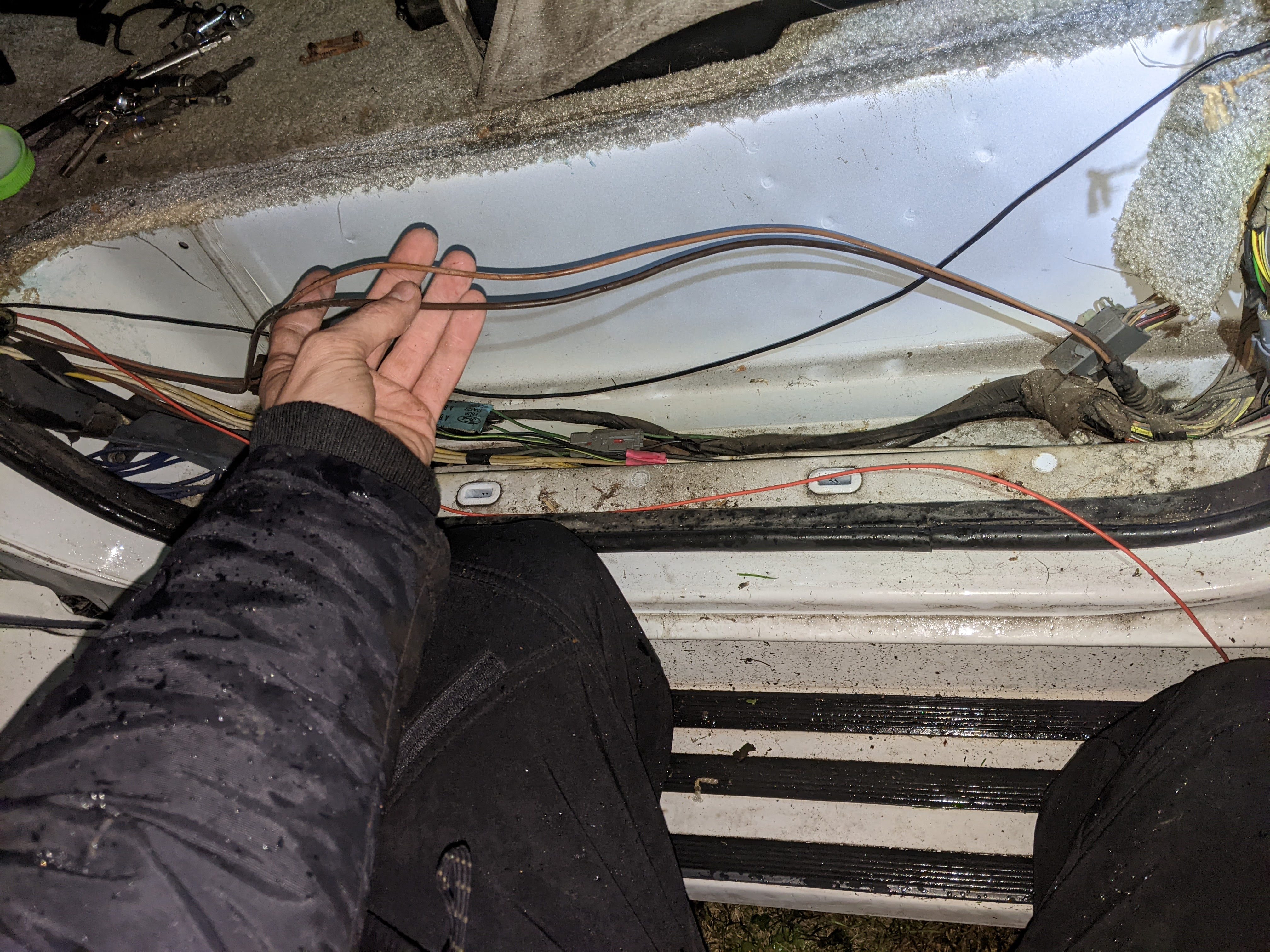

I got under the van last night (while it was raining :( ) and reconnected the loose white wires. I stripped all three white wires at the crimp and temporarily tied them together with a wire nut (for now). I then followed the dark and light brown wires from the brown connector in the rear of the van to the front of the van, removed the black plastic foot step cover on the drivers side, and to the chinook fuse box. I didn't see any damage or loose wires throughout this path.
I was unable to use the voltmeter at the brown connector to see if I'm getting 12 volts relative to ground; there wasn't any exposed wiring. I did test to see if I was getting 12 volts at the chinook fuse box and noticed that when I placed a lead on the 7.5A fuse and another lead on the chassis, I did not get 12 volts, but when I did this with the other fuses, I did get 12 volts. I'm not sure what this means, but my assumption is that something is wrong.

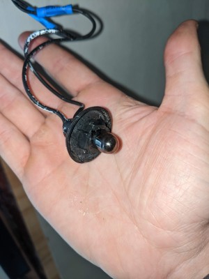

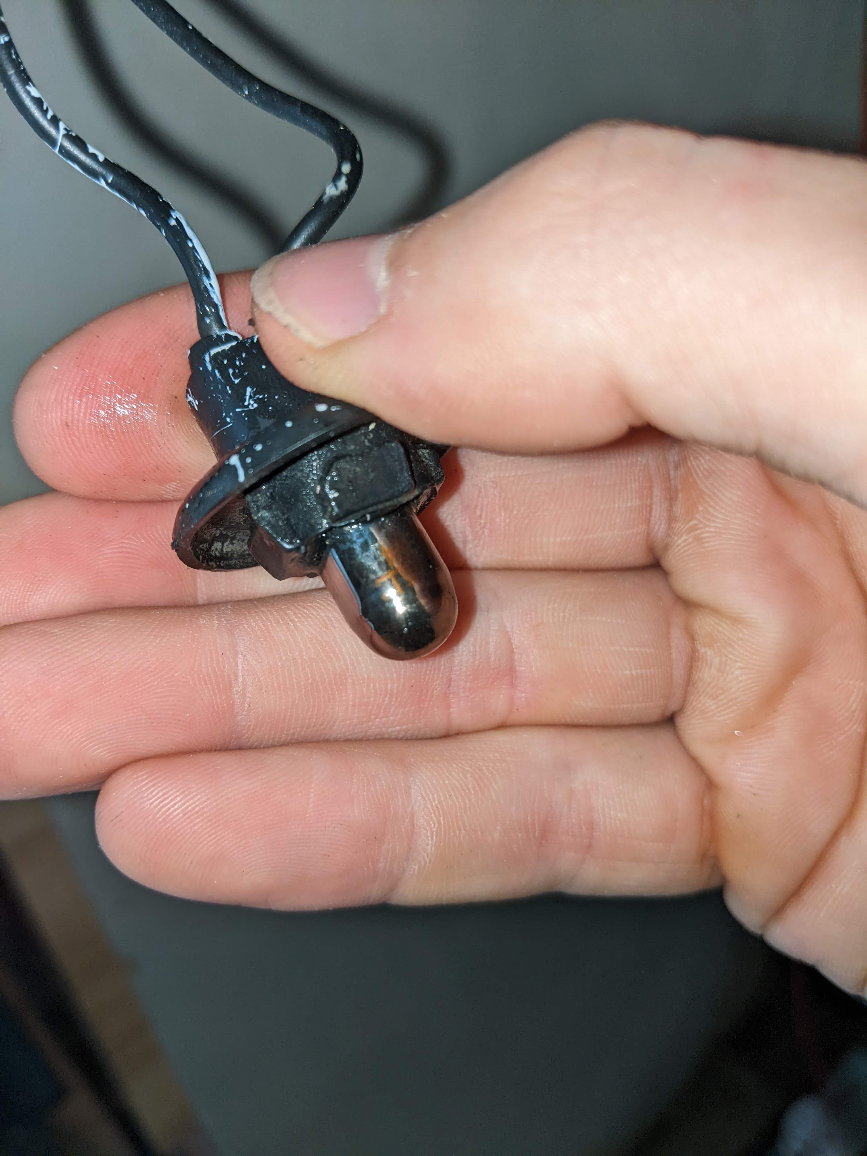

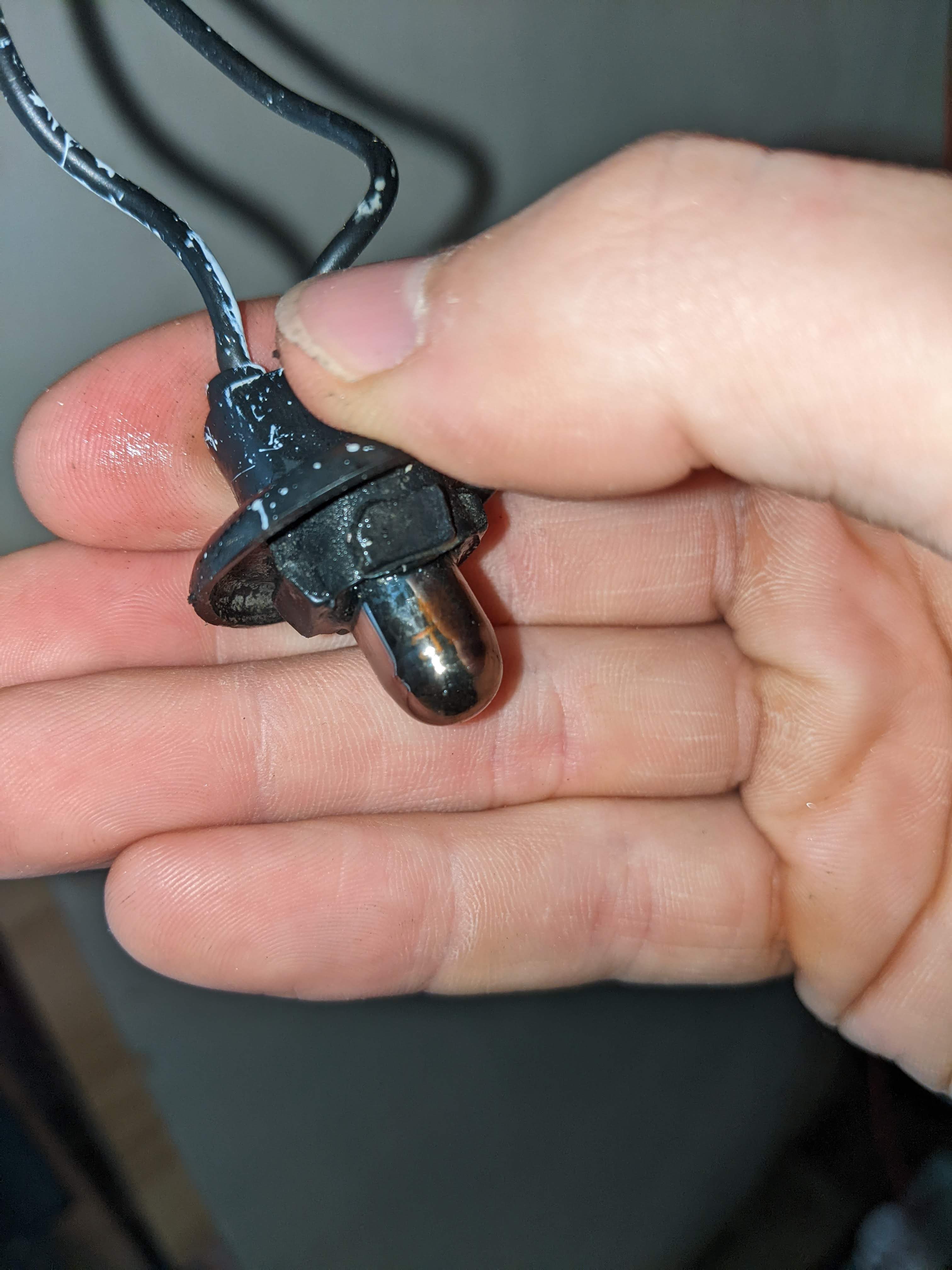

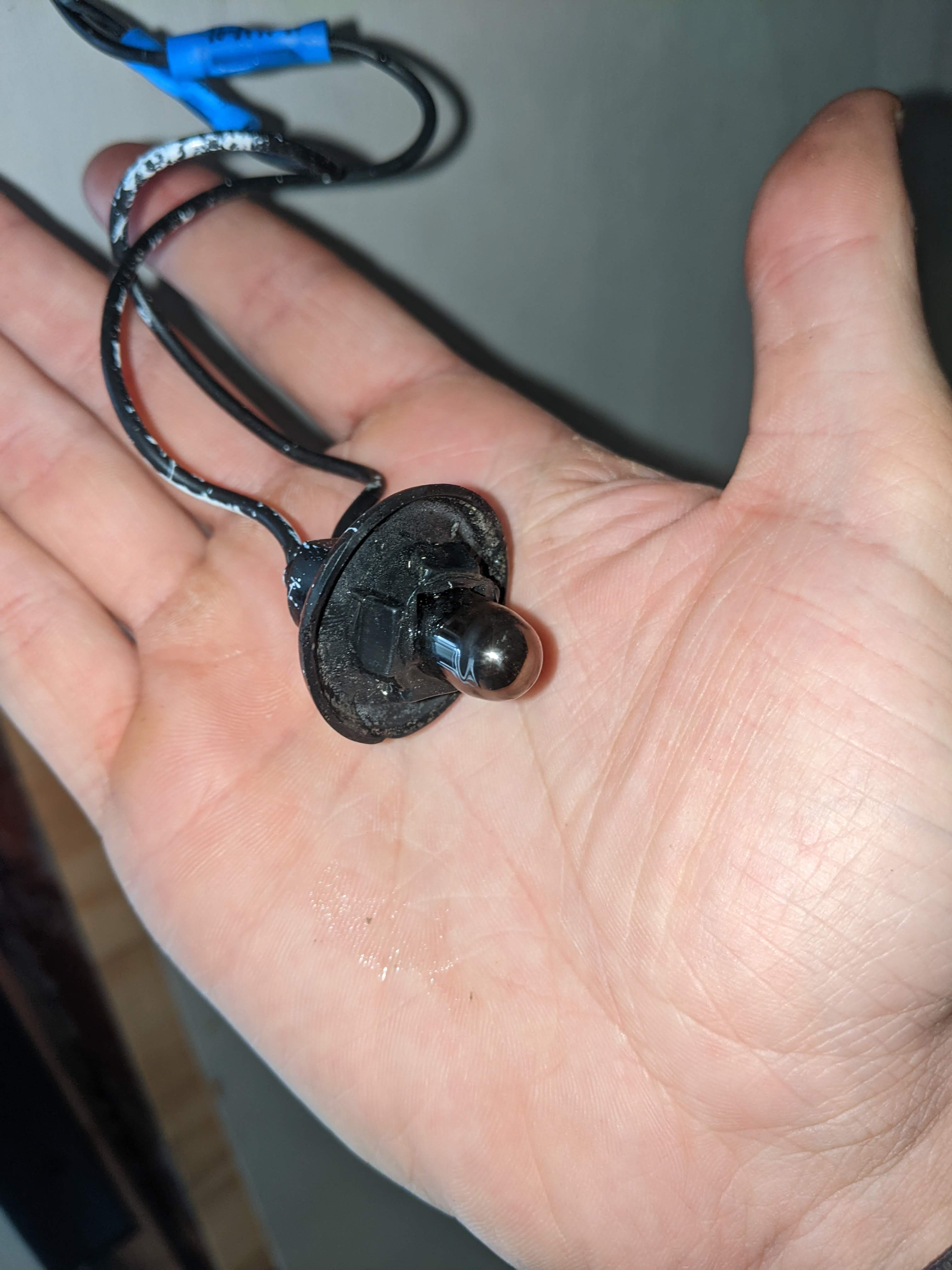

This morning I did some more investigating. I pulled some of the marker lights from their housings and found some water in the marker housing itself. I pulled some of the bulbs from their connectors and the connections seemed a little corroded and one bulb looked burnt (photo attached).
If one of these bulbs is burnt, would that prevent the rest of the markers (and tail lights from working)? Wouldn't a burnt bulb cut the circuit?

The burnt bulb meant that the light was working at one point. They are wired to the power in parallel, so one damage/missing bulb does not prevent any other from lighting up. Make sure there is at least one good bulb among the marker lights.

I used a 12V power supply to test the four rear marker bulbs and all of the work but one. The picture I showed earlier is of the burnt one, but as you mentioned, since it is all wired in parallel, the rest of the marker lights should still work.
